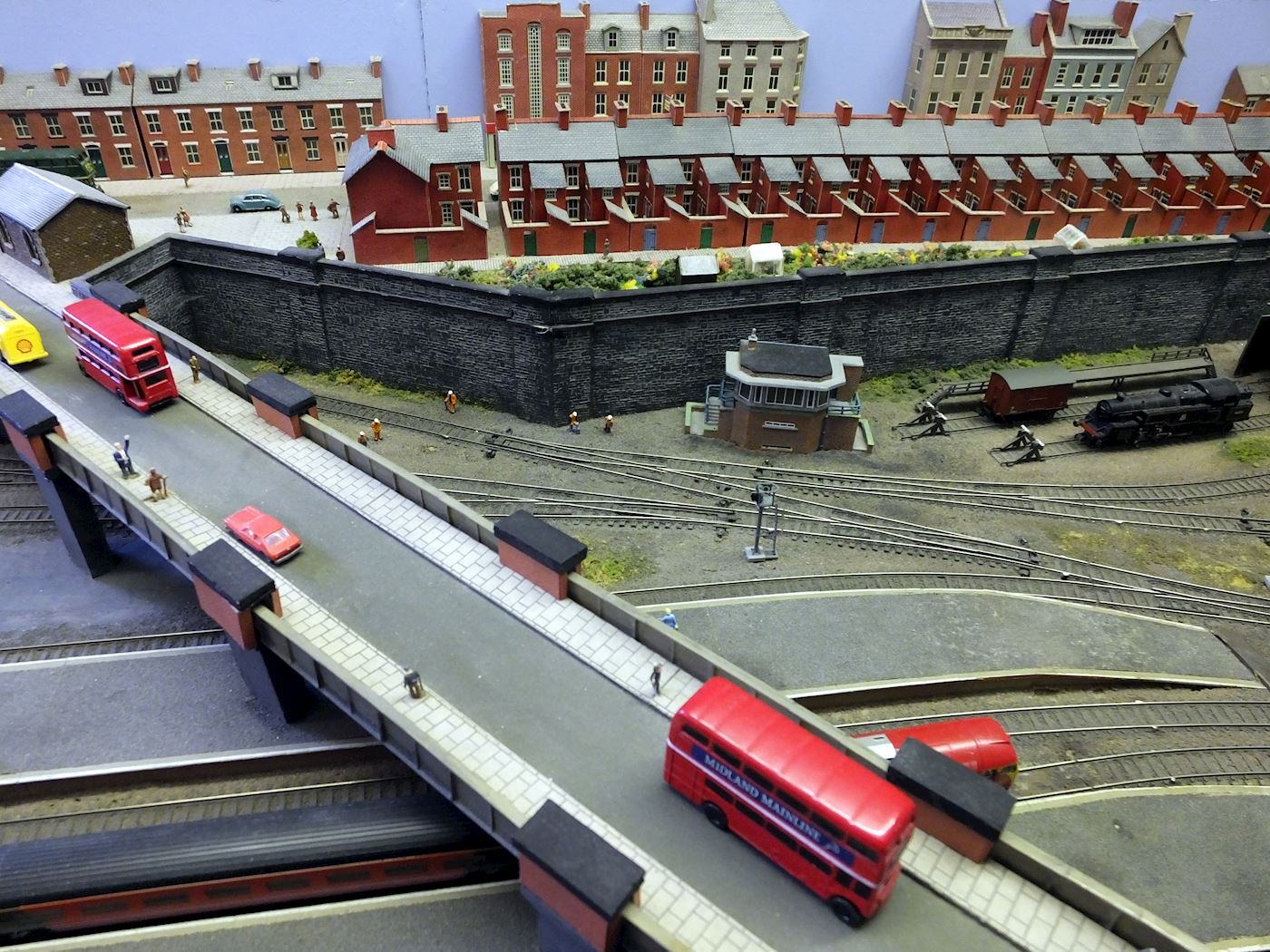

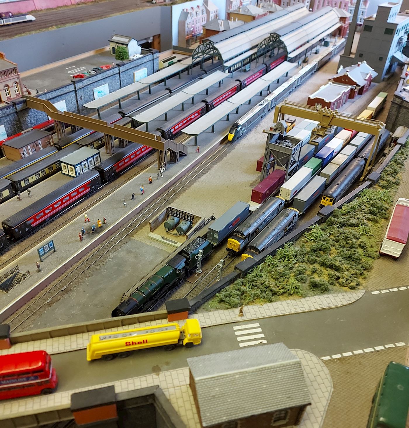

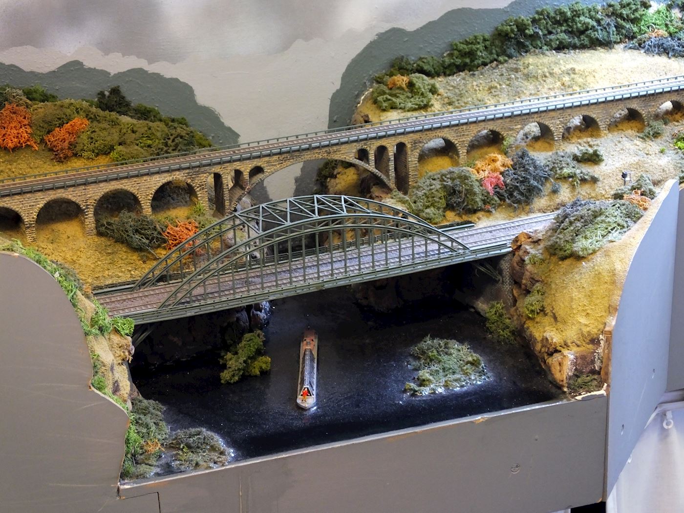

Here are some photos as requested.
thanks 7 users liked this useful post by John Ferguson

Somehow I overlooked the post with photos! Great stuff, beautiful landscaping and bridge work and quite an involved set up. Can you tell us a bit about how what elements of your layout might be automated as in using feedback modules?
Thank you for posting this for us FB exiles!
