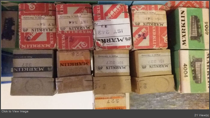

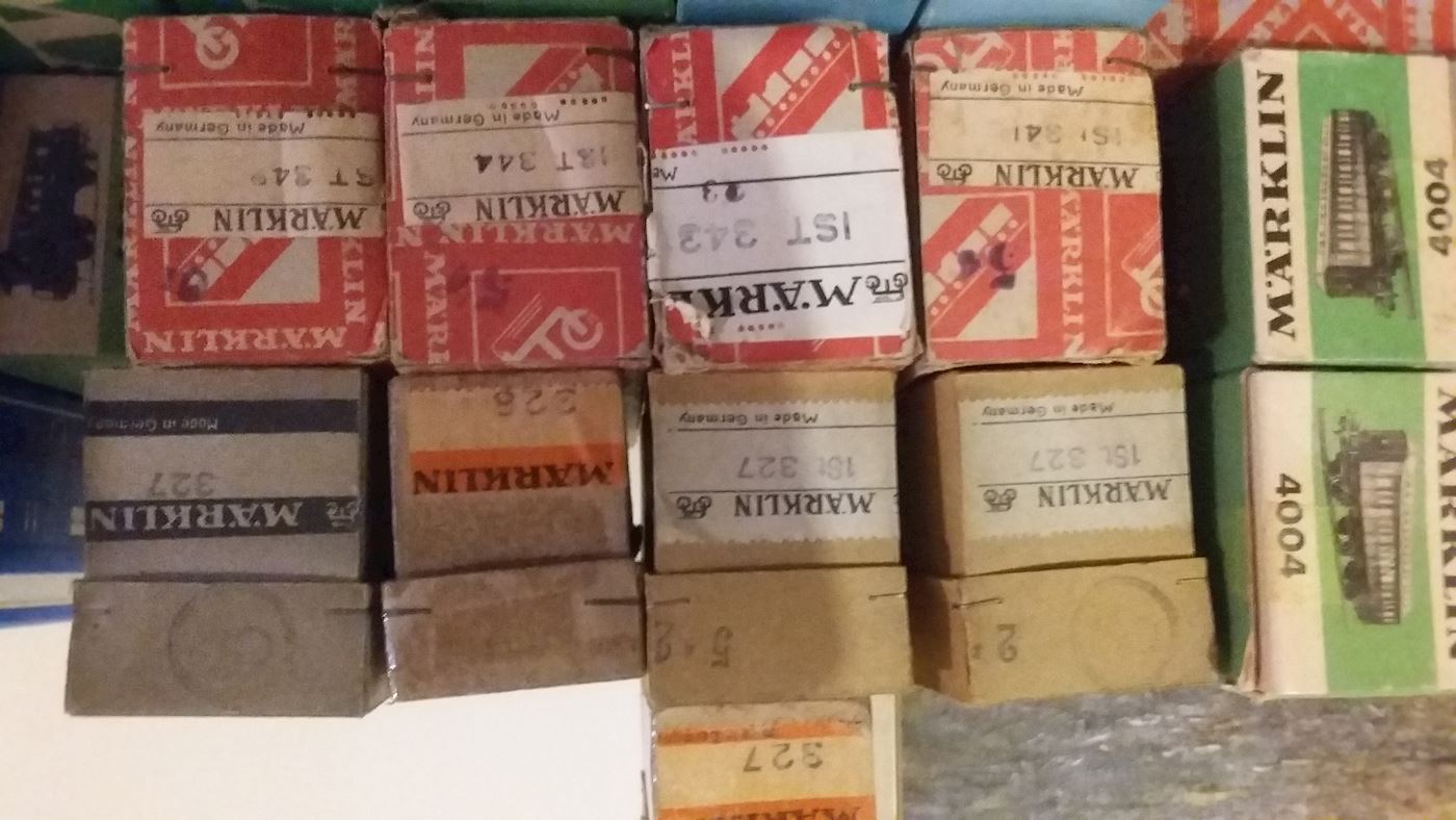

20200130_130827.jpgHere are some pictures of what I believe are late 40's to early 50's boxes for passenger wagons.

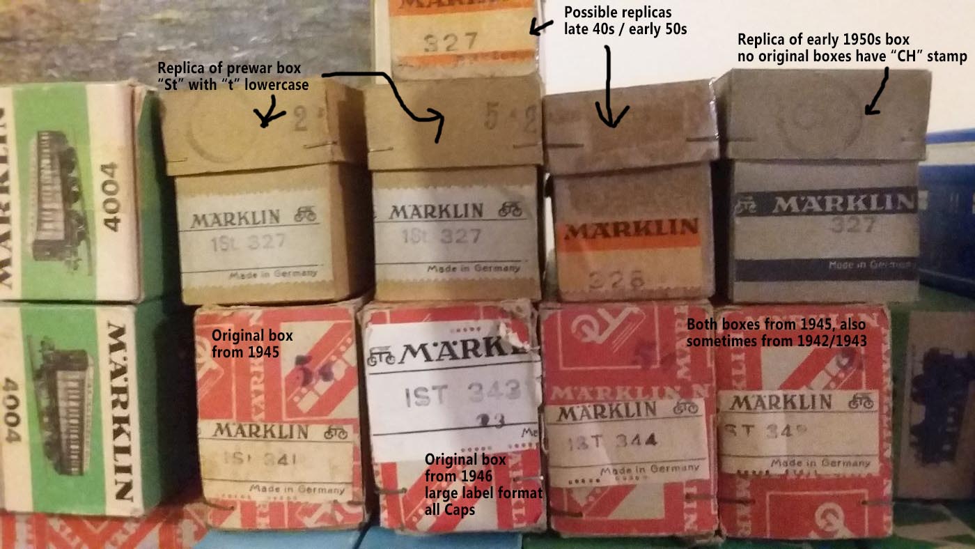

Hi Mike,
Here's some of my analysis on the photo of the boxes.
Paul
