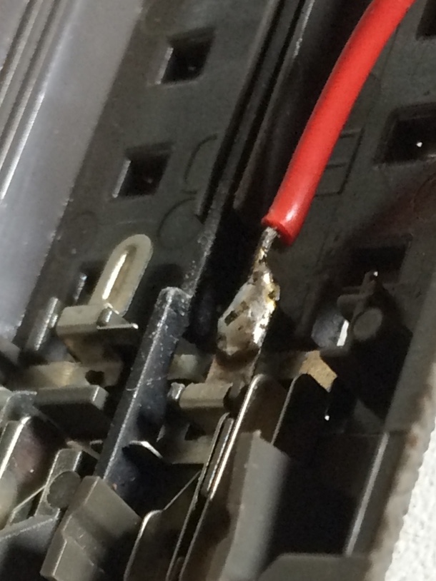

I tried following the advice to solder wires to C-track, but the shiny spade connectors do not take to solder well. It just rolls off... Is there a trick?

12m2 layout to be controlled by RocRail

Hi there I use a flux pen - I got mine from Amazon (no surprise there!) https://amzn.to/2wOyb4v
Makes soldering much easier.

I think the use of flux here is a requirement; either paste or oil. Oil is probably a bit less messy; and be sure to clean off any excess flux afterward as it is corrosive. Of course a hot iron as well, so that the time to get the solder to melt is very short and thus no chance of melting the track body in the process.

It’s normally very easy to solder on the spades.
Make sure you first apply heat to the spades for 1-2 sec, then come in with your solder.
Apply a small tap of solder to the spade. Apply separately some solder to the wire. Then bring them together.
If it doesn’t work could be the solder iron not hot enough (or the tip is too large) or you are using a wrong solder?
I don’t normally use flux pen for these spades.

I'm not sure if you're soldering directly on the taps on the tracks, or on the spade connectors ( 74995 ).
The connectors should be easy, even though the are meant to be crimped; on the taps a bit of sanding with very fine sandpaper can help.
In both cases pre-soldering makes life much easier.
#6 Posted : 13 June 2019 06:27:04(UTC)
Cut the spade connectors off and solder the bare wires to the lugs underneath the track. Job done!

Ok, maybe my terminology was wrong, didn't know what the little buggers are called.
I'm trying to solder wires to the shiny taps/lugs whatever they're called, underneath the track.
Is the flux pen any different to normal flux?
I will try and sand them a bit and pre-solder.

I use resin core solder to solder wires to the track lugs. This solder has flux embedded in the core of the solder wire. You just need to tin the end of the wire and the lug itself with solder then solder the wire to the lug.
Some fluxes can be quite corrosive - I have a nearly full bottle of flux that my Dad had (and he has been dead for 41 years now) and it is very corrosive. I tried using it to solder some power wires to some brand new K track pieces. The track corroded severely where the flux was applied within a couple of weeks. Better to use the resin core solder, that doesn't have the corrosion issue.

As Dave says just tin both the wire and the lug then make sure your iron is hot and hold wire to the lug and place iron on top of wire and it will join.

Thanks, sanding and pre-soldering did the trick:

I guess the trick is to use regular solder for electronics (with soft soldering agent). The other part is to use a soldering iron for electronics (with regulated temperature). Then it works every time. I use a 40 years old Weller soldering iron not had ever a soldering issue on C rails. I even use it to solder SMC diodes and components.
Now they are expensive (but good for life) otherwise on the internet you may find acceptable ones for around 25€.
Here is one possibility: https://www.ebay.de/itm/Yihua-60...39dff:g:fiAAAOSw9MtcrZWJ
What you describe seems related to a too high temperature / waiting to long before soldering which make the soldering agent to burn/disappear.
