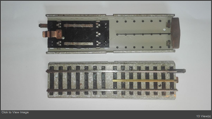

Like this:
UserPostedImagevb435 by dralowid, on Flickr
Battered but good quality.

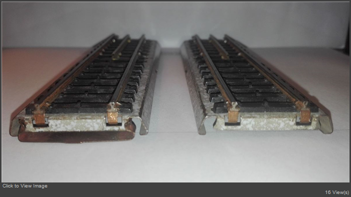

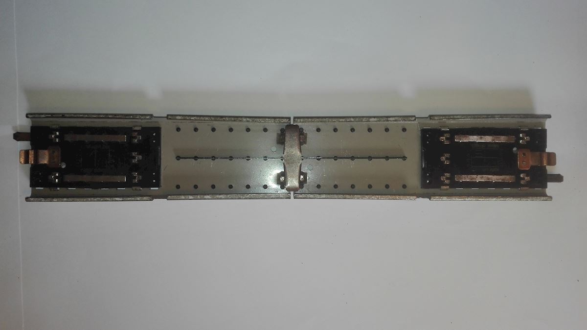

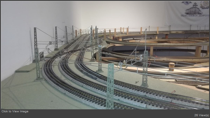

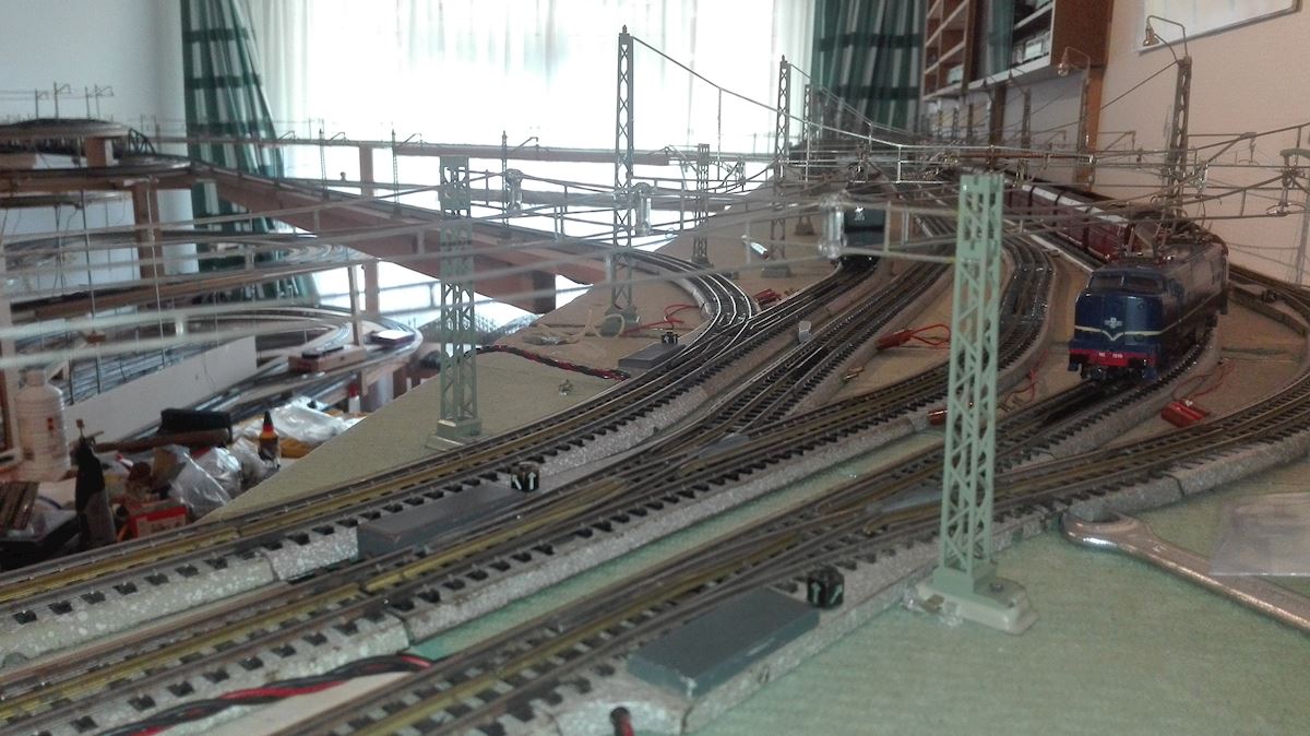

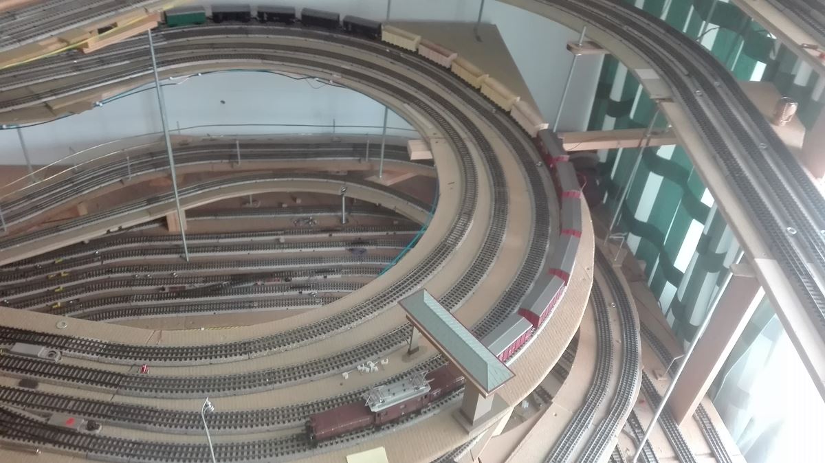

Thanks for suggesting the VB-book. Attached 2 pics just to illustrate VB's charm. Very good in combination with Marklins 3800/3900.
Kind regards,
Marc/VB3900

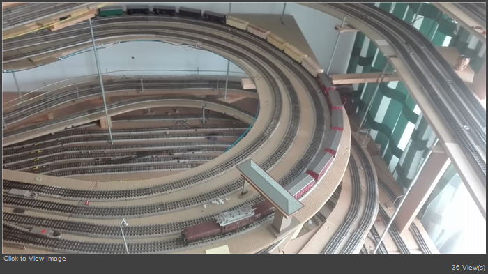

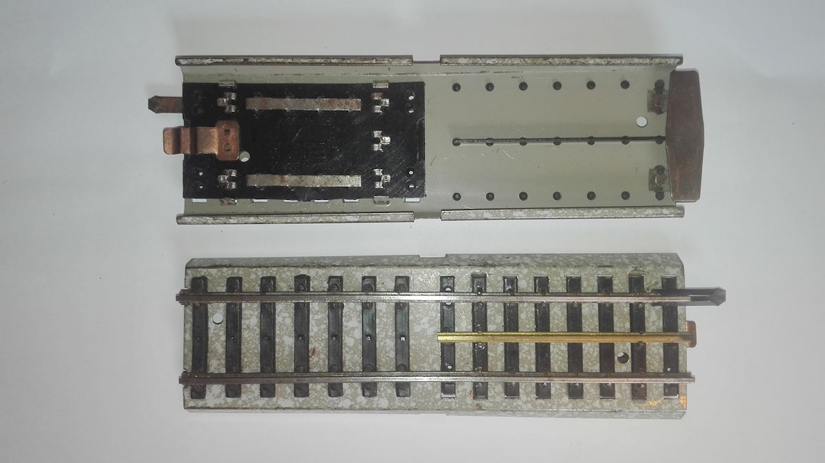

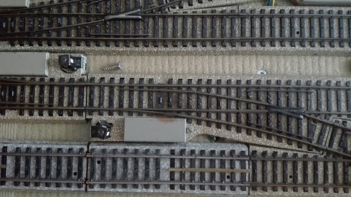

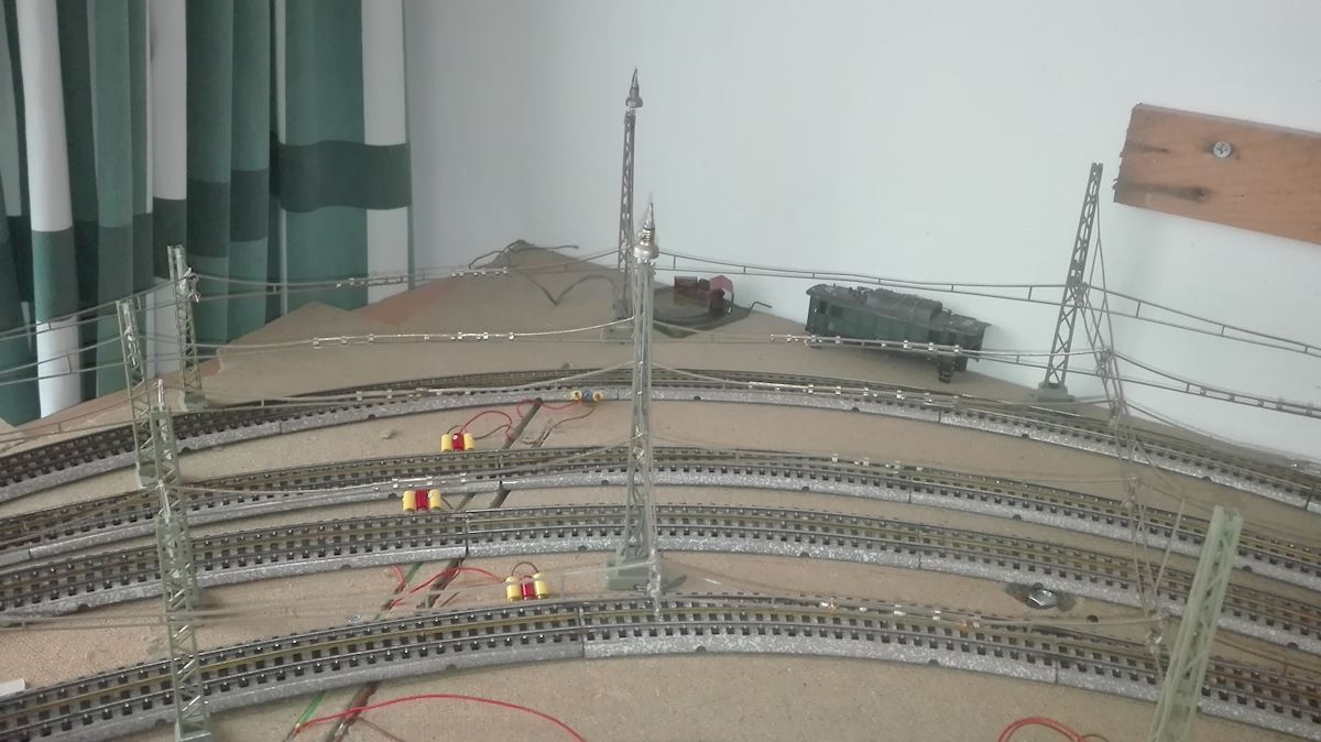

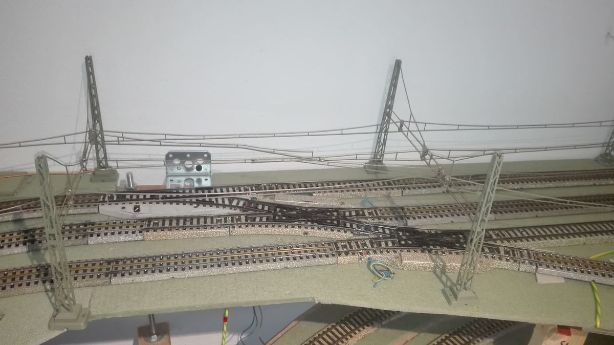

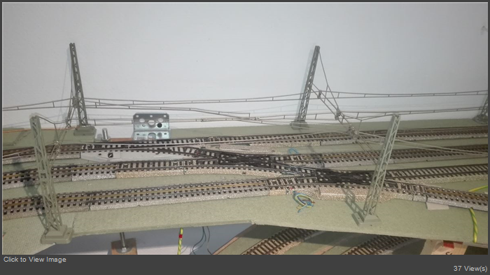

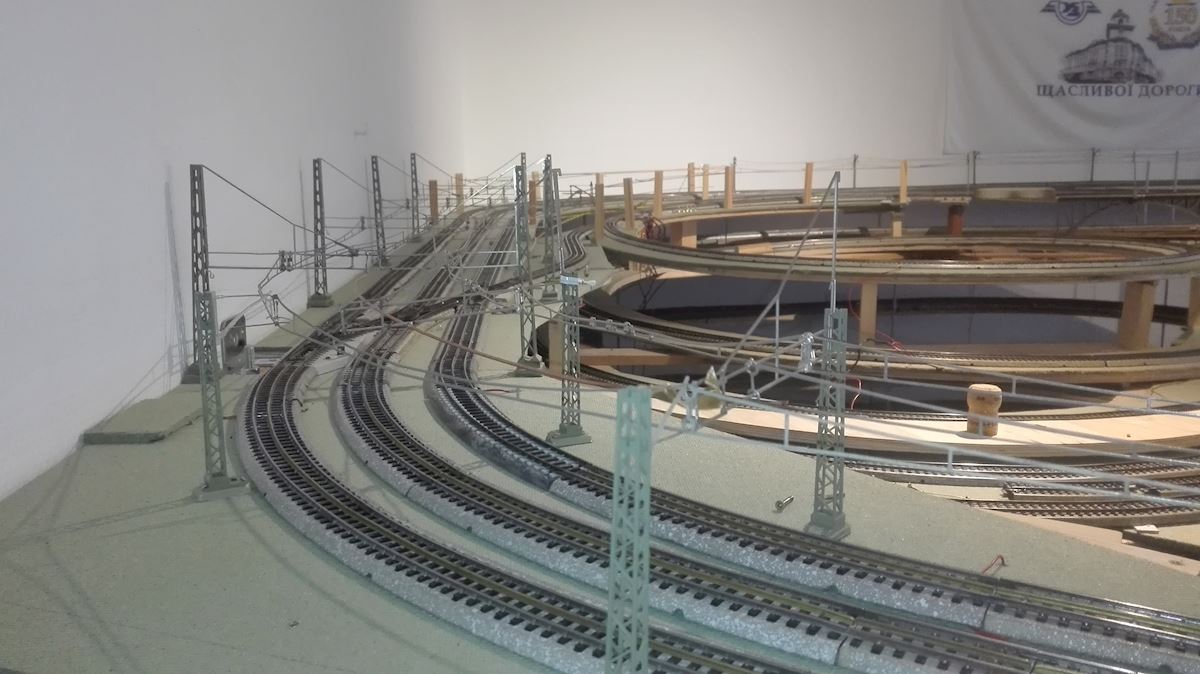

Referring to & correcting my recent post VB is not only perfect in combination with 3900-tracks but also with 5100. Because VB nor Marklin produced switching double crossings, I modified 5207's and 5202's in the direction of the geometrical measures of 'VB3900'.
Also available are (the last) VB-Puko's. Once foreseen as inner circle in my horseshoe-curve (attachment). Connected with VB-middlerail whith VB special adapting-rail (half Puko/half middle rail) there is short circuit. Seems like + turns into -/-. Help please!
Kind regards,
Marc/VB3900
thanks 9 users liked this useful post by VB3900

Hi Marc,
It depends on whether running 2 rail or 3 rail.
Outside rails in your layout must be electrically either ALL isolated (for two rail) or ALL connected (for 3 rail)!
If you have ONE rail somewhere different it may cause a problem.
Adapting rail:
Can you check with a multi-meter that outside rails are isolated from the middle rail/puko?
And then check that the outside rails are isolated from each other.
VB may have made the adapting-rail on the assumption that the outside rails are connected (which is OK for 3 rail).

IMG_20191022_124144.jpgIMG_20191022_124134.jpgIMG_20191022_124126.jpgIMG_20191022_124202.jpgIMG_20191022_131356.jpg

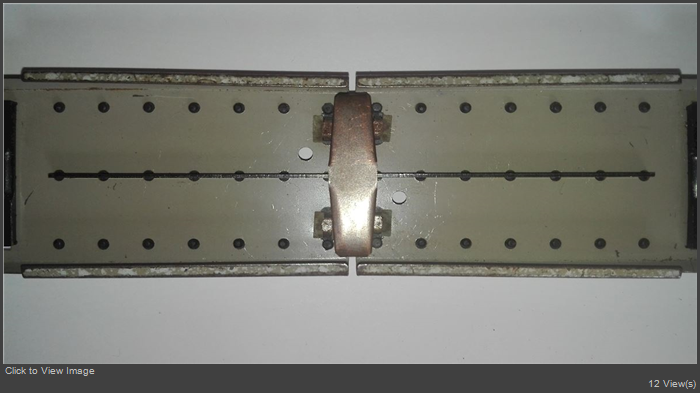

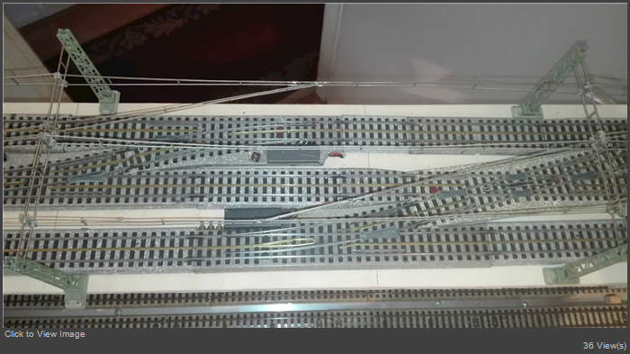

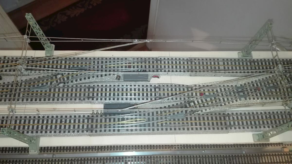

Thanks Kimball,
Probably a little misunderstanding caused by my wrong expression (everything here runs 3-rail AC so using M-trackpieces doesn't bother). Short-circuit only occures using VB's adapter-rails. However I didn't check with a multi-meter this shouldn't happen with this special adapters.
Thanks to your contribution I tried again (after years). This time a bit more secure: surprisingly no problem anymore. Exept when the adapter-railbody touches a M-railbody (i.c. 3900) beneath. Avoiding this, the problem seemed to be solved. As technically quite under-educated I blindly depend on experienIMG_20191022_133749.jpgce. How this adapter-rails works I don't know. There seemes to be a change between middelrail- and Pukopart. I hope bygoing pics are helpfull by giving answers to this 'miracle'.
Marc
