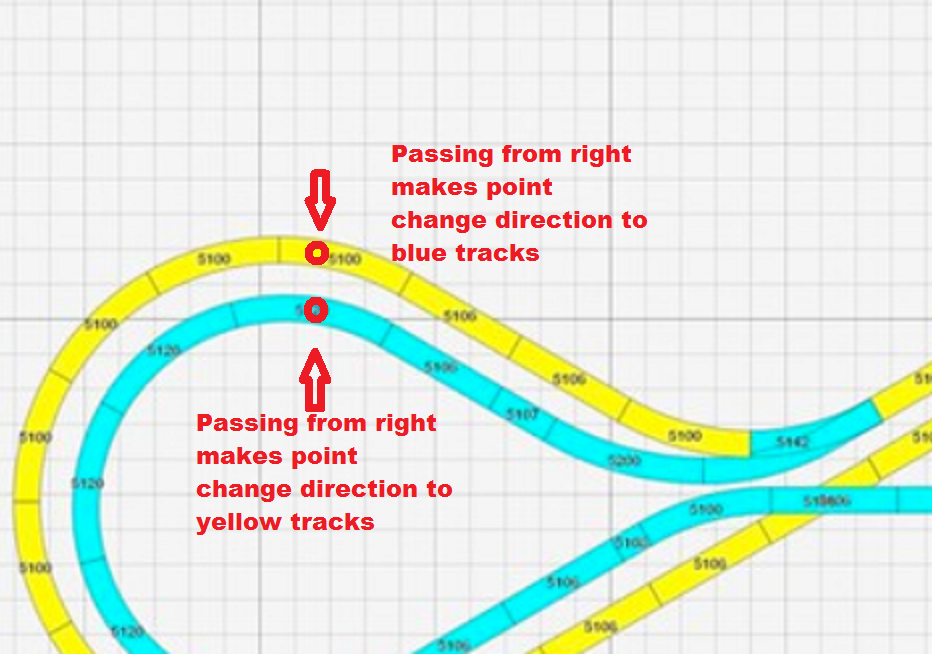

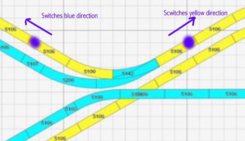

The 5146 recognizes the direction of the train. I made a small sketch with two 5146 which should work: The returning train switches to the yellow circle and the loco reaching the yellow line switches back the point to the blue line.
Markus
#6 Posted : 09 June 2019 11:48:03(UTC)
Posts: 3,528
I don't think this will work Cool
Your 5146 "Switches yellow direction" will be activated by every train passing from the left; meaning that both trains coming from the blue reversing loop and from the orange depot will activate it.
My plan was to mount the two 5146s, one in the same position as your "Switches blue direction" and the one more just below on your drawing.
Of course this means that the train always have to "cut" the points open, because every time it enters a point, the turnout will be in the opposite position; but this should not be a problem.
points
