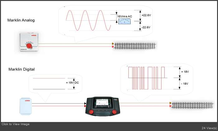

Track voltage of Marklin old analog system is maximum 16 Vrms AC, sinewave of 50Hz or 60Hz depending on your electricity source. This voltage can be measured using ordinary multi-meter.
The track voltage of Marklin digital is 18 Vrms AC, square wave, the frequency is variable depending the modulation of its digital protocol. Ordinary multi-meter may not be able to accurately measure square wave AC, especially at frequency higher than its limit (multi-meter has certain AC frequency range it can measure within tolerable accuracy. Cheap multi-meter is usually accurate below 100Hz only. Some expensive multimeter may be able to get accurate reading till 1KHz).
Below is the graphical representation of Marklin track voltage:
Below is the rms figure of several waveforms:
waveforms
For those who curious to know more about AC voltage measurement accuracy on different multimeter, may read this: https://meettechniek.info/multimeter-avo/measurement-deviation.html
thanks 4 users liked this useful post by tiono

Voltages on Marklin systems:
Power supply Between tracks (as seen by locomotive's decoder)
Marklin analog 16 Vrms AC 16 Vrms AC ( 45.2 V peak to peak )
Marklin early digital 16 Vrms AC 22 Vrms AC ( 44 V peak to peak )
Marklin modern digital 19 V DC 18 Vrms AC ( 36 V peak to peak )
The power of Marklin early digital (Delta & 6021) is supplied by transformer in AC, the same as analog, therefore the output at track will resemble the rectified voltage of the transformer (which is 22.6V DC minus the drop voltage on rectifier, so approx 22V).
While the modern Marklin digital (CS & MS) is supplied by switched power supply in DC. 19V instead of 22V, thus the output will be approx 18V (after factoring the drop at internal components).
Track voltage can be increased without problem as long as the corresponding electronics (decoder & controller) are able to handle. Just make sure that you look at the spec carefully whether it is Vrms or Vpp.
