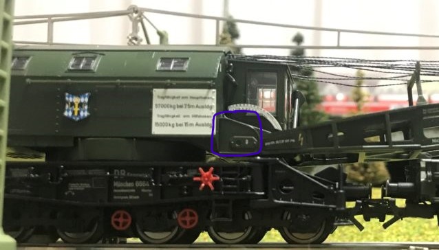

First, it is unfortunate to report my crane cable unspooled over the weekend and is back at the dealer for repairs (I am not a handy man and have no skill to respool the cable myself).
I can attest that adding slack at the resting position gives the boom more leeway at swiveling to either side and helps prevent the boom car from tilting on the track. The key of course is not slacking the cable too much.
What I found was my crane had a defect ex factory, which I would characterize as manufacturing tolerance issue. Sorry I didn't take a photo to illustrate. In short, as Phascolarctos mentioned in his other post, the boom and the crane housing are two separate pieces and not rigidly fixed. Instead the boom has a pin on both sides of boom base that can slide along a hidden groove behind a panel (highlighted in blue) on the crane housing that allows the boom to turn, which is necessary as the boom is otherwise anchored and fixed to the boom center pin, unlike the Goliath crane which can sway on the boom car support on curves. For this reason the Ardelt crane boom does not have same load bearing capacity like the Goliath crane, and that may explain why Marklin does not advertise its load capacity.
Long story short, the plastic boom base pin on one side has an extruded burr from the molding process. It is almost unnoticeable by naked eye but on tight curves when the pin comes out from the highlighted panel it cannot slide back in because of manufacturing tolerance. The boom is forced in the center position by the boom car pin, and will be out of center alignment if subsequently raised and leaves the resting support. As Phascolarctos mentioned, the Ardelt crane needs some cable slack to allow boom play on curves, but over multiple left-right turns when the boom is effectively stuck, more cable slack results over time and eventually the cable becomes unspooled. This is a major issue as it severely restricts operations on curves and turnouts, and an unspooled crane is effectively a dead crane.
I took the crane back to the dealer. He is well aware of the issues and is trying to fix this for me. I guess using fine grit sandpaper to smooth out the burr (after respooling the cable in the first place) should solve the problem.
Don't get me wrong. I am not suggesting the Marklin Ardelt crane has a flawed design or is prone to break down on normal operations. I do encourage to-be owners to inspect the boom base pins and check the boom can turn smoothly on both sides before taking delivery. Prospect owners should pick up the crane at a brick and mortar dealer if possible to avoid disappointment. After all, the Marklin Ardelt crane is not just another tried and proven locomotive, but a highly engineered model that warrants inspection before taking delivery. I test ran the crane with the dealer principal on various curves and turnouts and all functions for a good 90 minutes, but this is a new tooling and neither of us understood the intricacies inherent to the model design.
We all want to enjoy the crane, but no one wants to take home a lemon crane and becomes cranky. Blink
Hope that helps.

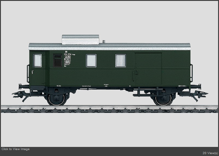

Change gears, would DB Pwgs 41 featured in Marklin 46982 fit as the complementary crane crew car?
I had an entire train picked out for the Goliath crane which I did not end up buying. This discussion will hopefully lead me to figuring out what loco and cars might best accompany the basic three unit crane set.

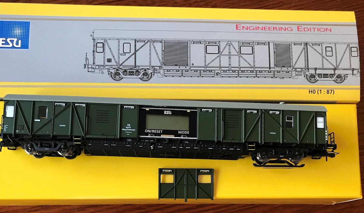

A while ago I asked what loco to pull the crane and someone posted an archive photo of DB Class 50. I happen to have an old 3084 digitized, and am trying to replicate the archive train consist. For now I use a Thunderbox as crew car but eventually want to find a proper crew car for the crane set.
Edited by user 14 May 2019 03:49:50(UTC)  | Reason: Not specified
thanks 7 users liked this useful post by QQQ1970

A while ago I asked what loco to pull the crane and someone posted an archive photo of DB Class 50. I happen to have old 3084 digitized, and am trying to replicate the archive train consist.
Thanks for those pictures!
I have a Class 50 which is underutilized at the moment, so that would make a good choice for me too!

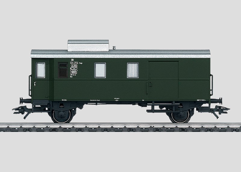

Thanks for your suggestions on crew car. I wonder if Marklin 46980 or 46982 would be a fitting crew car.

Offline Legless
#22 Posted : 22 May 2019 07:10:27(UTC)
Legless
Joined: 20/07/2007(UTC)
Posts: 809
Location: Leopold, Victoria
I’m very interested in this thread as I’m still waiting for mine. You should be able to slow the turning speed by altering the C.V. Settings.
This is the hilfsgerätewagon that I will be combining with the crane set.
Legless
thanks 2 users liked this useful post by Legless
Offline Legless
#23 Posted : 22 May 2019 07:13:03(UTC)
Legless
Posts: 809
This ESU wagon has the screen you can measure speed volts etc.
Legless
Offline QQQ1970
#24 Posted : 22 May 2019 14:34:30(UTC)
QQQ1970
Joined: 06/02/2018(UTC)
Posts: 418
Location: Ontario, Toronto
So far I tried and changing acceleration delay or max speed value doesn't seem to change the crane housing rotation speed.
That ESU car is too long for my layout.

Offline Phascolarctos
#27 Posted : 23 May 2019 04:31:47(UTC)
Phascolarctos
Joined: 08/05/2019(UTC)
Posts: 10
Location: Washington State
QQQ1700:
The answer to your question whether the Maerklin 46980 / 46982 Gueterzugbegleitwagen (= Caboose) is a suitable crew car has to be a "yes, but". Both the 46980 / 82 are cabooses that would have the correct color and they are of the correct era. I myself use the "Behelfspersonenwagen" that you mentioned in your opening post as modified to serve as a caboose. Thus, era 3 and caboose would be a possible choice.
However, during era 3, the Bundesbahn was notoriously short of cabooses, and it would be unlikely that one of their rare caboose would have been modified for use as a maintenance / crane crew car.
The typical crew car would need to accommodate five to six persons that travel with the crane, usually for days at a time, and thus, they would be the living quarters for the crew with bunks, wash rooms, and kitchen facilities. Thus, these crew cars would usually be slightly larger than the 46980 /82 cars. A Donnerbuechse like you showed in your train photo would have been much more likely, because it would be large enough to house the described facilities. And this is where the MCi43 Behelfspersonenwagen comes in, because these were readily available in the 1950s for conversion. The crew cars that were modified would have been modified directly from the Behelfspersonenwagen just like the cabooses would have been converted directly from the passenger cars. So, my crew-car = caboose would look closer to the part (and this is probably why you asked in the first place), just the registration would be wrong.
Forum member "legless" suggested to use the esu Einheitshilfsgeraetewagen (EHB) 388 as a crane train car. The purist in me would recommend against that. "Einheitshilfsgeraetewagen" means "standardized incident response car". These are cars that would be stationed at major rail centers, and would be deployed in accidents. They have all the equipment (including first aid) that would allow to respond to accidents. For example, they'd have hydraulic salvage equipment to re-rail locomotives and cars (search the net for "Deutschlandgeraet, wikipedia.de is no help if you can't read German), cutting tools, torches, etc. There would always be a locomotive on standby for this car.
The EHB war painted green in era 3, yellow in era 4, and red in era 5/6. See
http://www.bahndienstwag...BDWBA/HTML300/ba388.html
or
https://www.eisenbahndie...nheitshilfsgeraetewg.htm
for photos. Interestingly enough, the EHBs were reconstructed by combining the bodies of two Behelfspersonenwagen MCi43, left over after WWII, and placing them on reusable old bogies.
For a crane crew car, the EHB would be too large, and our Ardelt 57t crane is not strong enough to lift a derailed steam engine, so it would not be used for your "typical" accident with a large derailed engine.
Were does all that leave us model railroaders? Maintenance support cars can be found regularly by most of the usual suspect manufacturers, as I had mentioned earlier. Try green painted box cars, the occasional Donnerbuechse, some will be modified as crew cars or cabooses, as well. Just nothing too modern - the Ardelt 57t crane was replaced soon, and there were only four of them if I remember correctly.
'hope my ramblings are of interest, remember that railroading should remain to be fun, "enjoy what suits you" is a phrase that comes to mind when someone becomes too serious in their response.
cheers,
Phascolarctos
thanks 1 user liked this useful post by Phascolarctos

Offline QQQ1970
#32 Posted : 02 June 2019 22:51:40(UTC)
QQQ1970
Posts: 418
Update on steam crane: while dealer principal can respool the cable, he cannot fix the boom swing issue so he will exchange my steam crane with a new one from the next shipment.
Offline dickinsonj
#33 Posted : 03 June 2019 00:41:18(UTC)
Joined: 05/12/2008(UTC)
Posts: 1,889
Location: Crozet, Virginia
I hope that is just a one off problem and not something that all of the cranes will have to deal with and that your replacement will work as expected. I assume that the Märklin digital dude could not find a solution to slowing down the motor speed since I have not heard anything more from him about that.
No word yet on mine but my dealer thought that they might get it sometime in June.
Edited by user 04 June 2019 00:38:19(UTC)  | Reason: Not specified

Offline QQQ1970
#36 Posted : 04 June 2019 01:15:43(UTC)
QQQ1970
Posts: 418
Although I don't read German I am aware of the guy who posted his bent support car. I look at mine and although it looks like bent, at closer examination I find the side panel is molded as trapezoidal form to give a look it is bent due to heavy use.
I also saw the video which suggests the crane can negotiate R1 curve.

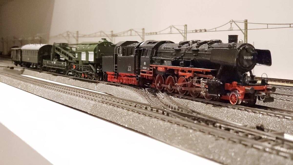

Offline QQQ1970
#49 Posted : 31 August 2019 01:24:15(UTC)
QQQ1970
Posts: 418
Glad to hear your crane has finally arrived. We all have priorities but I suggest you test run the crane sooner than later so that if there is any gremlin you can take it back to dealer asap.
Offline QQQ1970
#50 Posted : 01 September 2019 06:10:22(UTC)
QQQ1970
Posts: 418
After testing the crane, I start to take a look at the accessories. Just wonder if someone can shed some light on the following:
1. There is a counterweight part included in the package. Where am I supposed to store that part when the crane is not in operation? I recall I read somewhere the lower counterweight is stored in the crane chassis but I can't find a spot where it would fit. Anyone has idea?
2. Prototypically, is it correct to install the counterweight on the crane when not in use?
3. Has anyone put the counterweight on the crane during crane operation and does it help the weight balance?
Sebastian
