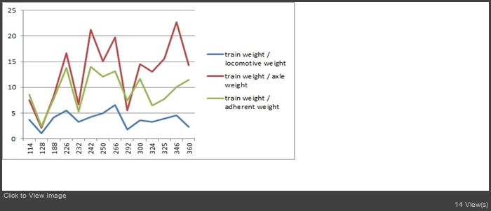

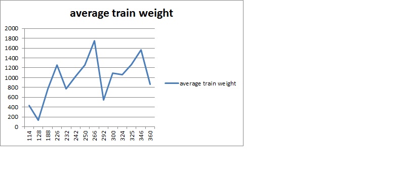

I've been thinking for some time about how to determine how many wagons a märklin locomotive could haul. There have been comments lately about whether the classic marklin locomotives have more power than the current models, and about the weights of the classic locomotives versus the current ones.
I have been reading about the railway, and it seems that the weight of the locomotive is the main factor apart from the power of the locomotive engine, ie the power of the locomotive engine is transmitted to the track by the weight of the locomotive.

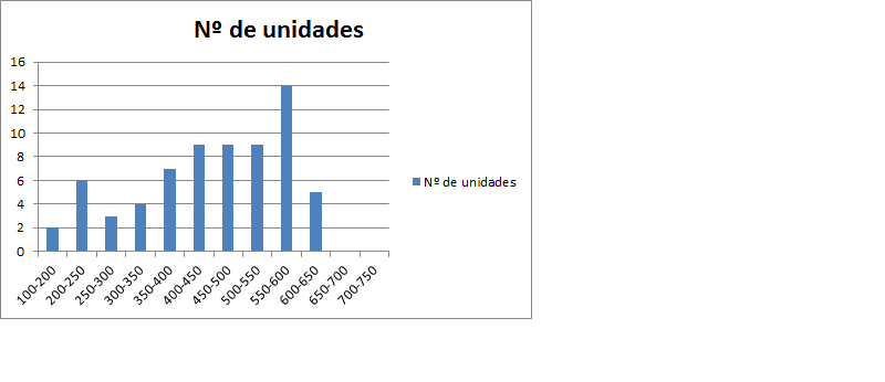

In my locomotive collection this weight fluctuates between 114 gr of the Glaskasten 36861 and 646 gr of the Taurus 39355.
Numero de unidades means number of units or number of locomotives
And the horizontal axis represents the weights in grams.

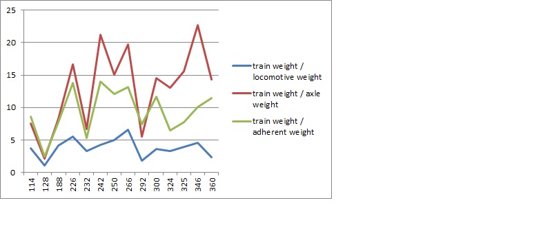

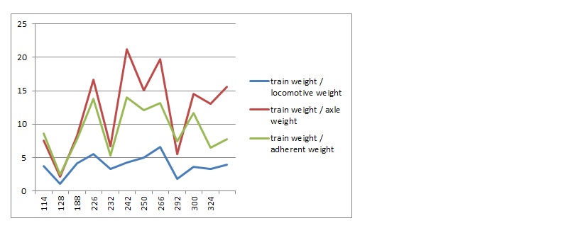

But the weight of the locomotive is divided between the axles it has giving a value of weight per axle, this is the same in the case of drive axles or guide axles, but for traction only axles with traction are important, so, if we suppose a locomotive 1'C1' (or 1-3-1 , 5 axles) weighing 50 Tm, would have 10 Tm/axle, and 30 Tm of drive weight, but due to the coefficient of friction between the wheel and rail this is reduced to 20%, ie 6 Tm. This quantity is called adherent weight.
In future emails in this same thread I will show the individual data in more detail.
Translated with www.DeepL.com/Translator

In this graph we can see the evolution of the relations between dragged weight and weight of the locomotive or adherent weight, for the locomotives tested until now.
Apparently no relationship or trend is observed.

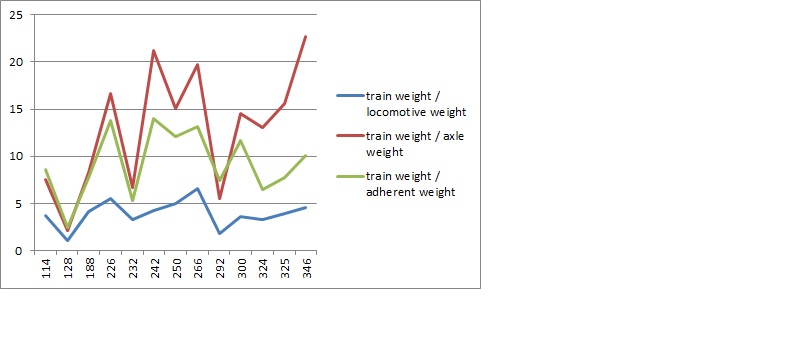

I am encountering some problems, in the hidden areas of my layout and using M track, to detect the trains, I use the trick as described on my website.
http://www.raildigital.e...os/Trucos2.htm#deteccion
In normal train operation locomotives pass these sensors perfectly, but during these tests many locomotives skid as they pass these sensors.
And the other problem I've come across is that the wagons derail above all is the curves of R1, in some cases I have increased the ballast of the wagons, and I have discarded for the tests some wagons, hence also the differences in the weight of the trains.
And now some graphics, the horizontal axis is the weight of the locomotives tested so far

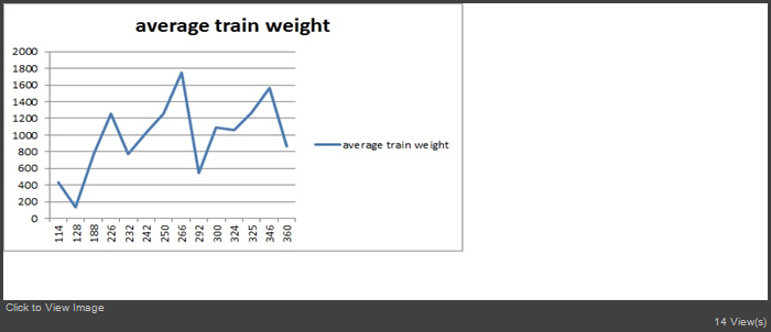

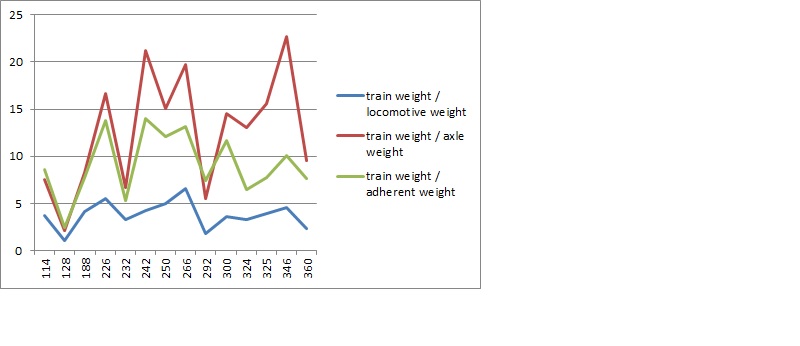

Now another graph but assuming that the weight is distributed between the 4 axles of the two bogies and the two drive axles of the ends.

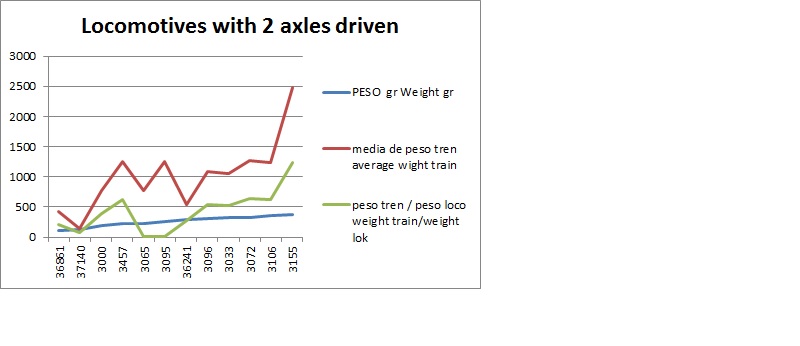

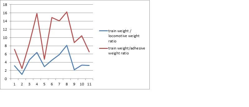

And now some graphics, the horizontal axis is the catalog number of the locomotives, with 2 axles driven, tested so far
