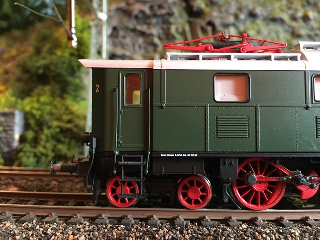

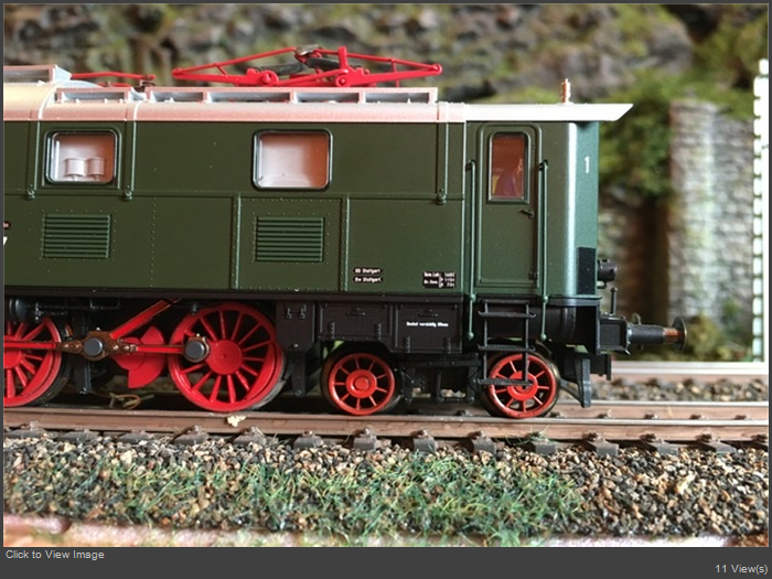

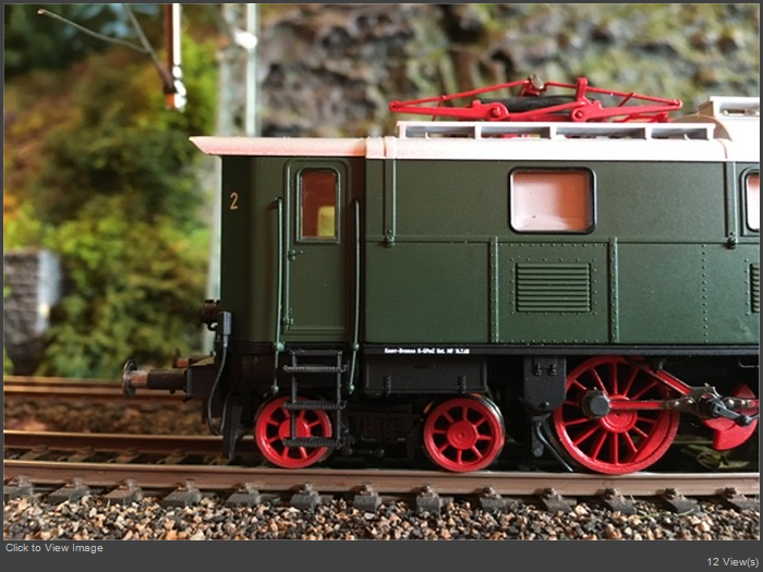

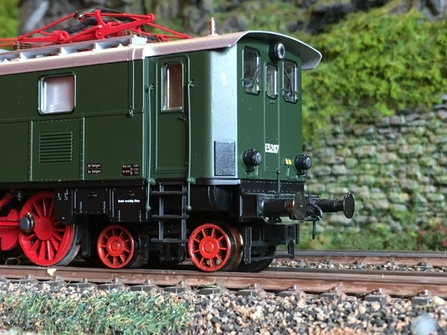

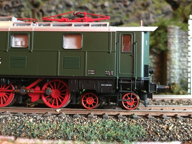

Today the Marklin wheelsets arrived. The Marklin E152202 from the Br64 is slightly smaller compared to the original Flm E52 wheels. The perfectionist could try the 1 mm larger Br24 wheels.
I changed wheels on one side. On the number 1 side the Marklin wheels are installed. The number 2 side has the original.
Looking good I would say Cool
Then I went for a drive.
IMG_0153.MOV (8,857kb) downloaded 32 time(s).
For me a perfect solution and I’m very happy! This enables me to use this fantastic locomotive as it should be. I’m gonna give Flm and MSL an update. This could be helpful for others.
