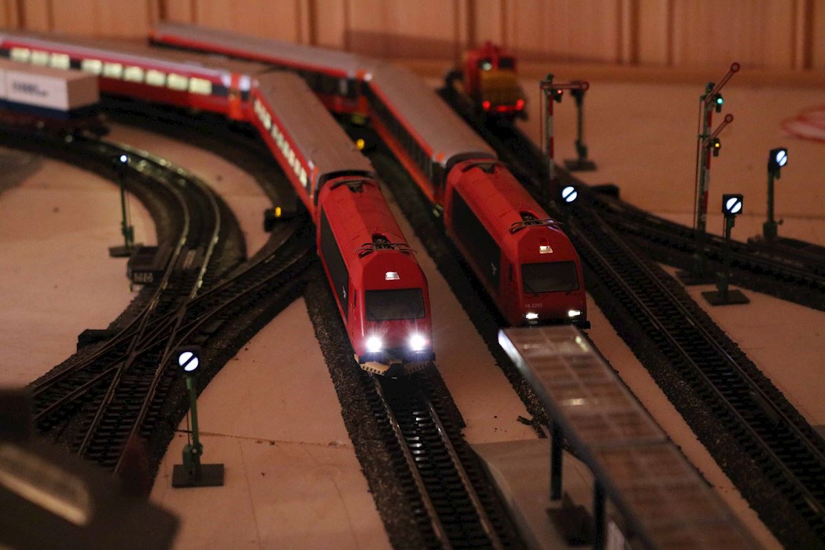

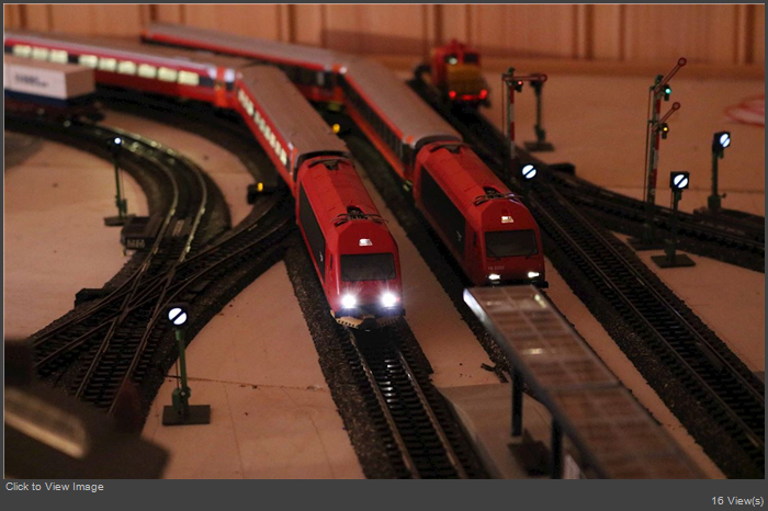

I used 1 Kohm resistors for all the leds when I converted my EL18 2241 with the MSD3 and E172883 (1 at each pads for white lights). The LEDS are a little too bright but can be dimmed in the decoder settings. See the picture to compare with the EL18 2255 that is originally fitted with that LED board.
Be aware that the light conductor for the top light needs to be shortened to line up correctly behind the LED board.
