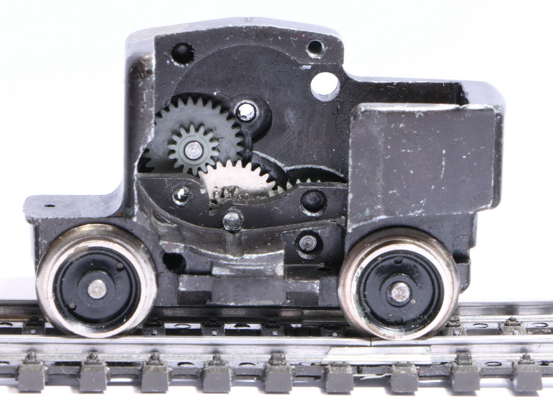

The motor truck open and clean
The 60943 motor in place

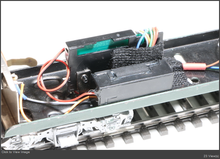

The 60976 decoder in place

I used the F7 sounds from the Märklin Soundbibliotek as the main sounds (programmed with 60971 and mDT3 software).
