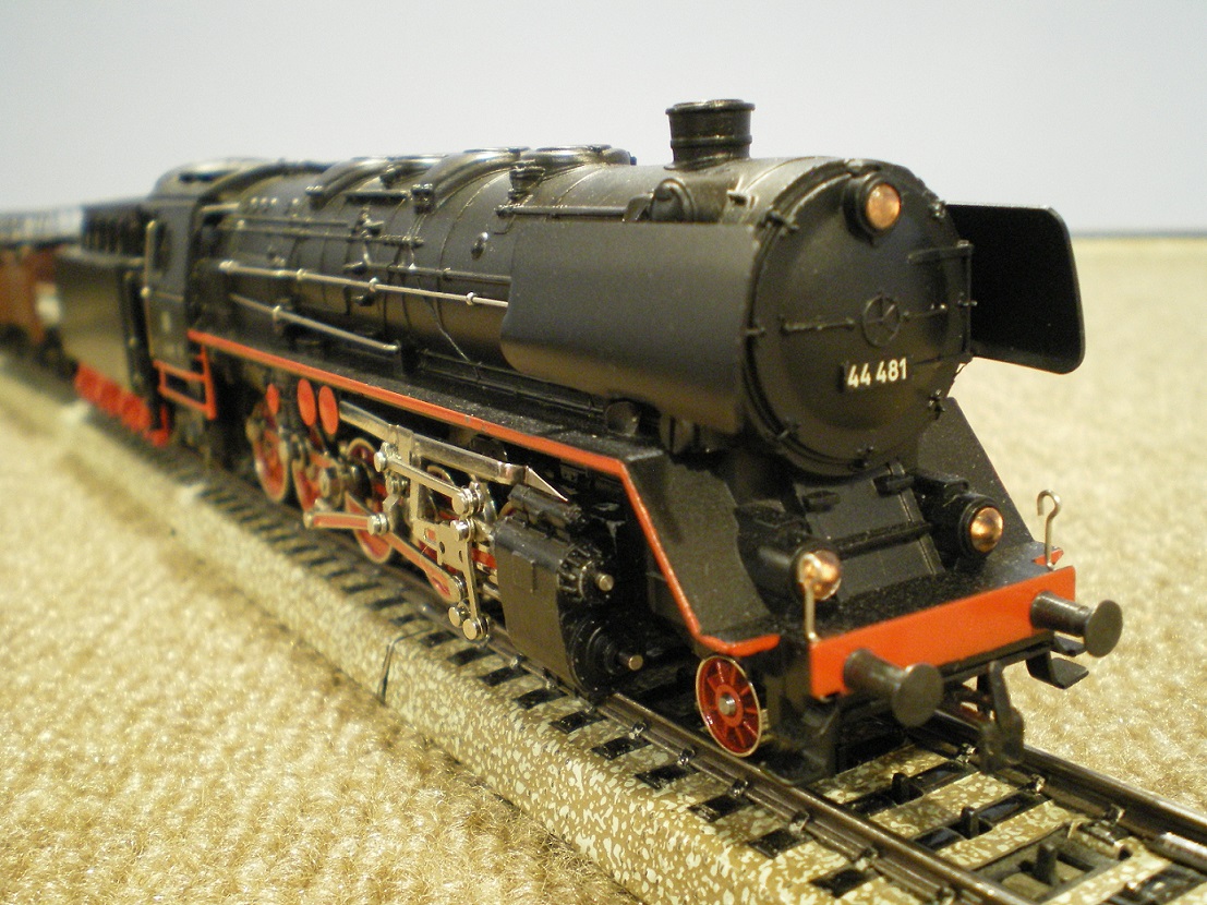

Does any one really know, Just how long an analog Lok can sit stalled with lights on without burning up the motor?
I stepped out for a bit (20-30 mins) and I had left a Br-44 going dead slow. When I had returned The old girl was just sitting there on a bad section of track, stalled. I used to do this intentionally when I was a kid...Just to hear the Lok say ''RRRRR - RRRRR - RRRRR''. Particularly the older Br-01.

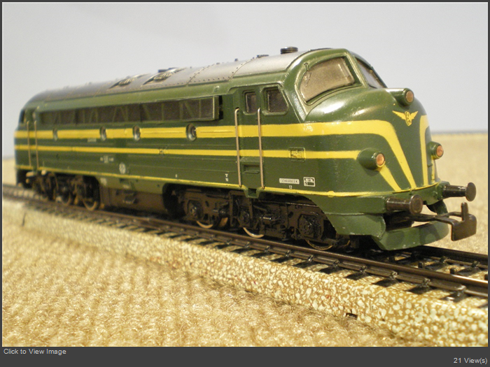

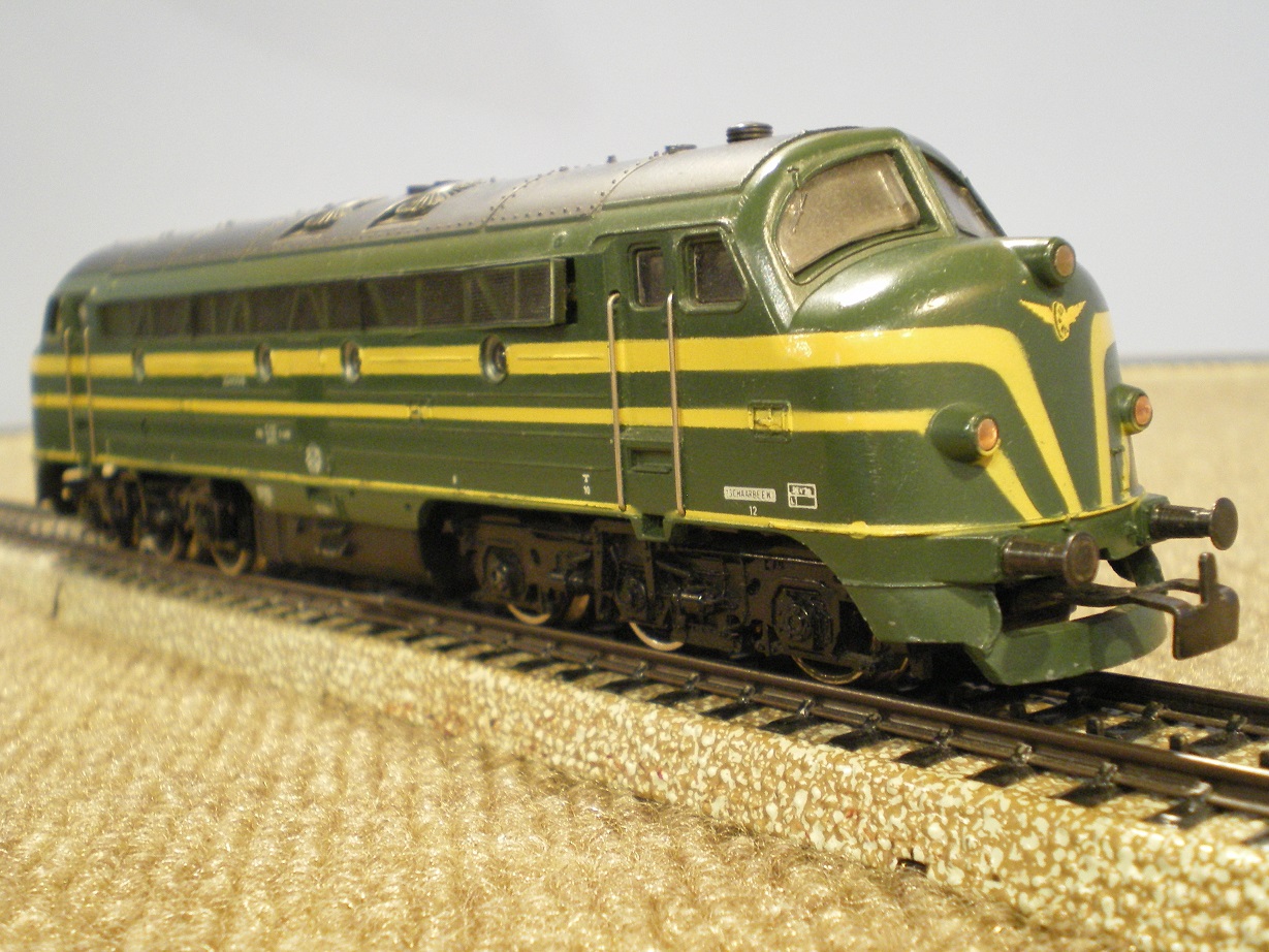

OK, I did it.
Lok-3066
9- volts AC at the track, (No Lok)
6- Volts AC at the track, (Lok on track)
Test Time- 3 hours
Results- Lok fine. Motor Bogie warm temperature, Not as warm as if Lok were running.
Traffo- Normal, warm, OK
Conclusion: Flapper
Mikey
