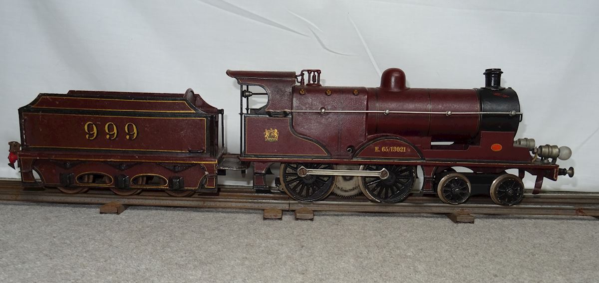

A friend has let me have a Marklin 1 gauge 20V electric loco and track.
I believe the loco and tender are a model of the Midland Railway maroon 4P 4-4-0 numbered 999 from the Deeley 990 class. I think Marklin made an earlier shorter version of this model, with the brush covers exposed and a ‘B’ on the cab plate. The one I have is the longer version with the hinged flap over the brush covers and a ‘C’ on the cab plate. It has E.65/13021 on the right-hand splasher. It’s in original condition , in the sense that there has been no restoration that I can see. The loco and tender are complete as far as I know, and the loco paintwork is good, and better than the tender which has “browned” a little.

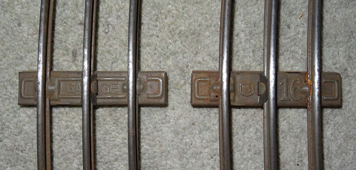

They were purchased from Gamage’s in Holborn, London, along with Marklin track, transformer and controller. The loco and tender have the Gamage’s stamp on the undersides. The track has ‘Gamage’ pressed into the middle sleeper of each track piece. There are also some without this. There are two points, one LH and one RH, both with Bond’s London stamped under the base.

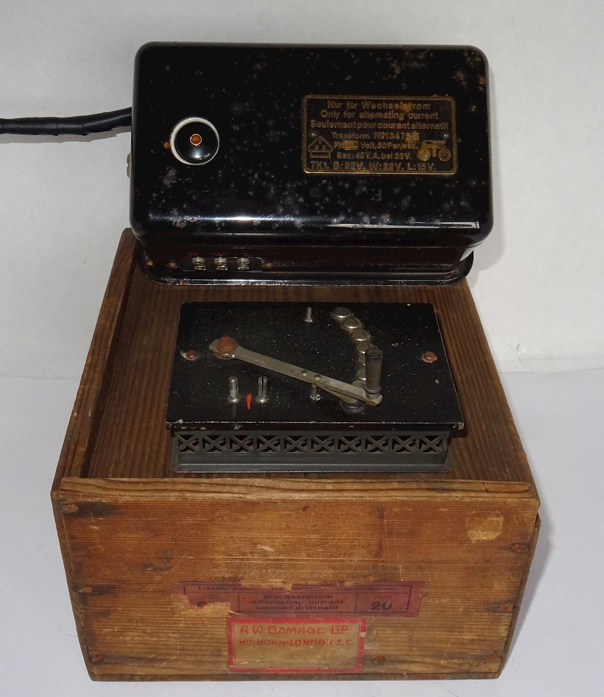

The transformer, reference VDE TK1 No. 13475B, is in its original wooden box with a good part of the red label remaining, and there is also a Gamage’s label.
After some careful cleaning, the loco and tender look pretty good. The inside of the transformer is very good with just some small corrosion on the leaves, and I have replaced the mains lead. The track was quite rusty, but looks cleaner now after some hard work.
I’m pleased to say that I’ve had the loco running around an oval of the track, using the original transformer and controller. I think the track needs a bit more work to improve conductivity on the rails and between pieces.

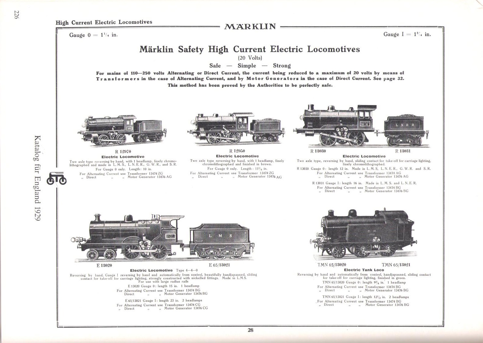

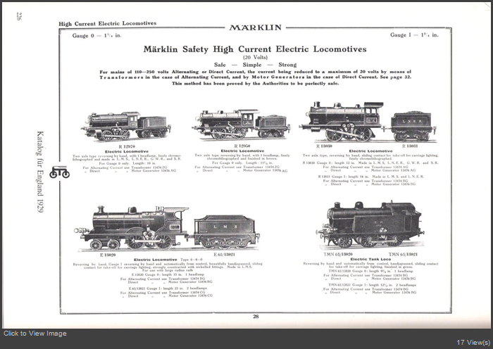

Here's a start, slightly different lettering, this is not uncommon, '999' may have been a special run for Gamages, even with the same reference.
From the 1929 English edition Catalogue, this image below is the 13020 15" 0-gauge version so it's more compact than the 23" 1-gauge version. I did not spot it in any of the German catalogues ones I have for that period but I'll take another look later but I suggest it's certainly late 20's / early 30's.

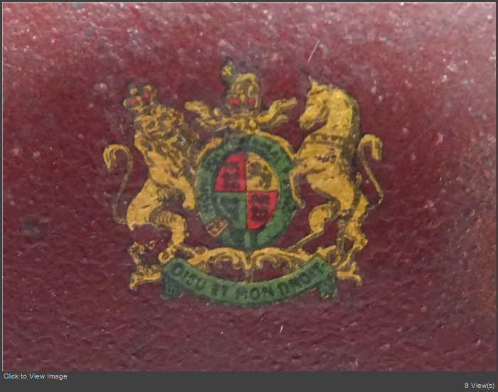

I've consulted my copy of the Schiffmann Sammlerkatalog, and it looks like the E65/13021 was produced in LMS livery from 1926-34.
I doubt the "999" numbering on the tender was specially produced for Gamages, instead I would assume it to be a representation of the earlier Midland Railway livery which would probably place your loco at the beginning of production in 1926 or 27. A photo of the crest on the loco's cabside would help to confirm this.

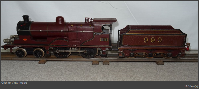

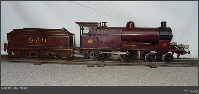

Many thanks Steve, Marco and Peter for the very helpful comments.
I'm pretty certain Marklin would have modelled this loco on the real thing on the Midland Railway (absorbed later into the LMS) which made ten of these engines numbered from 990 to 999. I gather they were built between 1907 and 1909, and the last one to be withdrawn from service was 999 in 1929. None have survived.
I've attached a few more photos. The track photo is just to show the difference between the middle sleepers on the 'Gamage' version (most of the track) and (I assume) the standard version.

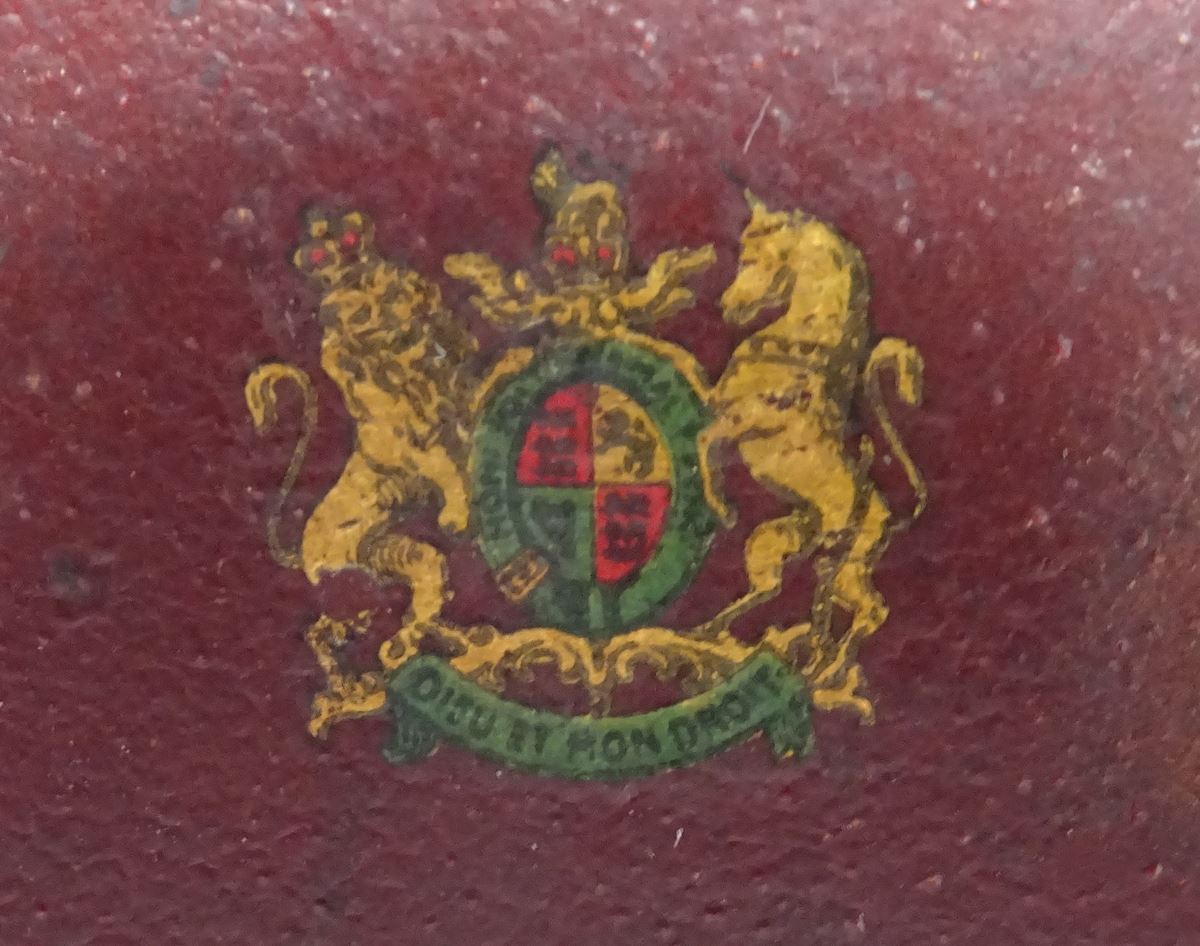

Hi Philip,
Yes, Marklin modelled the loco on the real thing, although they were not able to keep up with the changes in livery following the grouping in 1923.
Unlike Hornby, who in 1923-24 introduced a plethora of short-lived and inaccurate liveries in an attempt to keep up with the changes going on in the real world, it took Marklin until 1926 to realise that there had in fact been a change at all, hence LMS/LNER livery only began to appear in 1926/27. The crest on the cabside of your loco is unsurprisingly the Midland Railway crest, and the mark on the rear tender (I/48) tells you the gauge (1), and the width of the track (48mm).
