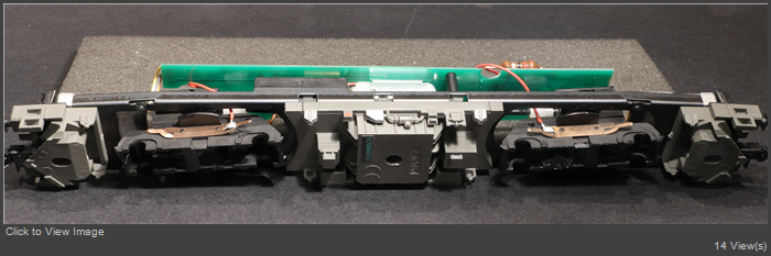

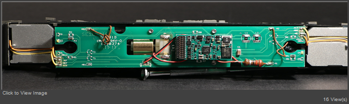

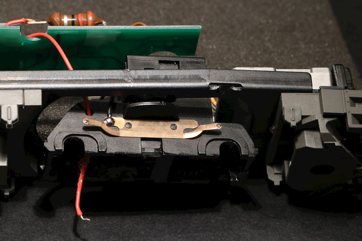

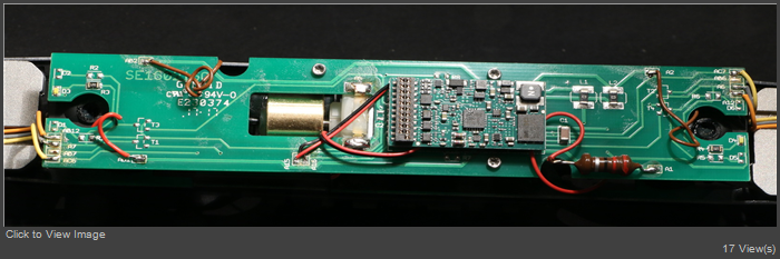

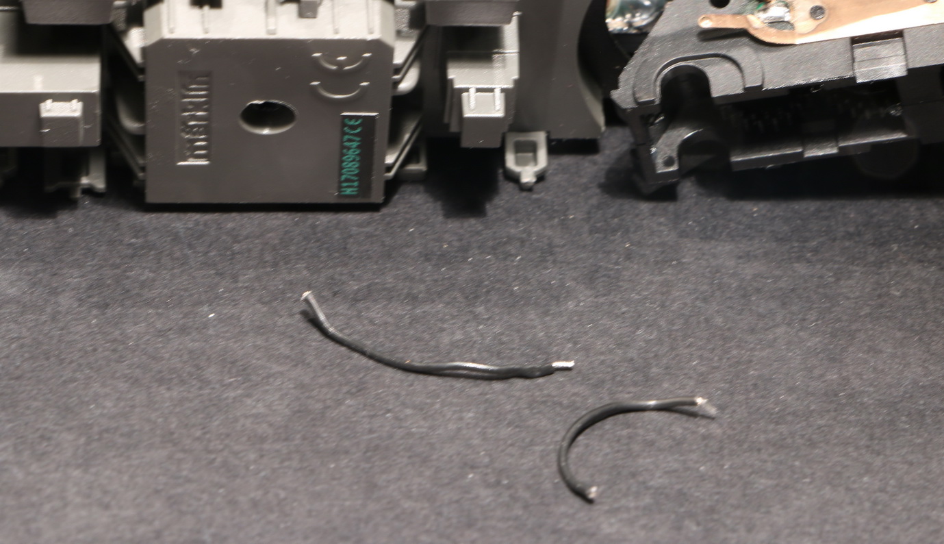

The procedure in photos
The original 3rail
Take of the pick-up
Open the truck
Desolder the red wire and the black wire
Do the same for the other black wires (2 of them one for each truck)
Solder the red wire where the black was both trucks for better contact
Do the same on the opposite side with the brown wire
Solder the wires as shown in this final photo
Close
Run
The decoder is a DCC decoder as well with address 3
Costas
