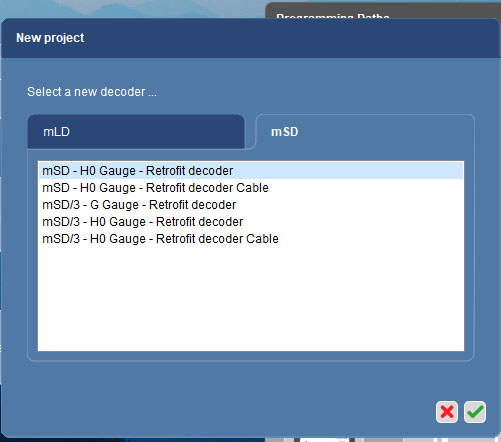

If you installed the new update over an exisiting version it is probable that you will see duplicates in the Template
These appear to relate to the files in the fds directory.
the "V1" files seem to now be loaded under the "legacy" subfolder, but the new update does not delete them from the main list
Moving these ..V1 files out of the main directory will make the "New project" template dialogue clearer.

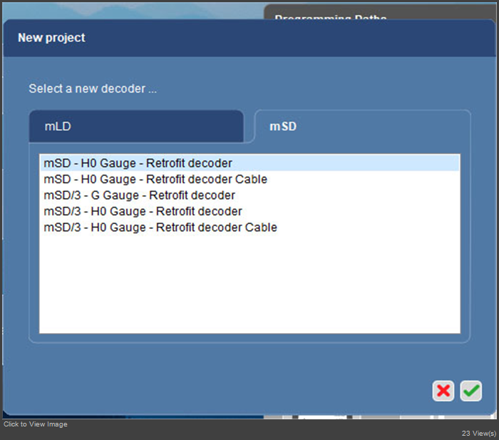

If you clear manually the result is this:
Definitely more clear
