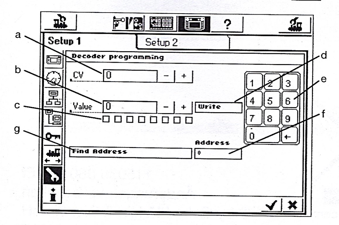

Jean is not so practical with CV values, in the manual of 60987 I do not know what CV I have to change the value, this is the photo of CS 1 where you change the parameters, you could suggest what to set.
Thank you so much

Hi Nonno
The 60987 manual say CV 50 control the active protocols
- Bit0=1 (AC operation allowed
- Bit 1=0 (Analogue DC disabled
- Bit 2=0 (DCC disabled)
- Bit 3=1 (MFX Allowed)
Total Hex value is 9
Factory setting: 15H (all bits are set to 1
Note: protocol FX is always active
User's manual https://static.maerklin....6f726f61a11515411418.pdf
So in your diagram your enter 50 in (a) and 9 in (b) and then write
I hope this will help.
