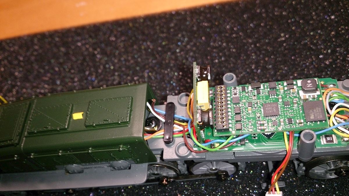

When I opened the case, I found that one brown wire was not welded to the metal piece, and the other end of the brown wire was soldered to the metal piece.
Dose this brown wire link to this place? Do I need to solder it on?

#6 Posted : 11 January 2019 21:36:19(UTC)
Posts: 8,345
Hopefully somebody else with the model can open theirs and confirm whether the brown cable is supposed to be mounted to what appears to be an anchor point for that half of the locomotive.
In the meantime, you can send an email to service(at)maerklin.de and hopefully they can get back to you in a few days.
The brown wire is normally used for the ground (return) wire. It would make sense that there would be a wire from the Decoder/PC board to the wheels on both halves of this articulated locomotive.
You mention an issue with the telex coupler. From what I understand, it is working on one side, but not on the other. Is the side with the non-functionality the same as the side where this return cable is detached? The telex would need either a pair of leads to the decoder or one lead to the decoder and one to the ground in order to function.
The parts diagram shows a pair of identical parts (a screw labelled as #2) and a contact tab for each half. Likely they would serve the same function on either side.
I could not find a wiring diagram on the intranet.

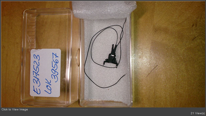

Thank you very much for your help. .
I got a new TELEX through the dealer from Marklin for replace it.
But you are right, this loco is very complicated , it looks difficultly to replace it.
#9 Posted : 12 January 2019 19:12:02(UTC)
Posts: 8,345
Test the Telex coupler once you have connected the brown wire. If the coupler has only one wire to the decoder and uses the mass for return, then it might work once the return (brown) was reconnected for that half of the lok body.
Offline shuli1969
#10 Posted : 13 January 2019 05:37:28(UTC)
shuli1969
Taiwan, Province Of China
Joined: 12/03/2017(UTC)
Posts: 13
Location: T'ai-wan, Taipei
Thanks Mike,
I have soldered the the brown wire back,but it does not affect the telex-coupler.
Shuli

Yes,it is difficult to solder on a small circuit board , so i have not replaced the telex-coupler yet.
Thanks for your information.
Shuli.
