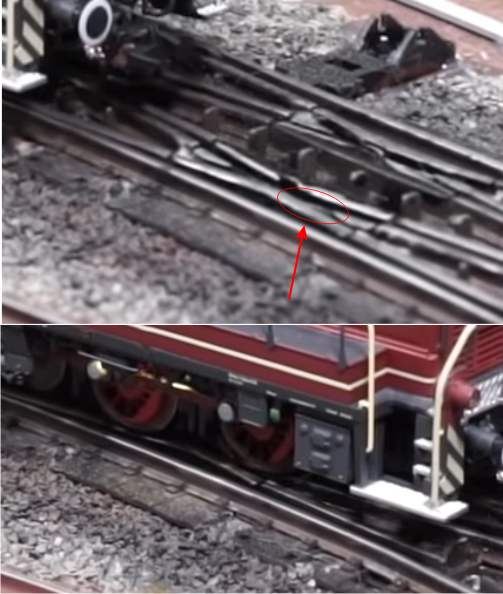

Originally Posted by: Minok
Originally Posted by: RayF
I was thinking how nice the loco looked in the video until it got to the turnouts...
That's a hell of a rough ride! No wonder the driver is putting out a smoke screen to hide his embarrassment!
The owner of the layout should be embarrassed to be showing a video of such bad track work. You can see the coaches rocking and rolling as they cross the points as well, not just the loco.
And one would fix this how?
Isn’t it the track piece geometry and the gaps in it that are going to cause this as the loco crosses over at a slow speed, whereby one gets the maximum movement into any rail gaps?
Well, looking at the video there is something sticking way up that seems to interfere with the wheels, and i don't think it is a Puko, but the shooting angle and the 'focus on the nearest object' makes it hard to tell. But I don't believe a 6 wheel item like a V60 would normally bounce like that one is.

Don't know if it this, but maybe:
At time 2:19 it seems that in crossing it seems that exists an additional part in the piece that pushes the wheels outwards.
I don't know how those peaces are called, but I mean the small segment of rail that are parallell to the outer rails to push the wheels outwards.
Also it doesn't seem they exist everywhere.
Its existence is probably to counter act the fact that DC wheelsets (probably not a problem for the V60 of ESU) don't derrail. The best alternative to this is, of course, to use DC sized wheelsets.

I don't see anything wrong with the track. What I see is that the loco's wheels dip into the gaps in the frogs, probably due to the wheel standards being different from the normal AC standards. The bogies on the coaches seem to cope much better with these crossings than the loco.
There is an audible "clunk" where the loco wheels actually fall in the gaps. I see this happen on my C-track layout sometimes when I use a non-Marklin wagon with its original DC wheel sets. At a higher speed this might even cause a derailment.
It is merely the wheel dipping down into the gap that exists in the switch/crossing. Physics. The gap can be smaller with a more crossing angle, but for a turnout the gap has to be wide. With a loco with a few wheels, the weight will force the corner of the loco down. If this was a longer 8 axel loco, then of course as the first axel went over the gap, the center of gravity is well behind the gap and so the corner would not dip down, and but with this shorter locomotive it pivots down. I suppose if they had the room to do so, they could build the locomotive so that as much of the weight as possible was over the center axel, thus when either of the end axels are over a gap, they don't drop, but just float; of course this would put all the traction requirements on those two center wheels then. To get good traction you want as many wheel doing the work, which be definition means you need downward force on them.

In our small world, the rolling stock are resting on the flanges when passing a turnout.
If the flanges are too big for the turnouts, the loco will "ride high" and not touch the rails when passing the heart-piece.
If the flanges are too small for the turnouts, the loco will drop down when passing the heart-piece.
In this case we see small ( DC-wheels ) flanges crossing a turnout build for Märklin-standard flanges.
PECO makes turnouts for 1-scale, where there's a little shims in the heart-piece that can be removed, if you use G-scale rolling stock.
You can see it here, under the screw:
https://cdn.shopify.com/....pdf?6123728320125993344
