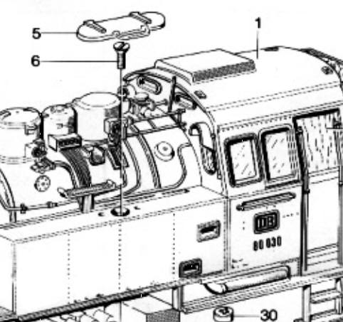

I have the above model. I am trying to remove the body. The instructions that came with it indicate that there is a screw in the middle chiminea, but I cannot find the cap to remove. Any suggestions?
#2 Posted : 27 December 2018 23:48:36(UTC)
Posts: 3,997
not sure if 3504 is of this type, but sometimes there is a small 'lid' covering the screw, which should be lifted out first.
Can you post an image of the top of the loco? The screw should be black and be of the 'flat' type. Likely in the middle of a steam dome, not in the chimney.

The screws to remove the body of the 3304/3504 Br80 tank locomotive are located under the hatches/ lids on the top of the water tank along each side of the boiler. You have to gently remove the hatch/lid with a screwdriver and they will pop off, revealing a screw on each side. Richard

Thank you very much. I had mis-interpreted the drawing. Since you are so knowledgeable, can you please help me to find information on how to convert an analog system to a digital one? Thank you.

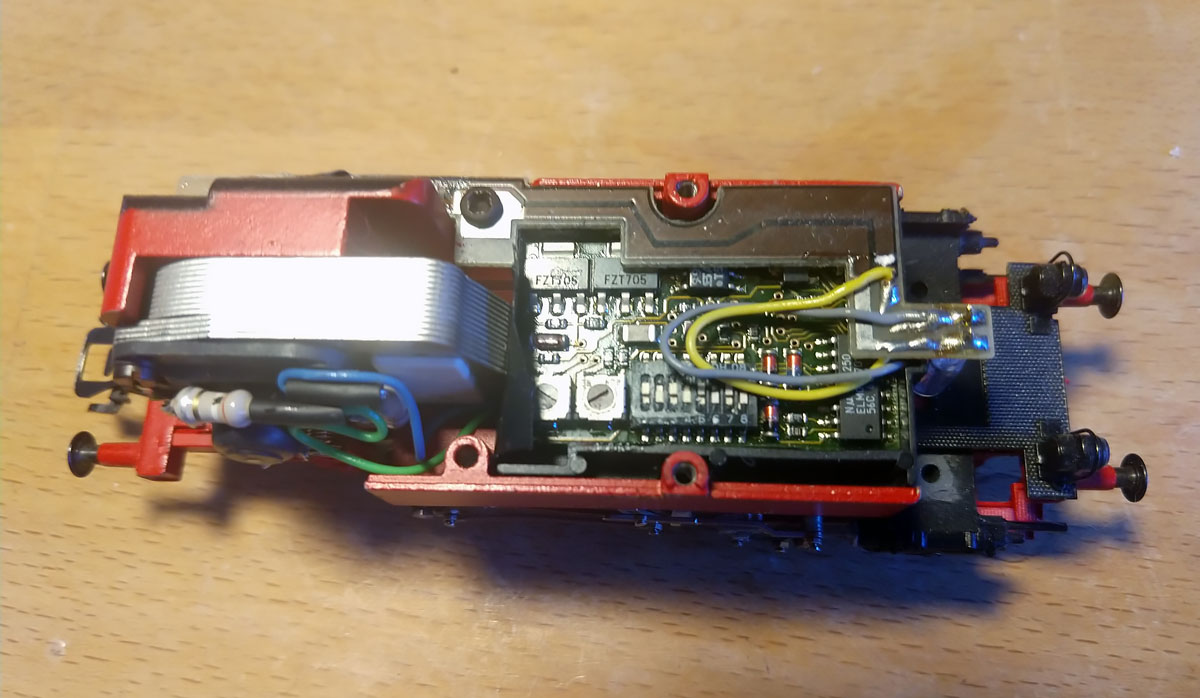

I have made a conversion of a "3504" many years ago (from the 2666 set) to 6090, if I remember correctly I ripped everything out and replaced it...
I'll try to find it in the storage location and take a pic of how it looked inside after my conversion... Can take a few days...
One thing I immediately recall is that I had problems with the 6090-set motor cover, I had to turn it upside down - otherwise it shorted towards the metal loco body.

This is how mine looks - after conversion...
Please note, motor shield mounted upside down.
