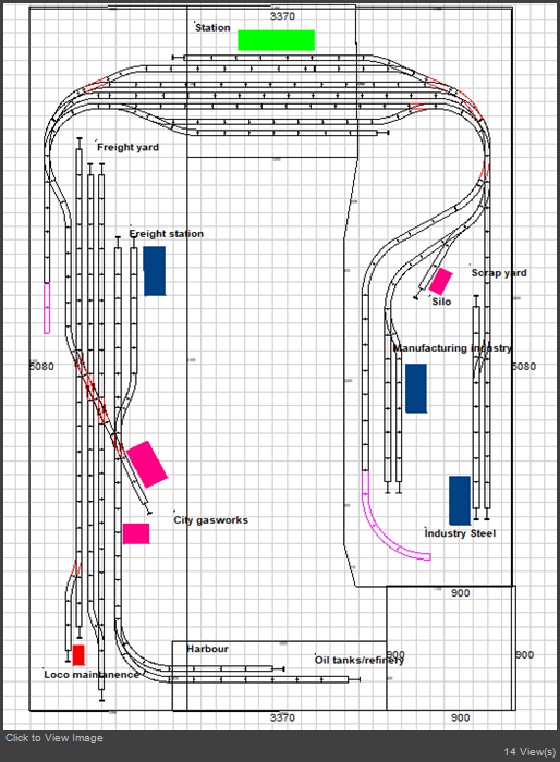

Dear all,
Since a few months back I have renovated the garage for the sole purpose of (finally) building a model railroad. The interior is roughly 5x3 meters with a door in one corner.
I plan to build an era III layout situated in (roughly) southern Germany. I want to have a through station with city and a large industrial/shunting area. The city is on the right side and the other spaces are for industry and similar things. The current plan is to have two separated shadowstations accessed through helixes (entry marked by purple track in image) The whole thing will be computer controlled once I get my head around it.
First I intend to try out a small layout as a training experience but I want think about the big one as well BigGrin. I have thought about doing the mainline as double track but I have prioritized other things. Anyway, any input will be appreciated.
/Michael

Time for yet another trackplan draft. This version tries to spread out the tracks a bit more and have decreased the width due to access. Amongst other changes there will be a detachable bridge (marked green) where the entrence is. Main line going into the station from N och S is in purple and will mostly be concealed. Both routes will go down to shadowstations for an "out and home". Green track to freight yard and industry is an intended increase by 10 cm in order to get the N main line under it. I am considering access to the "tongue" in the middle from the right instead of the left but that would entail, I guess, taking away the harbour as a climb to a harbour seems weird.
Edit: Woody - yes, the garage is temperature controlled.

You might reconsider a double main line, I regret not doing it myself. You said you will doing computer control but it will be easier to tun multiple trains and I think seeing them passing each other without stopping would be enjoyable. Just my two cents worth. Good luck on your project.

Posts: 35
Thank you for the feedback and links.
Yes, doubletrack is something that I have considered and would like to have. I'm also very keen on the "principle" that regardlesss of what inbound track the train is arriving on it should be able to access every outbound track. Especially when it is a freight train so the wagons can be uncoupled and shunted to the freight station/area. So far I have either ended up with a lot of turnouts before the station area in any doubletrack scenario (stealing space or being placed in the slopes to the shadowstations) or a singletrack mainline that by defintion provides the desired inbound/outbound solution. Maybe I need to revisit the doubletrack path again, give it a spin and see if I can come up with some viable plan.
thanks 1 user liked this useful post by miccar
Offline miccar
#8 Posted : 18 February 2019 22:08:29(UTC)
miccar
Joined: 10/01/2004(UTC)
Posts: 35
Back at it again. Per Steamnuts suggestion I went back to the drawingboard and had a stab at a doubletrack mainline. I settled for a station area four tracks wide (and no push/pull) and that trains should be no longer than 140 cm. The doubletrack approach also made me think in new directions with having one track going slightly down to a harbour area (orange track) and one track going up to an industrial area (green track). The island in the middle thus have two heights. The maintrack (purple track) is still supposed to go to two separate shadow stations.
This trackplan also allowed me to add/move some "points of interest" (e.g. sawmill and moving the loco maintanence). Aside from some additional polishing I'm actually quite happy with this trackplan. That is a new feeling ThumpUp.
