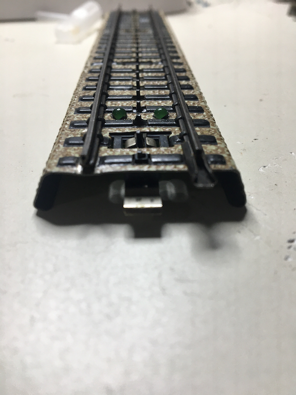

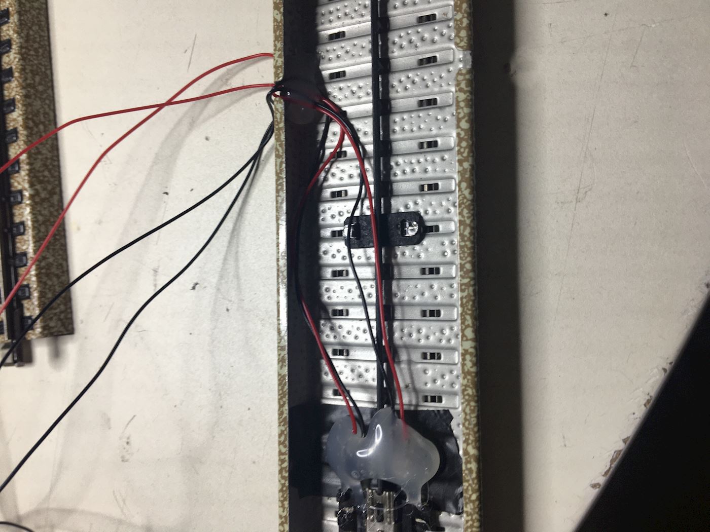

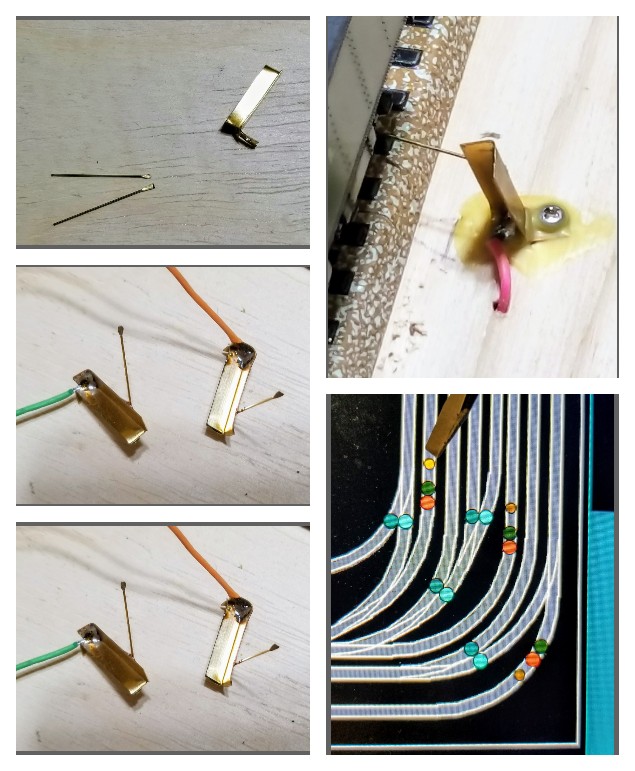

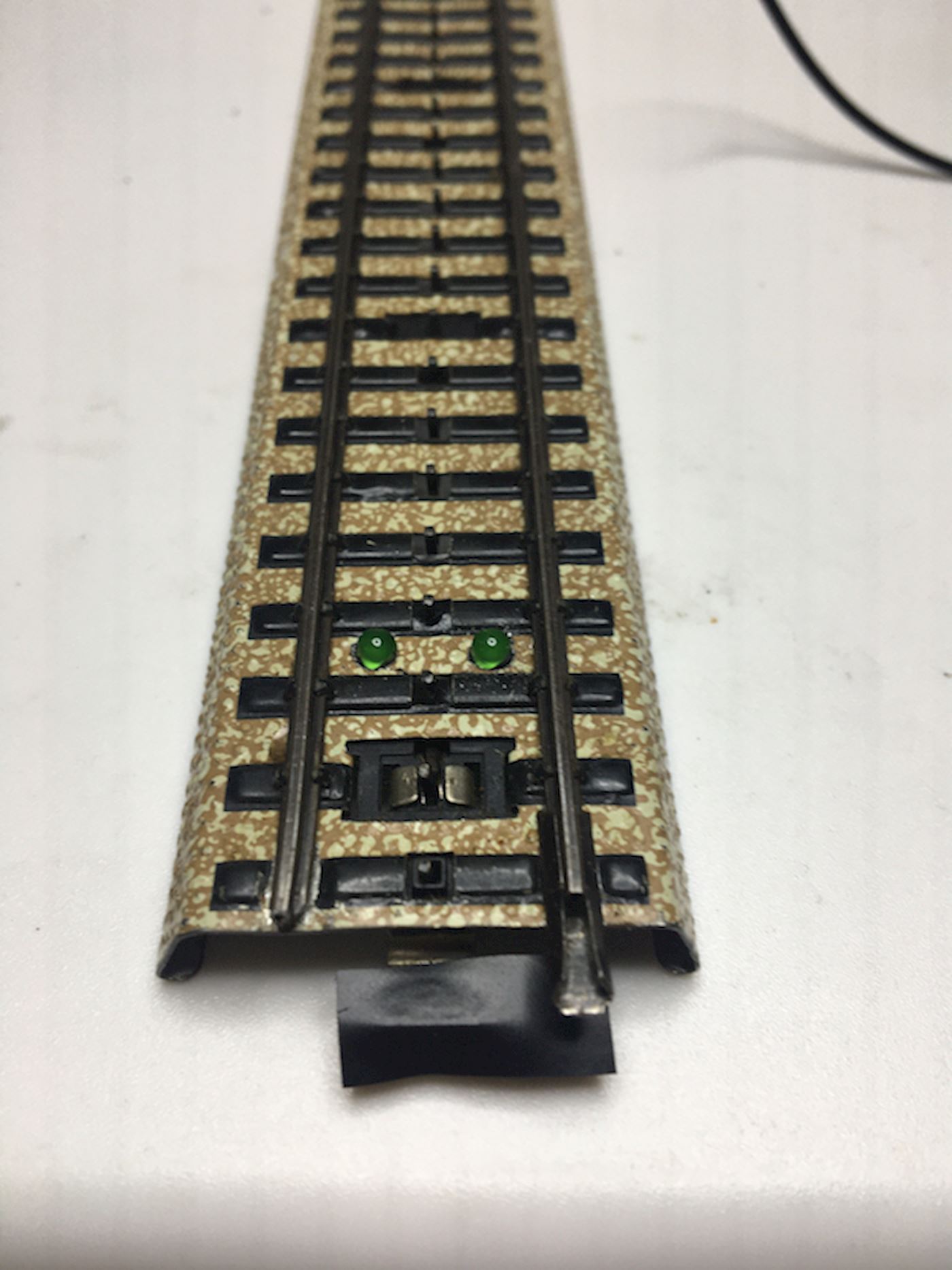

I've been replacing the homemade track sensors with the old style contact tracks. The old style contact track is a much better solution.

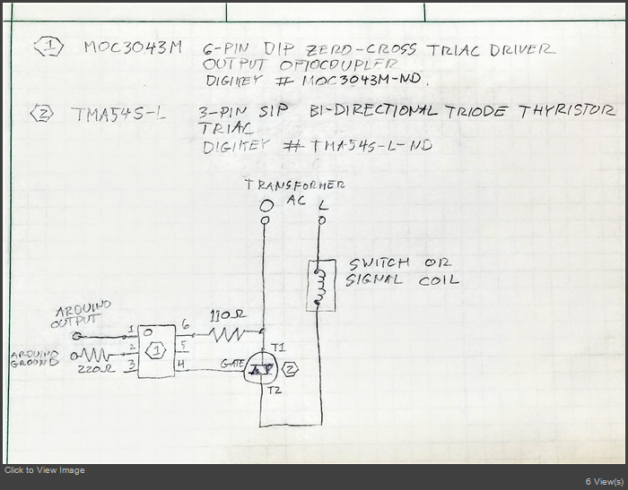

I am using an AC optoisolator an a TRIAC from Radio Shack. If you need lots of TRIACs you can get them in bulk from digikey.
I can draw out the circuit for you this weekend.
The optoisolator replaces the switch in the TRIAC schematic.

Here is the AC TRIAC driver circuit schematic I am using.
G - LGB
HO - Marklin
N - Mix of manufacturers mostly Kato
thanks 2 users liked this useful post by GaryTrooper
Offline Holz1
#26 Posted : 14 January 2020 10:13:54(UTC)
Holz1
Joined: 08/01/2020(UTC)
Posts: 18
Location: Zuid-Holland, Den Haag
BigGrin
Thanx very much. I am going to build this circuit (after having obtained the components) and I will let you know in due course.
I have built a circuit using CNY17 OptoCouplers and TIP120 Darlington NPN.
I am using 2 INFRARED gates, which are the INPUTs for the ARDUINO UNO.
The Arduino output will trigger the optocouplers and finally the Marklin M electric turnouts.
The next problem is programming the Arduino sketch and as I am a beginner you will certainly know what the problems are.
I am enclosing a file containing the drawing of the afore mentioned circuit and I hope I have contributed to your webpage and further expansion of knowledge and hobby
Henry

This is another option for cheap contacts. I smashed flat the end of a small diameter brass rod. This has actually worked surprisingly successfully for over a year now.

I have some updates with pics for my IR M-Track.
I adjusted the sensitivity on the IR sensors using resistors. Some said use 10k Ohms, but that was too much. I had to touch a piece of foil against the LEDs to make them detect. So I tried 3k Ohm resistors. That triggered around 4cm with my hand. I found that 4.7k Ohm resistors worked perfectly with a piece of foil taped to the underside of the locomotive before or after the shoe and rolling stock did not trigger the IR sensor.
Here are some pics of the finished track sections.

I'm not controlling track voltage with the Arduino. Only the signals and turnouts. I'm running the locomotives using analog, directly from the transformers. Some day I may convert the locomotives to digital but there are many and I want to get the layout built up.
The turnouts and signals are AC driven using TRIACs controled by the Arduino.

Paul,
Interfacing an Arduino to Marklin's digital system is quite a bit above my current level of digital control understanding. My simplified approach to computer control is just a course control of the analog solenoids for the switches and the signals. Track power is supplied by several different transformers and Marklin's universal relays depending which direction a train is either going up or going down a ramp.
I am using TRIACs. Marklin solenoids can be powered by DC so you can use a FETs to simplify things if you wish.
Gary
