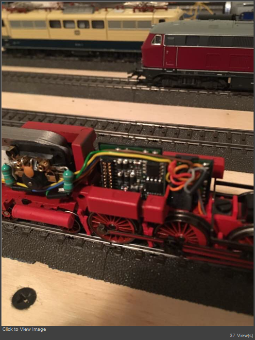

Here is a picture of the decoder. The Locomotive number is 37073. Unfortunately The picture is kinda blurry. 37073.png
To look at the left of the picture it looks like 21 pin connect? Confused
The locomotive 37073 do have fx decoder but it seems not correct what i can see in the picture?
Is the component on the left of the decoder not a bank of 8 DIP switches?
Looking at Helmut Kern's site gives me the information that the 37073 loco has a 6090X decoder, which are programmed by setting these switches.
#16 Posted : 20 October 2018 11:22:20(UTC)
Posts: 15,543
Märklin made decoders of the 60760 class with 21MTC connectors. I do not see anything unusual in the picture.
There is no doubt about your incredible DCC knowledge, but your comments about Märklin fx decoders could be confusing for the OP. Cool
According to Märklin's database the loco was in the 2003 new items brochure (and in 2003 it surely had a DIP switch decoder), but remained in the catalogue until 2006 (and at that time it probably had a programmable decoder).
Mr Kern’s site was never updated since the introduction of the programmable decoders and it always shows just one type of decoder even for locos that had several decoders over time.
Some locos that were made before and after 2005 came with different types of decoders.
To me it looks like 21MTC on the photo.

#17 Posted : 21 October 2018 02:50:10(UTC)
Originally Posted by: mjamz Go to Quoted Post
Thanks for getting back to me. It looks like its a newer decoder. It does not have the switches that the older locomotives had. Its definitely not delta.
what I really want to know is that can I change locomotive decoder addresses using just my CS3 PLUS? I plan on changing a few of my locomotives to newer decoders soon, and Id like to learn how to do these things myself.
Thanks,
m!
Yes, you can do, if it is not a mfx loco. But the most important thing is first specifying very exactly which decoder does your loco have inside.
On the one hand your BR 78 is a nice model, on the other hand Märklin issued plenty of various typs of it. Almost every type has a different decoder inside from a Delta, fx to mfx one. Also Märklin did not issue manuals for all typs without a mfx decoder. Very annoying.
The BR 78 art #37074 is the first one with a manual at Märklin's database
https://www.maerklin.de/...ts/details/article/37074
Which loco does you exactly got? Can you tell us, please, article number and the number on the loco itself? The one I saw on pictures are named BR 78 100 for a 37073. Very strange is that at some offers in the internet for the 37073 a mfx decoder is mentioned inside. Märklin's database only shows a fx decoder inside.
Please can you check which decoder format is setted while you are trying to alter the decoder address? Assure that it is not the DCC format. As far as I overviewed the various model types, I never found a decoder in this loco, Märklin mentioned the usage of a possible DCC format.
60760 don´t have 21 pin connect what i see in the manual of it.
Are you sure you know yourself better about fx decoder? Wink
The locomotive seems has been changed.
I believe TS did bought locomotive as used.

#22 Posted : 21 October 2018 10:10:19(UTC)
Posts: 15,543
Originally Posted by: Dave Banks Go to Quoted Post
Goofy could we be looking at this?
Looks different than the decoder on the blurry image. Green PCB could be Märklin fx or Märklin mfx or something completely different.
Good find. Blue decoder PCB, so this must be an ESU decoder with mfx.
I have no doubt. I have no doubt about your level of expertise.
The 60760 decoder comes with cables.
The same decoder chips are used for special decoder PCBs for TRAXX locos, for class 101 locos, and on 21MTC boards.
I know the decoders. I admit I do not stand corrected. Thanks for your valuable feedback. Cool

From what I remember, it has to be done on the programming track. You add a new loco to CS3 using item number 60760 from the data base, then with the loco with compatible decoder on the programming track change the address to desired number, upload it to to decoder and it should change to the address specified.
I hope I remembered correctly and this helps you out, it can definitely be done...
Gordon
From what I Understand, #60760 is a marklin decoder, and calling it up on the CS3, should bring up a "blank" decoder with an address 78. Other values need to be inserted. I have one of these on order and expected to arrive soon, I'll let you know how that works out
The decoder in your loco is very similar to the 60760 in operation and protocol and when you add the 60760 to your CS3 you will be able to use it's settings to program the decoder in your BR78, you do not need to have the actual 60760 decoder to use its programming features.
