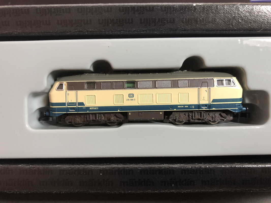

I have been recently adding some locomotives to my collection, Lately I have acquired 3 5-pole locomotives(new): 81701 Starter kit, 88784 and 88166, I assume these locomotives are ready to use as soon as they come out of the box, but is there any proper break in method?
Also I am using the starter kit pack ( tracks + controller) I have noticed that the trains run at different speeds, for example the 88784 won't start moving until the knob is at around 100(front or back, Im guessing this has to do with the weight as it is heavy), the one in the starter kit starts at around 50-100(front or back, sometimes it runs at 50 and then it stops until you turn the knob up, this is a light locomotive), the 88166 starts moving at 50 forward and backwards at 100(which is weird because at 100 backwards does the same speed as 50 forward, but as soon as you turn the dial more the speed catches up, this one is the lightest of the 3), is this normal? Shouldn't they all start moving as soon as the dial is turned? shouldn't they move at the same speed if the knob is at the same number in either direction?
What's the point of the numbers on top of the knob? I thought they would mean kph? I noticed none of my trains will move at all if the knob is pointing at anything less than 50.
I'll leave you to some pictures of my locomotives
Starter Kit
88784
88166

81701's diesellok is a vertical-mounted 5-pole motor in an 0-6-0 locomotive. Due to weight and wheels ... It has very little connection to the rails.
88784 is a Bo-Bo (2 x 2-axle trucks) locomotive and has good connection, but is a basic 5-pole 211xxx series motor (Marklin standard from 2001 onward)
88166 is a 2 axle railbus that has the newest motor (post 2017). 2 axles will have smaller amounts of conductivity.
As you can see these factors will influence how current is applied to each motor and how they turn on. The motors all are vastly different to each other and have differing running characteristics.
While I agree with Bahner about replacing oil on older Marklin locos (new or used OLD STOCK), I do not change oils or lubricate right away on new units. But you should follow their advice about lubrication if the unit is bone dry or runs warm. I also do not follow Marklin's advice to use their 7149 oil and I stick to Atlas 192 conductalube or Labelle 108 ONLY. The 7149 is too watery for z scale and gets all over the place (I know people are using it when I receive oil-soaked locomotives for repair!). And these oils (Labell 108 and Atlas 192) I use in very very very sparingly amounts. Get a needle dropper and apply 1/4 drops to gears.
