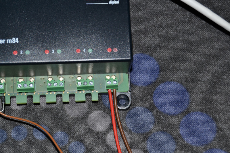

#8 Posted : 26 September 2018 09:01:21(UTC)
Posts: 9,375
I enclose an picture.
You see the wires?
It´s correct connect to the m84.
So that means the left LED flash normal.
if the wires was swapped both LED on the m84 flashes.

Posts: 9,375
The wires are connected correctly, the lights on BOTH units are flashing when they should not.
No the left red LED flashes normal and both unit do it correct.
It´s normal operation.
