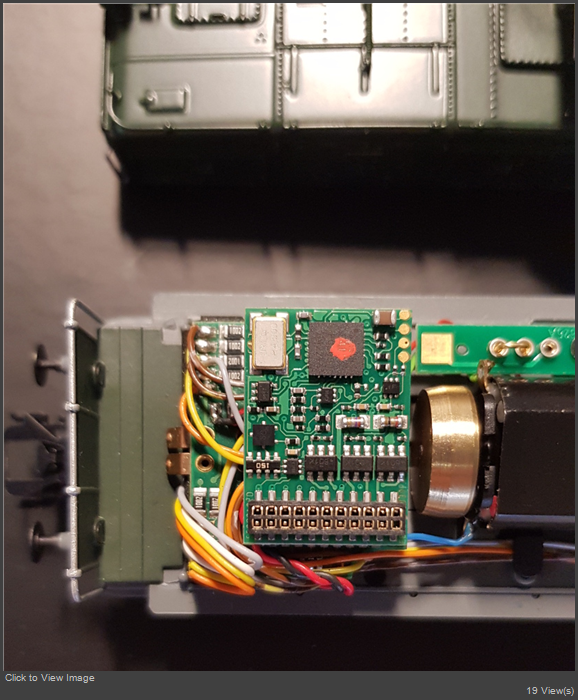

Offline costing
#6 Posted : 21 August 2018 18:20:59(UTC)
costing
Joined: 20/08/2018(UTC)
Posts: 157
Location: Geneve, Geneva
Here is the factory decoder in the 36332. It's actually 23mm long.
.costin
JMRI on RPi & DCC++ / C-track / Marklin, Roco, ESU, Bemo locos / Christmas car collector

I have used quite a few Maerklin mLD decoders for DCC, and as far as I know they are designed to retrofit any Maerklin loco with a 21 pin board.
Your photo of the 36332 shows a 21 pin connection.
Why not phone your local Maerklin dealer and ask about the size and fitting, because that is where you will buy it anyway?
