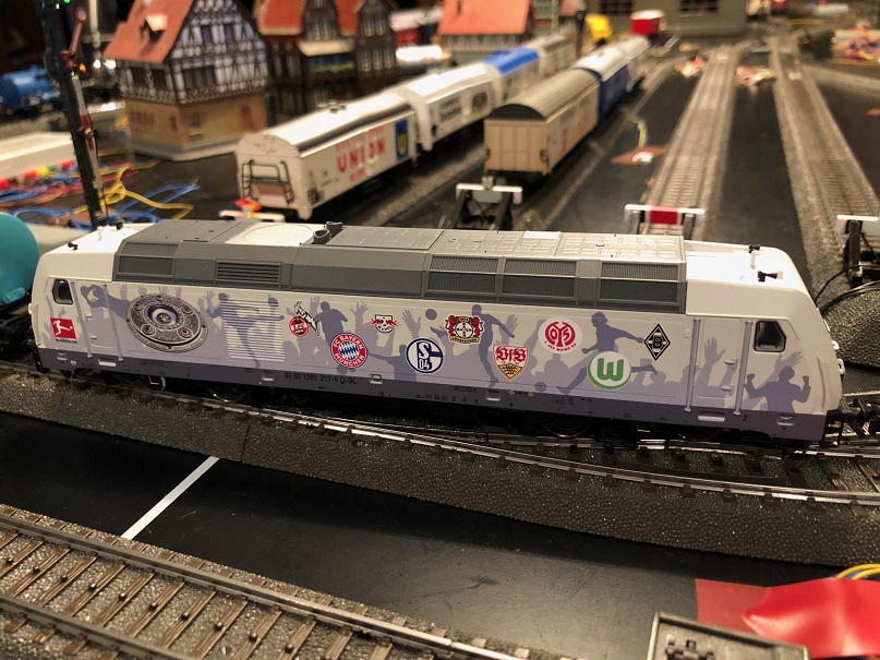

Hi everyone. I am trying to find out if I can add sound files to a Märklin 36655 Diesel Locomotive (2017 is the year I believe). In the description is states it has a MFX sound decoder.
"It has a special motor, an mfx digital decoder, and two sound functions independent of the locomotive's speed."
When I try to access the decoder with the Lokprogrammer it always says that this decoder is not supported. But I can still access the individual CV's and change some of them as well.
This was a birthday gift sent to me from our exchange students family (our 2nd familyBigGrin) in Potsdam, Germany. They totally surprised me when a package from Germany arrives Saturday morning with this inside. she's a beautiful locomotive and a great gift for a Märklin Modeleisenbahn fan and a Fußball fan. Being that it is a mfx decoder I would assume it has more function positions than the 4 positions available:
Function: Headlights
F1 - sound file - Fußball fans cheers
F2 - sound file - Bundesliga theme
F-4 - shunting mode - acceleration & braking delay off
Is it possible to access F3 do you think? Would this be possible with the Märklin 60971 programmer?
I'm not very knowledgeable about the newer Märklin decoders. The Märklin digital decoders I do have are over 10 years old. Most of them have been converted with an ESU Loksound 4 decoder, but I have no knowledge about the new decoders. I just assume that since it is an MFX decoder it must have more function locations available.

here are some links to the item description and manual on Märklin's website as well as a few photos:

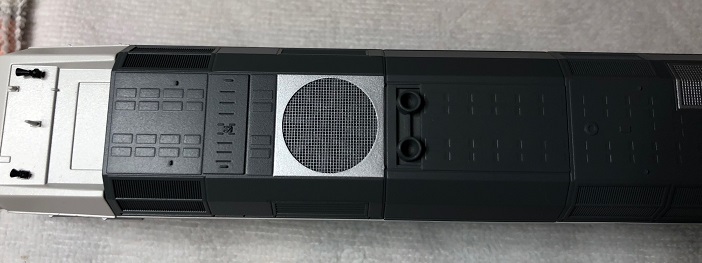

here is picture of the decoder, looks like it would require some soldering....but there is plenty of room for an iphone speaker in here as well.......BigGrin

thanks HO, I think I understand what you are saying now that I look closer at the photos. You can see the F1-F6 labels on the lower chip in the decoder pic above.
Here are some pics of the speaker setup.....the two black speaker wires run to the 2nd decoder chip as well.
