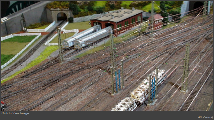

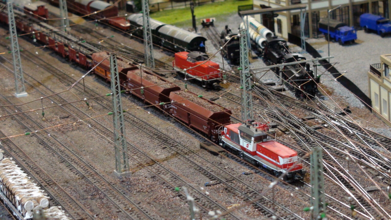

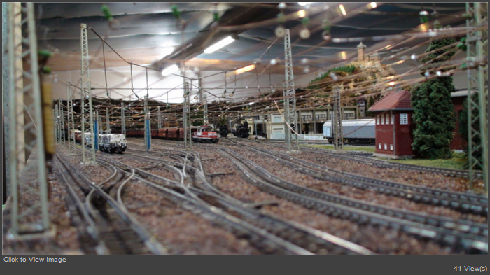

here are some pictures of my recent constructed overhead system

That looks very good. I’m thinking of changing all my old Marklin catenary to sommerfeldt SNCB stuff. As the finer pantographs catch the old style bolts. An it looks better toThumpUp

I think they look too heavy.
A lot of work there!
Dale you're right but the reason I've chosen the thicker wire (0.7mm) is using the pantograph as a power supply the wire 0.3mm didn't have the strength to use the overhead system as a power supply.

It does look a bit chunky, given that you are using thicker wires and doubling up on some places to add mechanical rigidity in the cross span support wiring, etc. But as you mentioned, you need reliable power transfer so providing something less-movable for the pantographs to press against is certainly one way of addressing that power pickup issue. The benefit of the soldered overheads is there should be no transitions that could catch a pantograph in passing and nothing to pop loose of arms, etc.
Not quite, it has to be a 100% clean soldering job (contact wires) as I solder all my wires and construct the overhead system, in a stretch of 500mm there are 5 vertical wires to be soldered, my new method is these vertical wires I bend at both ends to give the overhead more strength and stops breaking in case of an interference from humans. as the wires are 520mm long every end has to be soldered onto the next wire and so on, the same goes for the top wire but has no function as far the running characteristics is concerned, therefore the contact wire has to be absolutely smooth on the bottom surface to avoid any pantograph to catch on it. this is why I clean all the soldering joints after with a Dremel drill accessory tool,.
another crucial point is to have the wire in the right position going from left to right, its not a problem with German pantographs wipers as they are wider then SBB or Austrian wipers and than you have locos which are wobbling from one side to another (I've fixed this by he tightening the housing and bogies (less play),
Over years one learns from the mistakes made in the past and it is now enjoyable to do such a demanding task.
another thing I've found out Sommerfeldt has a 0.5mm wire (previously mentioned a 0.5mm but this should have read 0.3mm) its not copper coated but a grey zinc finish but unfortunately to late as I didn't discover it until recently..
practicality and good looks are not compatible with this type of operation and constructions
the whole set up is rigid but at the same time the tension is slightly flexible
