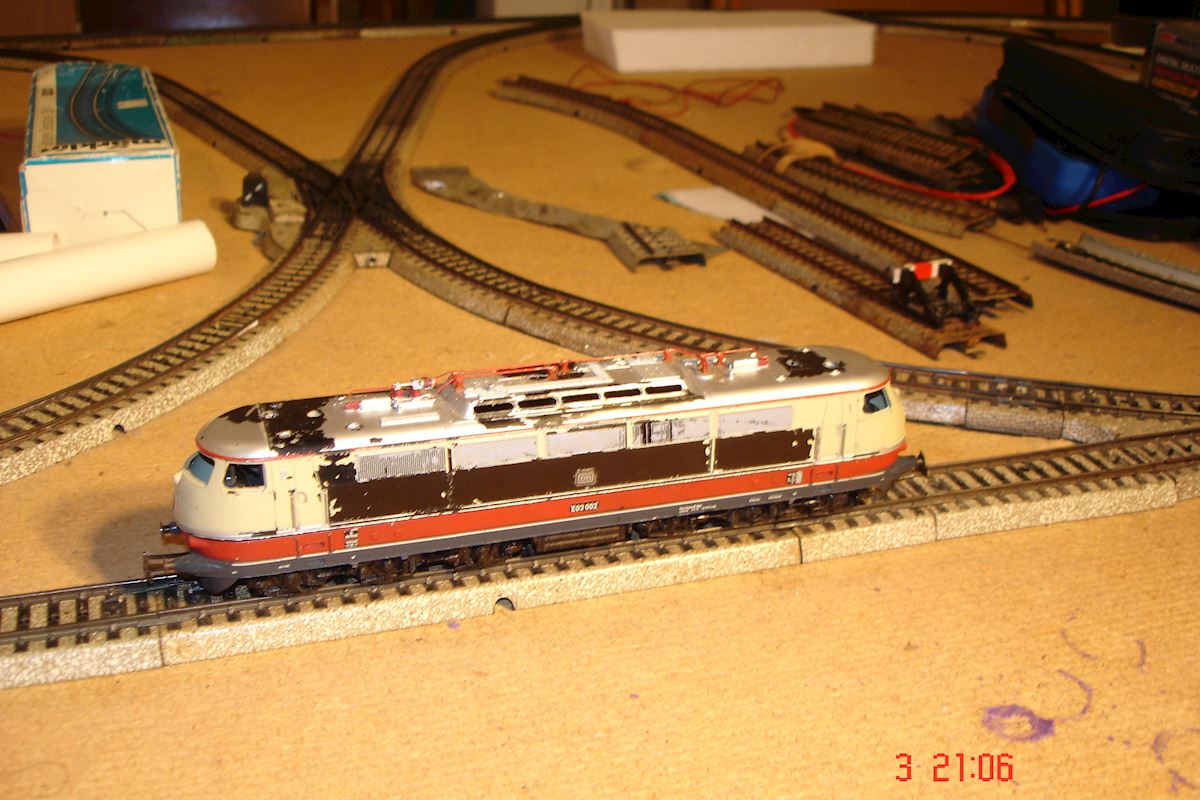

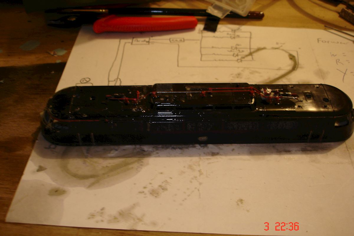

When i was a teenager, i bout the first version of the E03. Every since I bought it, paint started coming off it. Now I have finally got around to removing all the beige and silver paint from the plastic body. Now it is shiny black and I am wondering of maybe i should keep it black. Have had it running on my layout in the black format but without panto-graphs. I think it looks OK. What do others think. The problem with the original paint job probably has something to do with the type of plastic and the fact that it is so shiny. Maybe.

It is hard to comment on questions like this. Personally, so I would never do it like this. I prefer my trains to have an actual prototype. I would trash the model or have someone repaint it. But that is what I prefer. At the end of the day it is your layout and your model. Your idea is just as good as mine.
A hint though: If you decide to keep it black, make sure to protect the plastic by giving it a covering coat of black. Now that its paint is gone the plastic is unprotected from UV lighting which can damage the plastic further.

Now that you've taken all the paint off you've done the hardest bit. Why not finish the job? You need only three colours, red, cream and silver, and the markings on the loco make masking off the different parts fairly easy. The paints don't even need to be an exact match to the originals.
This fine old lady also needs her pantographs back. These are easily obtainable from Marklin for just a few Euros.
I would start by using a grey primer in a spray can from any Auto parts shop. The finishing coats could also be spray painted or even just applied by brush. I have done some repaints in the past that are hardly distinguishable from the original as long as you don't look too closely!

I still have all the bits. Apart from the paint it could have been considered mint.
Thanks everyone for all your comments. I hadn't thought about the uv protection, especially as we have the highest UV here in NZ than anywhere else in the world [ that Ozone hole is right above us or that's what we have been told.]
The original colour was Beige with a silver roof and highlighted by a red stripe around the roof line. The metal under body red paint is still in perfect condition. I had asked Ritter about the painting and they would have done it for me for about 3 times the value of the loco. [ well something like that ]
They mentioned etching or some kind of bead blasting on the plastic before the application of the paint.
I have the spray painting gear to do the job, but i just want to make sure i do it right. I dont think I could live with the black colour but for a while at least, i will enjoy it. The only other model I had a paint problem with was the roof on my old 3065. Years ago i just hand painted the roof and it still looks ok.
I did repaint the roof of my RES800 many years ago. I did it withe a brush but found the silver was too bright, but then I used a suede brush on it and dulled it off to the correct colour. Now it is hard to tell it was repainted.
Thanks for there music TEEWolf. A friend once told me black does tend to be a colour the hides imperfections . Don't the girls look great wearing their tight black clothes though.

Dereck, just try a small section, let it dry and see what happens, maybe you get some advice in a paint shop like a primer.

Hi Dominator,Ask any body shop and they will tell you black is the worst colour to paint because it shows up any imperfections in the bodywork. Eddie Cool

It wasn't as bad as in the picture. The paint had curled inwards at the edges where it was coming loose, and I got pissed off with it so used my fingernail to do what you see in the picture. Brake fluid was really good to get the paint off. I managed to leave the DB signs in tact as those won come loose. I have the necessary air brush to do the work and i have been successfully using Vallejo paints on my aeroplane models. I have been wondering how to do the original paint scheme withe beige sides, silver roof and red highlight stripe between the two. i did consider doing it the same as the 3357 model, but that also has a red stripe on its nose. The one on TM in NZ looks like a repaint, unless the originals were painted by hand.
Automotive stuff is too course for this kind of work, including the masking tape. Is there a fine masking tape that can be used for models that can allow a nice straight clean line between different colours.

Hi Wolfgang. You are correct. I do want to repaint it in original colour if possible. Any help I can get is going to be very well appreciated. I do enjoy running it in the shiny black just fro a change though. I am going to have to convert this loco to digital as well because somewhere there is a breaking wire which stops me running it in reverse. I think it is the coil [ which would be replaced my a magnet ] Pity because it goes so well, but I tend to run a lot of the time now with digital. [ there is a future for you Mike ].

I found it hard to get a good photo of this because of the flash and the shiny black surface.Flapper
