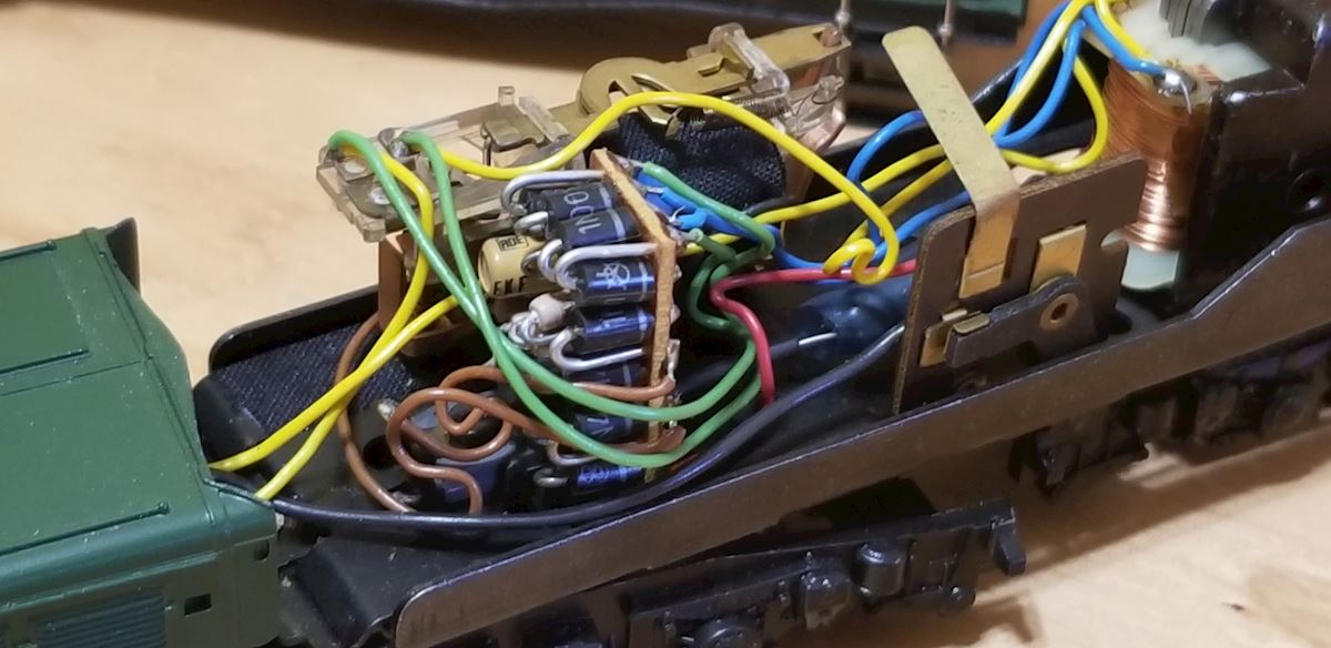

Offline GaryTrooper
#3 Posted : 24 April 2018 17:59:43(UTC)
GaryTrooper
Joined: 26/01/2018(UTC)
Posts: 406
Location: Hailey, Idaho
I can post some tonight.

Offline GaryTrooper
#6 Posted : 25 April 2018 03:31:36(UTC)
GaryTrooper
Posts: 406
Originally Posted by: ktsolias Go to Quoted Post
Originally Posted by: GaryTrooper Go to Quoted Post
Does anyone have the schematic for the electronic module used in the 3322 locomotive. This module seems to be short lived in a production point of view. Any history on the development of the module, and its death to make way for digital would be appreciated.
Thank you,
A photo will help a lot
Costas
G - LGB
HO - Marklin
N - Mix of manufacturers mostly Kato

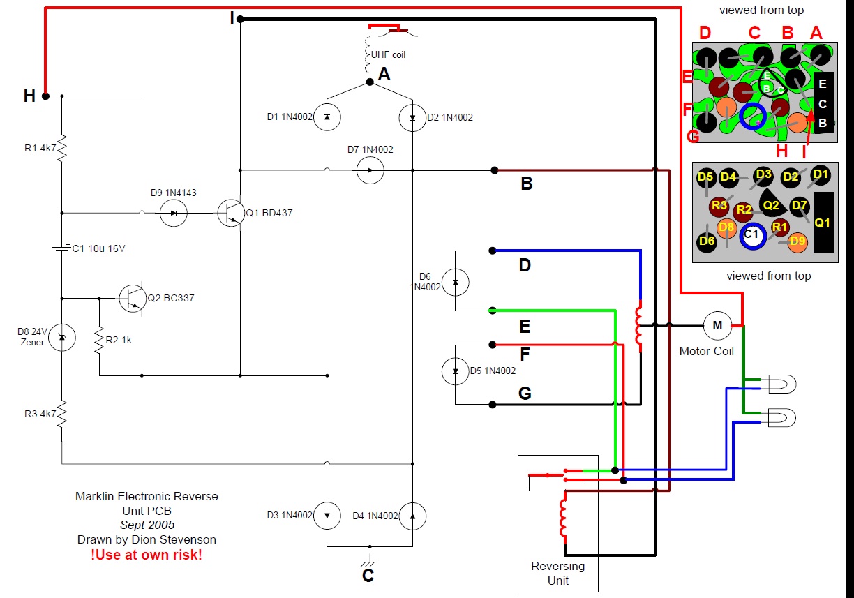

OK Gary
We got the think
Is the old electronic circuit very common in 33xx series which was connected with the universal relay to improve the performance when changing direction.
The plan is the follow
Any way may be is time to update this beauty either with a newer fully electronic reversing unit (there are a lots around and the cost is the mail) or even better to upgrade the loco with the 60944 motor and a modern decoder.
I have done the digital upgrade in a 3022 and in a 3159 and believe me even in analog operation is worth the effort!!!
Costas

There it is! Thanks so much for help Costas.

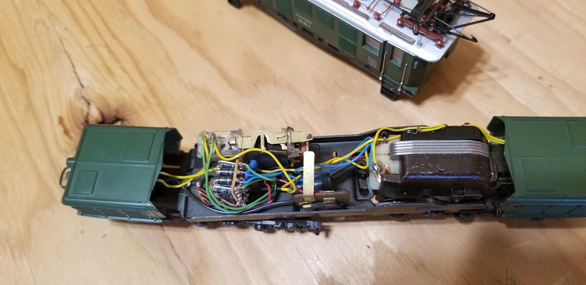

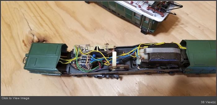

Reverse unit 614860.pdf (47kb) downloaded 38 time(s).
Hi TeeWolf and Garry
This is the photo of the electronic reverse unit 614860. It is missing a capacitor when I applied 16VAC from a Marklin 66470 controller. It basically dropped of the board when it heated up after a few seconds. I connected it to the red and brown wires, nothing else and it started heating up. I will try the search on Google DE for the wiring diagram. The reason I would like to know about the 614860 is that it should be a direct replacement for the old mechanical electro reverse units such as 208240. The part is very expensive more than a MM conversion set, however I would like to get the 614860 working. I will try Marklin Service as well for the diagram. There may be a better electronic reverse in their stores they can suggest.
Bryan
