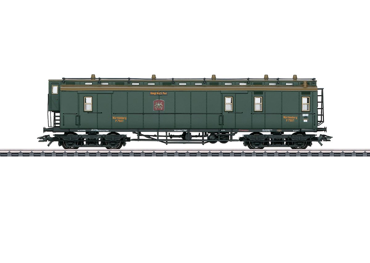

I would like to install the interior lighting (#7333) in the Württemberg style Märklin Mail car. The bogies come with the openings to fit both the slider and the grounding, however, there are no instructions on how to remove the roof or the body on this car.
Has anyone ever done it?
Thanks in advance.

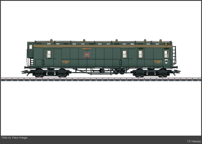

Is the model number available? If it is this one ( https://www.stummiforum.de/viewtopic.php?t=112384 ), then the roof can apparently be clipped off after removal of the handrails at the brakeman's cabin. These handrails seem to be part of the roof assembly.
Thank you for copying the link from the Stummi Forum. The car is part of the 26556 Württemberg train set.

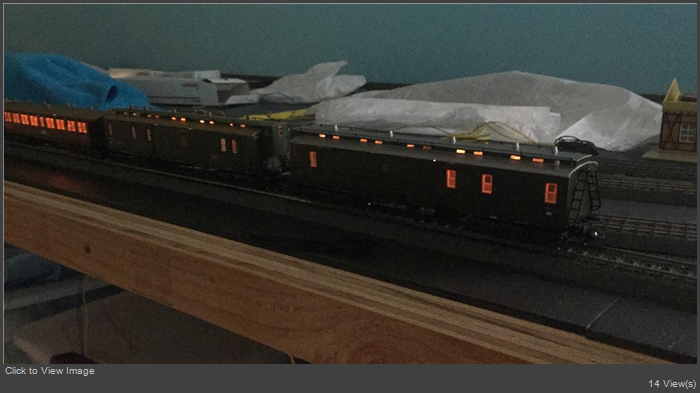

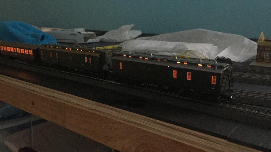

Thank you all for the comments received, and for the links to valuable information.
I was ultimately able to remove the roofs from the Württemberg-style mail cars. It's not so evident. Best is, after removing the handrails, to pry the brakeman's cabin side gently, which will allow the roof to become disengaged.
I exchanged the original analog bulbs included in the 7333 lighting kit for the digital ones (E610080). This reduces both the heat and the intensity that the analog bulbs give off in digital operation and provides a softer, cozier atmosphere.
I will later attempt to incorporate the current conducting couplers into the whole consist, which will require soldering the live cable on both sides of the car.
This is a picture of the final effect:
