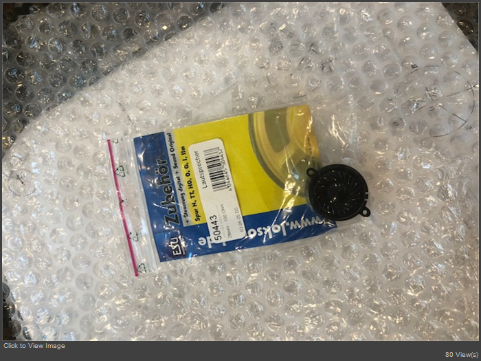

Hi everyone, the sound just quit on a Märklin BR 50 locomotive of mine. It has a Loksound V3.5 mfx decoder with a 28 mm speaker. I reset the decoder and reloaded the sound files with Lokprogrammer with no luck. When I removed the speaker and tapped it while running it on the layout the sound would come back for a second or two but very scratchy and distorted. I assume the speaker went bad. When I looked online the ESU 28mm replacement speakers do not seem to be available. Do you think I can use any 28mm, 100 ohm .5 watt speaker?
AFAIK you need speakers with at least 50 ohms to protect the decoder.
Early Märklin mfx locos often lost sound by overloading the speaker. Later they added a resistor in series with the speaker. If you find a speaker with 50 ohms, maybe add a resistor too. The resistor will also protect the decoder in case the coil in the speaker melts and leads to a short circuit.

one (or 2) question. Does this look like a speaker that would have come with the ESU decoder?
To my untrained eye it looks like it could be the the factory speaker with the Loksound 3.0 Mfx decoder attached. But I could be wrong.
I've only searched for e couple of hours online, but it sure seems (in the U.S.A) that this speaker is no longer available. I saw a few listings in Australia and England. But not much luck here in country.
I wonder if I should bite the bullet and upgrade the decoder and speaker? But this is a lot more that $20-40.......Confused
There are two resistors in the decoder wiring but they are not connected to the speaker wires at all.
anybody have any recommendations or thoughts on a course of action to take?

AFAIK ESU decoders usually come with a 23 mm speaker. I do not think this is the speaker that came with the decoder. I don't know whether this could be a speaker sold by ESU separately.
The 28 mm speaker with 100 ohms is sold out at ESU. Other speakers with 100 ohms are still available and they come with a fitting speaker capsule. I don't know how difficult it will be for you to get one of those speakers.

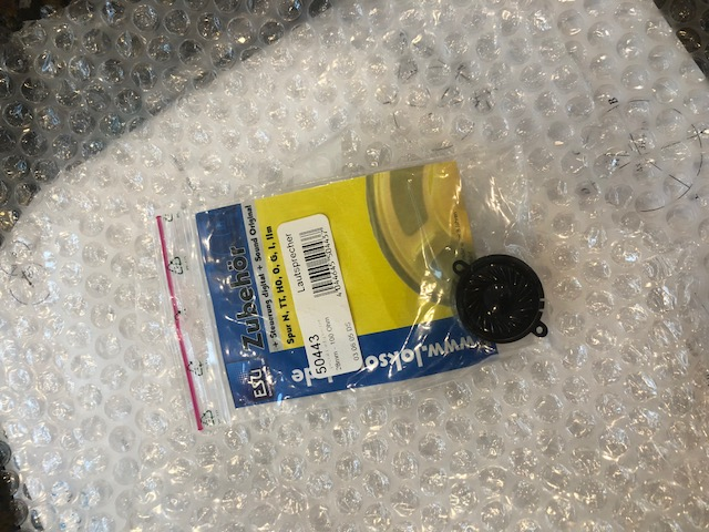

Found this in my spare parts box
If this is the one you are looking for, please send me a PM

I want to thank Bart publicly for helping me an keeping the spirit of this forum alive and well. I could not find this speaker in the US, online, at some Märklin dealers, and a few other model eisenbahn contacts. He sent me the speaker from the Netherlands to South Dakota USA - I can not thank him enough for helping me.

Besten Dank Bart! The Lautsprecher arrived today! BigGrin BigGrin BigGrin BigGrin
