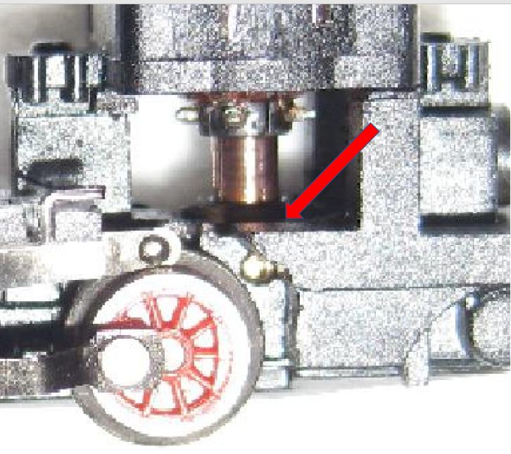

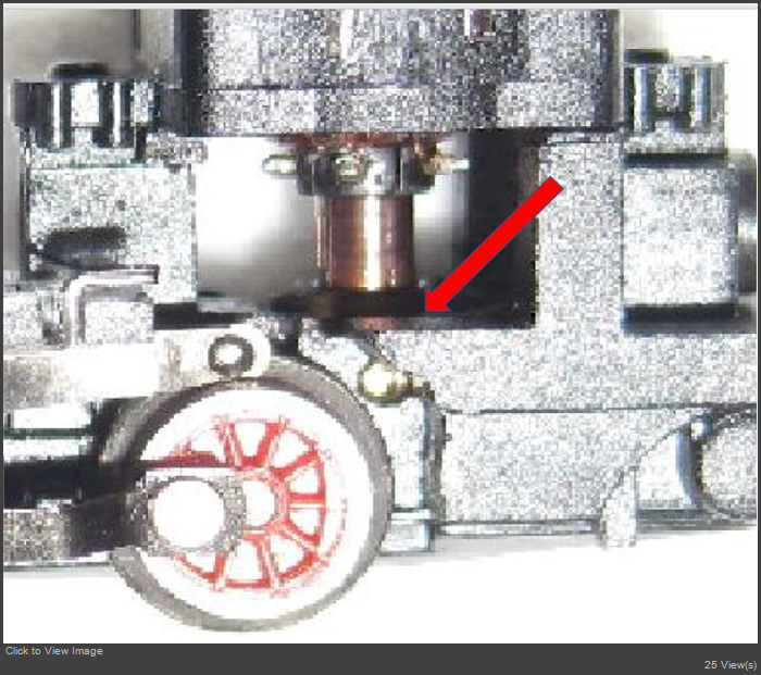

Offline grahame
#5 Posted : 19 February 2018 12:45:13(UTC)
grahame
Joined: 20/12/2013(UTC)
Posts: 141
Location: Houston
btw I do realise in this photo that the wheel contact strip is in front of the wheel when it should be behind..I have corrected that now...
