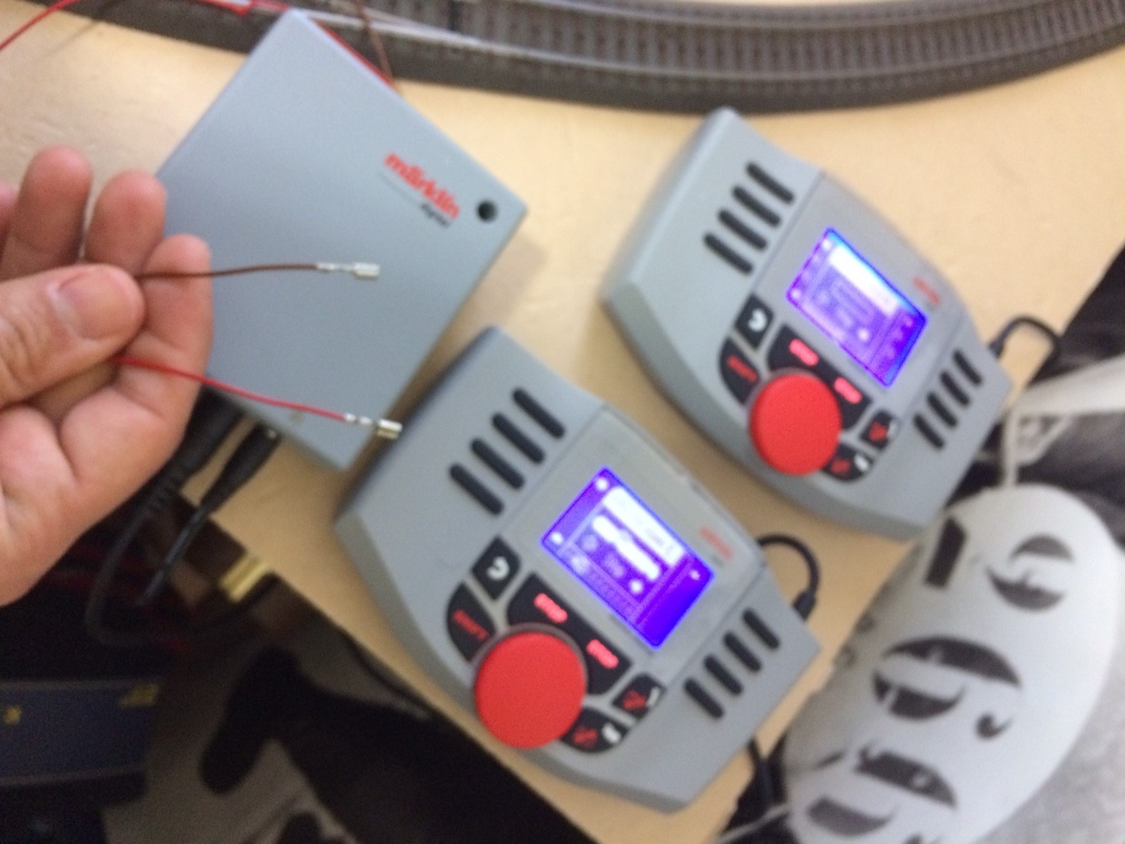

In light of an ECOS failure, I've decided to switch over to my carpetbahn MS2 controllers in order to run my small layout. I have a 60 watt trafo, which meets up with a pair of 60653 MSII's at a 60113 connecting box. While this of course "works", it seems like a very underwhelming solution to put all that power and control through two tiny wires to the track!
Is there a better/high rating way to do this? Or a creative solution? I have a small layout but I still need more than one feeder with to power it! I know Marklin want to push you towards a CS3 but this seems even limiting on a carpetbahn that needs more than one feeder....
And while we are at it, does the MSII software need periodic updating? I'd assume so, and is there a way to do it without a CS? (web/computer perhaps?)
Photo here:
Thoughts?

I don't need a booster, amperage should be fine. But I feel do need more than 1 ~20 gauge feeder for 4x7 feet with 3 trains running and another few parked, most of which are lit with functions. Those two wires might work, but I seriously doubt reliability.
Plan B is make a junction box for feeders, but the whole system still just seems flimsy to me?

An update, my patience got the better of me and I took apart the 60113. I then de-soldered the the original feeder cables, and I replaced them with the fattest pair of wires I could smash/solder in there (I think they are 16 awg). I now feel a bit better about the box and resistance, and have put those two feeders to a pair of 7209 distribution strips for testing.
We should be in (temporary) business. - updates will follow in the layout thread:
