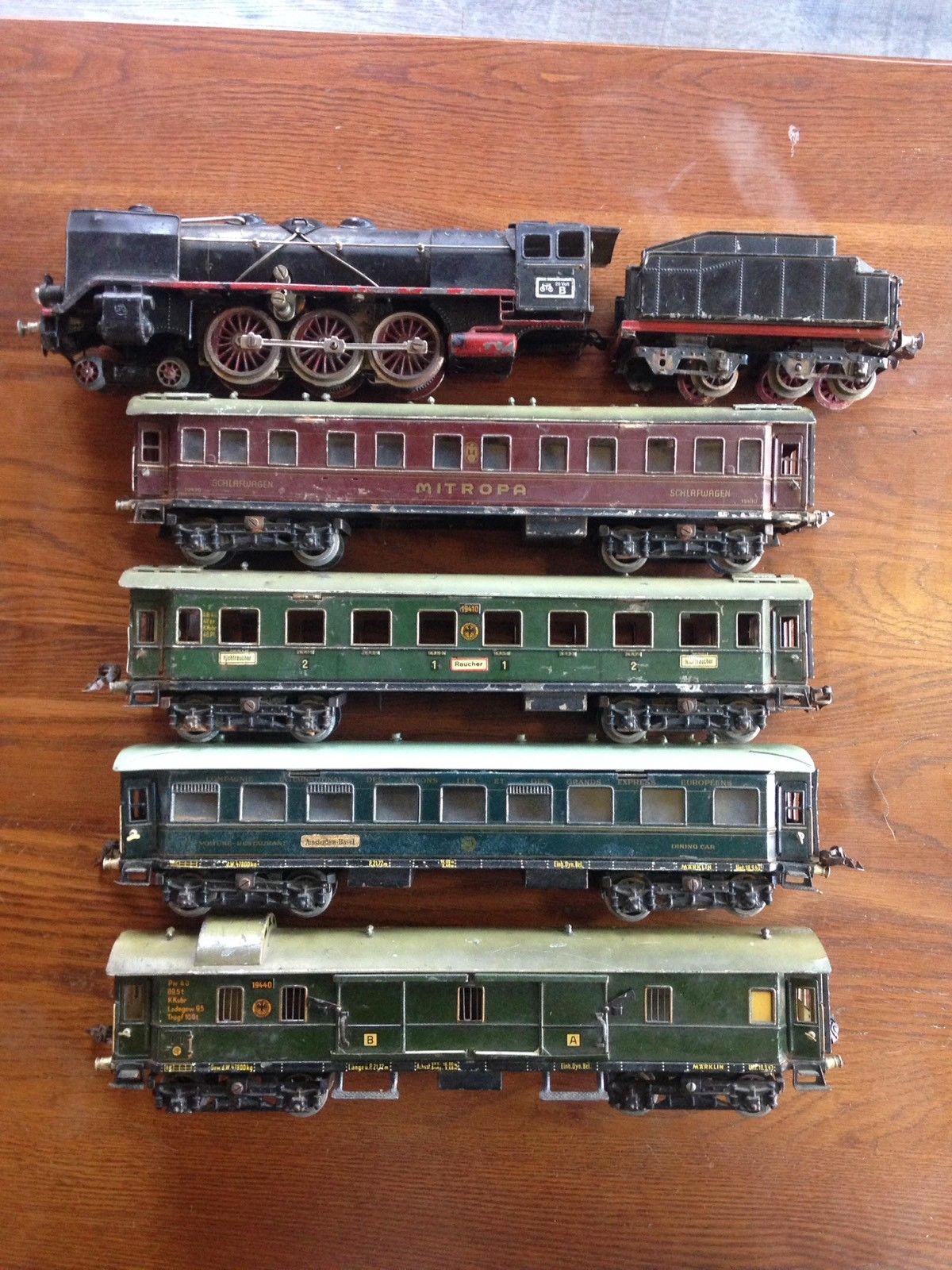

I've had older Marklin ho for quite some time but just recently bought a few Marklin 0 items. That just started rolling downhill very fast when I made a lucky bid and won the HR66 12920 loco and cars. It was not cheap by any means, but it went for less than I thought it might, maybe because it was on ebay over here in the US?? not sure if that had an effect or not. It will need some parts, small loco wheels, trailing truck etc and it will need to be cleaned up a bit. I don't plan on restoring or repainting it, just cleaning waxing polishing and protecting and getting it to run well. I am aware of Ritter for many parts like the wheels so I think that will be ok as well. One thing I am a little curious on is narrowing down the year(s) this was made. I know it was shown in some prewar catalogs and I understand 0 was made postwar as well including these cars and loco I think. I found some comments on line which claimed that prewar 40cm cars had yellow lettering on the black frames of the cars while postwar did not. Does anyone know if that is correct or if it is a good detector of pre versus postwar production? Also, although I have seen a few scans of various prewar catalog pages I have not seen one with this complete train yet and so I am curious to know if the consist matches a cataloged set consist and if so maybe which one? I suspect this set started out all together as it is coming from a part of the US that you would not expect a top line prewar Marklin set to end up. It probably came back with a service man or something like that. Anyway, here is one picture from the auction, I'll post some more in a bit and some better ones once it arrives and I get my grubby little hands on it.

Congratulations - I bid on this set too, I think you got a good price. I would have bid more but I just bought a similar set.
Although Ritter does seem to make quality parts I haven't had any luck in purchasing from them ever.
The yellow letter is true, those were made in the pre-war years. Yours was likely produced partially in 1938/39 and then some of the cars were possibly made in 1944/45 when production began again.

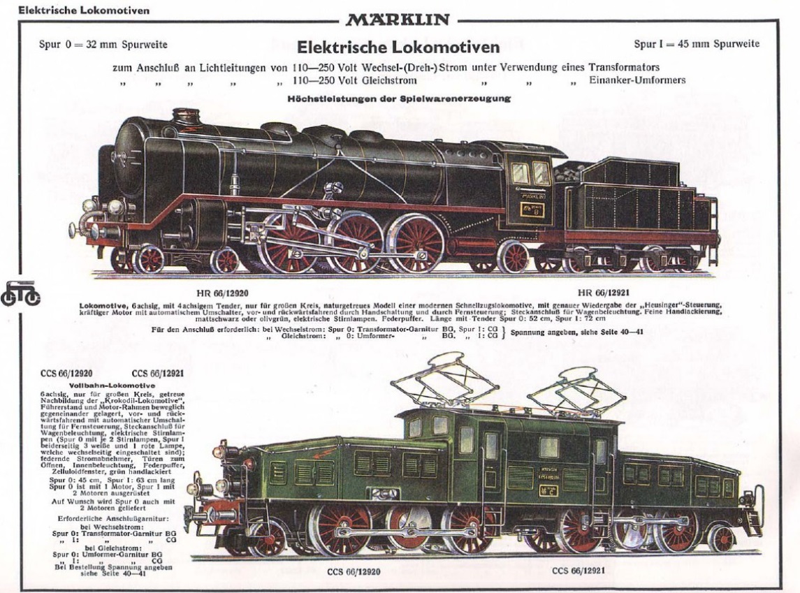

Hi there, Dennis, great score.
The numbering system for that era is quite a mystery, Paul knows it better than me and I think may have an article on decoding the numbers, I know for certain the last digit refers to the gauge, I believe the 4 before that are the Loco model, and the prefix "HR66" relates to technical features, motor type, reverse unit etc - clarify Paul ??
The first catalogue reference I have with the HR66/12920 is in the 1933 catalogue, but is not in the 1931 edition. If there was an issue in 1932 I don't have it but I think you can safely take 1932/1933 as the first years/s of production.
The coaches however do not appear in the 1933 catalogue, in that style.
Here's a couple of catalogue images of the loco (sources acknowledged) :-)
Note here the price of this item, 75.00 (Marks). That was right up there, and for comparison, the cheapest electric 0-gauge loco that same year (R12880) was 9.50 Marks.

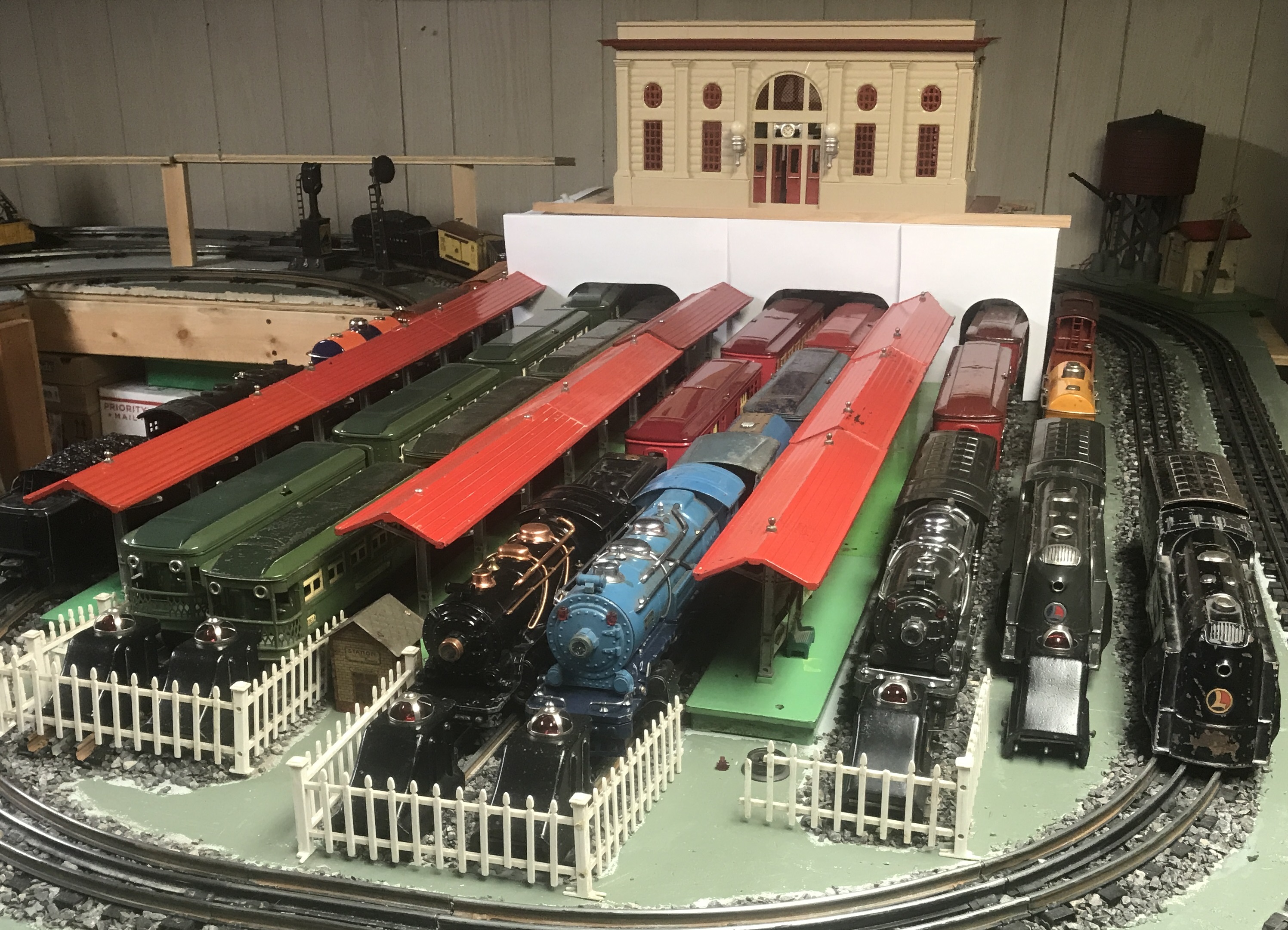

Hi Peter, Thanks for your thoughts. I also have a supply of Gargraves track which is T rail in profile with wooden ties and flexible. Nice track really. Here is a portion of my Lionel layout with some prewar colorful trains. It will be nice to add the HR66 and the JEP SNCF 222 I have coming to the layout.

Very nice Dennis, I don't collect Lionel myself but the Prewar trains are very nice. I particularly like the streamlined Commodore Vanderbilts. Is that an original Blue Comet in the station? As well as Marklin HO I also collect Hornby O gauge, a picture showing some of my locos is attached below.
Gargraves track is nice, although since Marklin locos are fitted with Spoon pickups, not rollers like on Lionel items, you might have some difficulties around points and crossings. Since your layout looks to be fitted with tubular-rail tinplate tracks, you shouldn't have any issues though.

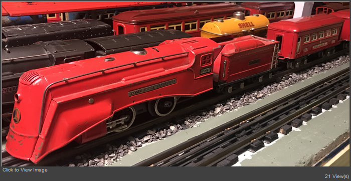

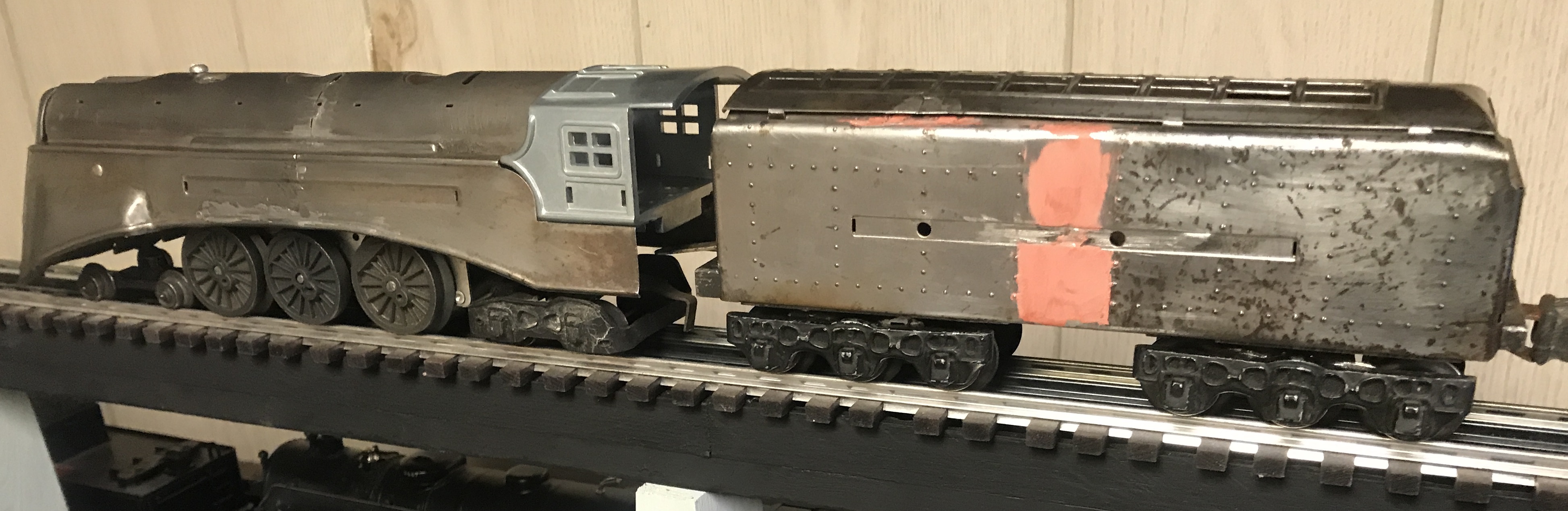

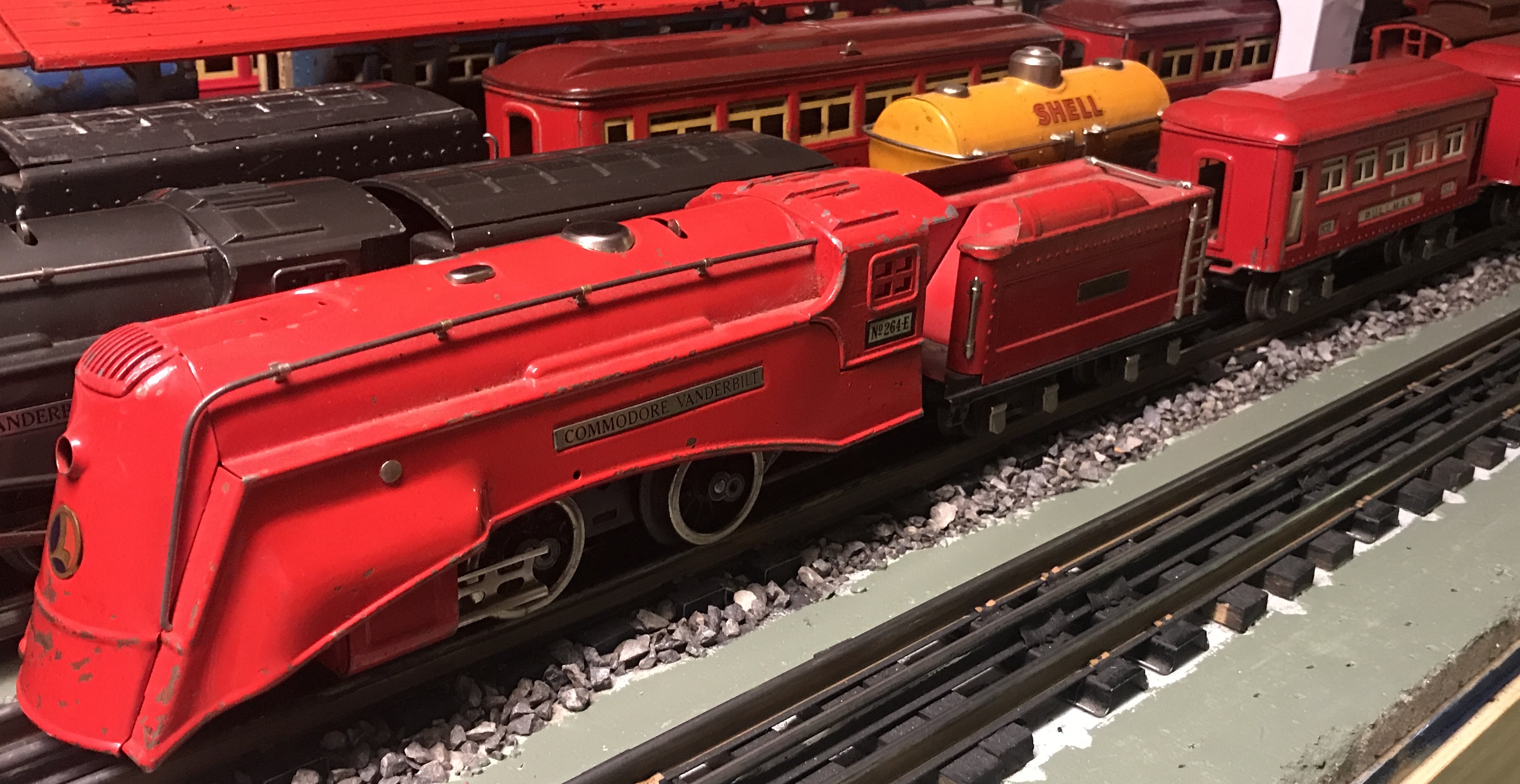

Peter, I can't resist since you mentioned you liked the Commodore Vanderbilts. Here are two. One is the Lionel Red Comet 264E, this one is all original. The second is a custom stretch job I've been working on. I took two 264E shells and two tender shells and spliced them in order to get a real 4-6-4 sized tinplate CV. Actually, the Marklin Prewar CV was my motivation for my 265E stretch project. I still have a ways to go and don't work on it as often as I would like but I think I will be happy with it once it is finally complete.
