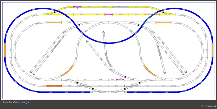

Thanks Markus...I'll keep that in mind...I do seem to remember my previous layout did have that 'Momentary' mixing of the 2 from one circuit to the next across an isolation point with no ill effects...
This diagram is posted elsewhere but I though I'd put it here as well that the item I'm inquiring about can be in clear context...And it really is a small item...But I am trying to do it kind'a right !!!
It's really just my looking at the possibilities of how to best power the back section (Siding) of the Station (Yellow) to be able to have a Full Train just sitting there until it's needed...
As I mentioned I'm leaning towards just powering the Loop & Siding with the 6600 if for no other reason than to not have to regulate the power on a 'Pass' from one circuit to the next...
The 4 'Gray' Feeders are all isolated with the 3 'Yards' being powered by the Transformer controlling the 'Inner Loop'...It is a busy little layout BigGrin
All the isolation points are marked with the 'Black' Spray Paint Dots...Trig
