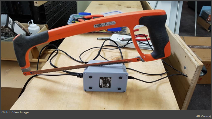

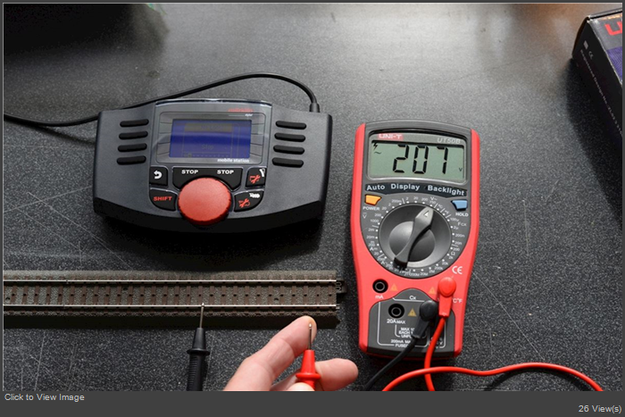

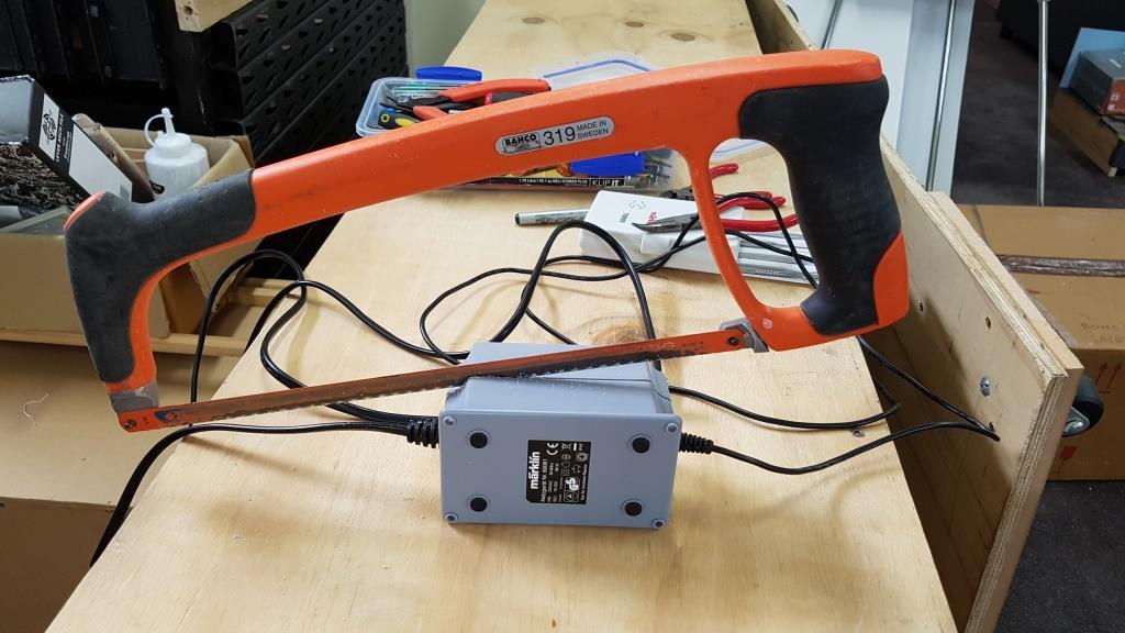

Here we go again. Now also excessive "touch current" observed with newer type power supplies to MS2.
This issue only became apparent for me sometimes after 2017 when I had to replace by power supplies to my old CS2. And last year I bought a brand new MS2 (black) with a power supply from 06/17.
I wonder if Steger (the manufacture for Marklin of their power supplies) have changed their design and gone overboard in their pursue to limit potential EMC (higher Y capacitors will limit EMC but also increase "touch current).
See below photos for test results:
While trying to reset an old MM decoder I used my MS2 on the test bench and got a really nasty shock when accidental touching the rails (was standing bare feet in my garage on concrete floor). I then took my multi meter and measured a voltage potential from outer rail through my body to ground of 207V. Fortunately unable to measure any current (miliamps).
I then rotated the EU plug 180 degree in my NZ power plug adaptor and performed a new measurement. Now hardly any voltage.
Conclusion;
as stated in previous post if you feel a "touch current" from the rails try rotating the power plug (for your switched mode power packs).
I have previously been in contact with Marklin with no avail and wonder if I should try and get hold of Steger directly? The other options would be to try and contact the EU regulatory body who approves these class II power supplies. Knowing Steger is supplying the space industry with components and Marklin previously have been obsessed with EMC/noise I wonder if they have compromised on safety here in pursue of minimising EMC...
Best Regards and safe modelling
Lasse

Originally Posted by: T D Sutton
I would love to see what you find inside the power supplies, in particular how they have configured the drain capacitors. I attempted to open one of my friends supplies, but without doing some serious surgery, I gave up. If it had been my own I would have persevered :-)
From
https://www.marklin-users.net/fo...osts/t39302-Repairing-a-
The only way to get inside the case.....
Well, that and the use of an oscillating tool for the ends of the case
View from top
Circuit board removed from case
Rear side of circuit board
WWW
