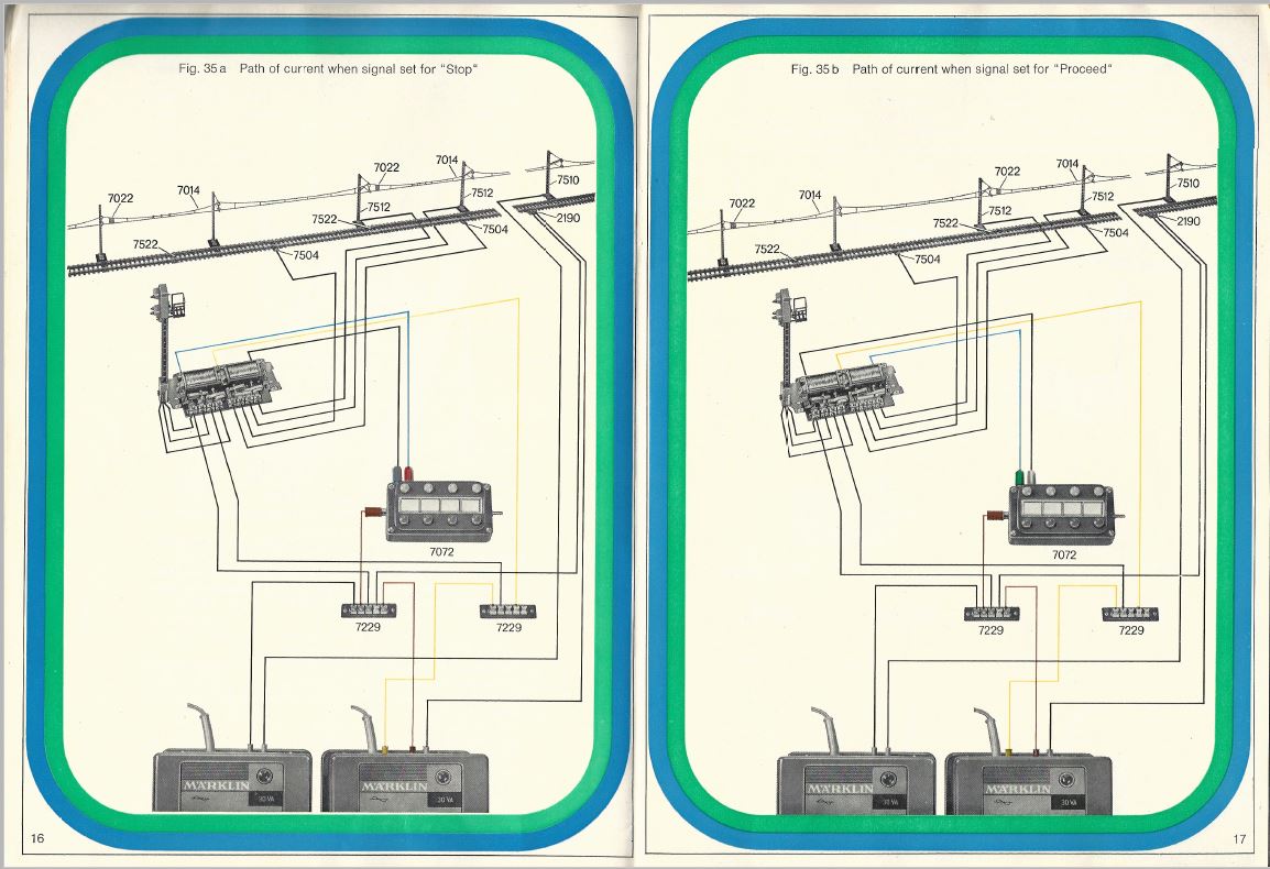

#10 Posted : 02 November 2017 09:09:34(UTC)
I'll dig them out when I get home....
Excerpt from the 0340 Signal manual
Likewise from the 0361 Signal manual
That's strange - a few pages later it says the opposite:
thanks 1 user liked this useful post by Pmare4
Without knowing, I think this writer is confused or the translation wrong.
To me it is very strange to push the green button for STOP and the red for GO.
It should be the other way round, IMHO.
P.S: Orange wire is known to be the best !!! BigGrin
#18 Posted : 02 November 2017 22:25:12(UTC)
Exactly!
