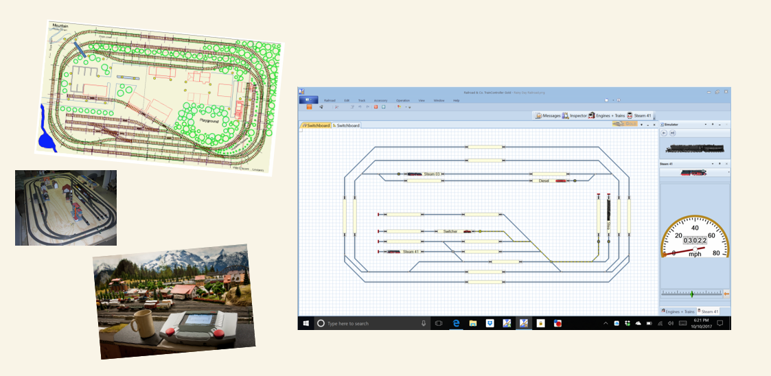

I am a new (2 weeks experience) user of TrainController. In order to go through the learning curve, I am trying to use TrainController to control my small home layout. (See below) So far, I have 5 trains running cycles, shuttles and normal runs perfectly in simulation mode. I have my CS2 connected to my PC using WiFi. The following is connected via addresses through the CS2. Locomotives and locomotive accessories, switches, and block signals. I can't seem to get the s88 signal coming from my circuit tracks through my CS2 to TrainController to track train position. Are there some good references?

Hi ”Rdsmarklin”,
I`m a user of Traincontroller myself but using an ESU ECoS instead of CS2.
To start:
Wihich version of Traincontroller?
Type of tracks? (Looks like Märklin C on the picture)
Type of S88 detection? (Contact tracks or detection by rail)
I handle the S88 signals through The Hi-88 unit from Littfinski. It has a better and quicker response in my opinion.

UPDATE on s88 with CS2 and TrainController
I learned, after much effort, that the Address field in TrainController is set to 0 (zero) for the first s88 module (16 inputs). Then the Input field is the pin number (1-16).
Having done this, everything in TrainController is working ... EXCEPT
I can run one (1) train through a schedule at a time. The CS2, on the CS2 layout display, only shows activation of a single s88 input signal (from a contact track) at a time. If a second loco is on the layout and on a contact track, no s88 input signals are displayed for either loco. On the CS2 an input signal from the s88 shows up as a yellow colored s88 sensor icon on the layout display. On TrainController, a block with a loco shows up red. As indicated above, this only happens when one train is operating.
This seems to be an issue with the CS2, that takes in and processes the raw s88 signals. Is there some setting that is needed to have multiple s88 inputs active and displayed on the CS2 at a time?

Having one (any) sensor work (fairly) reliably but multiple sensors not doing so, is a classic symptom of incomplete return wiring to the s88
With only one sensor triggered, the s88 can infer an induced occupancy even though there may be an aerial
As a 2nd comes into play there is an essential need for solid and correct return wiring to the s88.

Thanks ... after checking in more detail, the grounding connection to the s88 was broken. After re-wiring the BROWN grounding connection all is working as expected !!!
