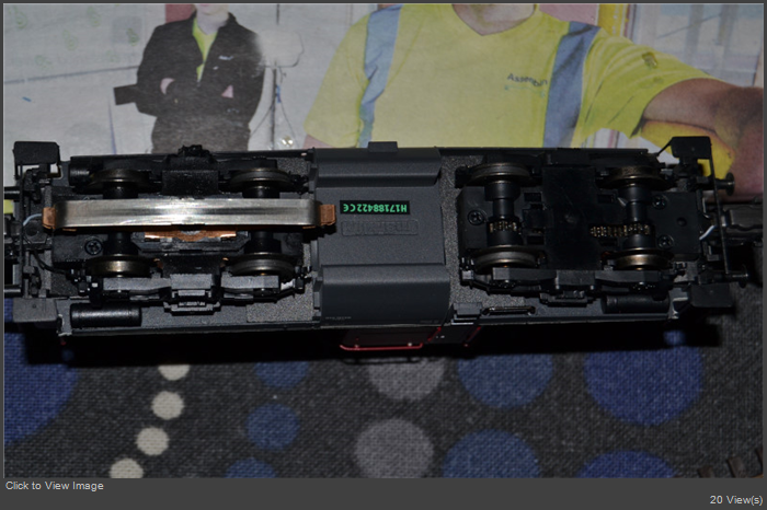

I enclose picture of the 37008 under frame so you see four traction wheels.
That also means the other wheels do only have contact on the rail.
I will try oil axles.

I have had grounding problems with some of my lightweight small locomotives. I added lead plates inside their plastic bodies to get them heavier. This solved those problems, but I assume Anders doesn't want to modify his new locomotive...
As it has four traction tires it's not surprising the grounding to rails can be too bad. I hope Ray's hint of oiling axles helps to solve your problem.
It´s an good point to add the weight but my model 37008 do have metal body.
Only cabinet is made of plastic.
There is four traction tyres and i know it makes bad contact on the track when only two wheels does have contact on the rail.
Not sure if added weight would support this problem.

My suspicion is that the bogie is not making good electrical contact to the main loco chassis, and therefore at certain critical points on the circuit the bogie twists enough to loose electrical contact. My first attempt at fixing the problem would be to run a wire between the bogie and the loco chassis.
