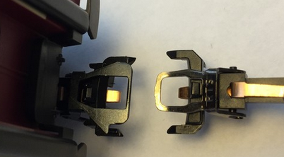

So the current conducting coupler design that Märklin is using appears to have changed based on what is shipping with some models.
The new design on the left, the older RTS sourced design on the right:
Now its been reported on Stummi's that the price of the new Märklin couplers will be an improvement over the older RTS solution as well.
The new couplers being about €1.05 a piece in quantities (buying a box of 50 for 52.50€ from a dealer at MSRP), if we want to replace just the NEM mounted coupler (and already have the other internal ground pickup, wiring, etc in place)
If these new couplers also work better on electric uncoupling tracks its a win-win. Then I just need to wait on the updated conducting-coupler kits that include the pickups/wiring/etc to feature the new coupler.

#2 Posted : 09 October 2017 13:42:38(UTC)
Good news!
I use a lot of these...will switch to the new one, after I run out of my last supply of 100 pieces purchased from RTSSmile Wink
I usually keep consists as a whole, and fitting non conductive ones (now always the ROCO universal # 40397) at the tail/head ends to couple to the locos.

Can you use these couplers in place of the ones they gave the 4228 Rheinegold set and if modifications have to be done if you do? Fred
#4 Posted : 09 October 2017 17:05:56(UTC)
Posts: 14,916
I'll be using ESU conductive couplers with 2 contacts. (red & brown) especially for consists using the track contact and the overhead wire contact, could also be used for interior lights
#5 Posted : 09 October 2017 19:06:06(UTC)
Posts: 2,323
If the plug-in style (based on 4228 description) has 2 conductors in the coupling, then no, because these current conducting couplers only have one conductor - the main power, while one is expected to add a ground pickup from the wheelset in each car.
Though the parts list for those cars suggests a replacement coupling is a plain 7203 RTS coupling, and that would indicate yes.

I must say that I have never had those old M CCC with the rigid bar working 100%, the 4228 set has always been flickering...
Could of course a wheel grounding issue too, or the coupler pocket to circuit board contact as well...
Have to order a pack of 50 of these to see if there is any difference compared to the older coupler bars...
If memory serves me right the 4228 couplers are slightly shorter than the regular fixed current conducting couplings. So if you use these new couplers on the 4228 the gap between coaches will be somewhat larger.
The gap between the coaches will be larger.
This picture shows the 4228 standard drawbar at the front track and the 7205 standard couplers on the rear track (the power conducting couplers should have about the same gap).
No modification needed if you do not mind the gap.
I just installed them on my 4228 set and there is way less flickering and derailments. I believe the close distance between the cars was a cause of derailments on some of my sharper curves.

Originally Posted by: sudibarba Go to Quoted Post
marklin part # ?
Marklin 72020 and there is two per box and I used four boxes for the Rheinegold set. There are extra parts to retrofit other cars but you do not need them.

72020 is AFAIK the number for the old style of conducting couplers, not the new style discussed in this thread.
Yes Tom, that is correct. The 72020 contain the same style couplers that have come on Märklin coach sets for some time now. My Orient Express coaches and my Rheingold coaches both came with them from the factory along with a backup set of rigid couplers.
The new ones are slightly different, as I saw in the pictures posted in another forum thread, which I can't currently locate. I assume that my Parsifal Insider coaches will have the new ones, although those coaches have yet to arrive. If I remember correctly reviews were mostly positive with just a few issues - wish I could find that thread. Confused
