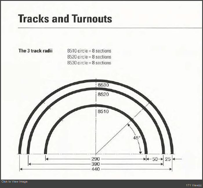

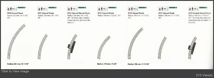

#2 Posted : 09 September 2017 00:05:17(UTC)
From the latest Marklin Yearbook, this is the details of the Z Gauge curves.
The smallest has a diameter of 290mm.
These are the actual curve pieces.
#3 Posted : 09 September 2017 00:11:39(UTC)
Originally Posted by: darticus Go to Quoted Post
The inside of my track oval is 15.25 inches and I want to put a figure 8 inside it.
Which suggests you have the 852x series 195mm radius curves.
You could try 8510 / 145mm radius curves, but I have no experience with them, so can't comment as to how well stuff will run on them.
