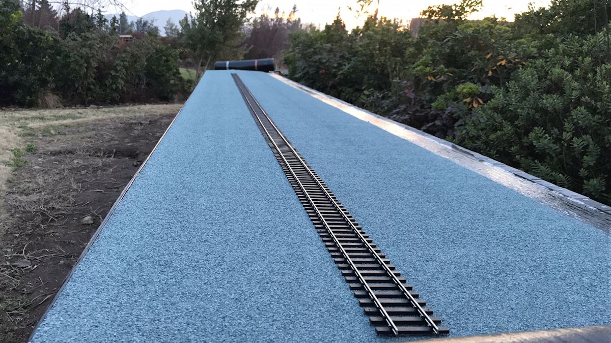

Hello
The last week I put the first Peco track in my garden layout, there was a rainy day. Today the track lost its luster and there is a grey particles on its surface. Is it necessary to clean? Or there are no problems of electrical conductivity. If there is to be cleaned, which is the best method?
Thank you
Jaime
Note: this picture is day 1, no oxidation yet.

I think the grey particles you see is dust, washed down by the rain.
Wipe / polish a little with a rag, and it should be gone.
In a few years, the tracks will oxidate and turn into a more brown ( and nice prototypical ) color.
Then you might need to use a little of a polishing agent like Brasso to get the top surface of the tracks clean.
https://en.wikipedia.org/wiki/Brasso
After the Brasso, you might need to wash the remains of the Brasso of.
Do NOT use sandpaper etc., since you will grind tiny lines in the surface, which will make dirt stick better to the tracks.
Cleaning is always good. BigGrin
