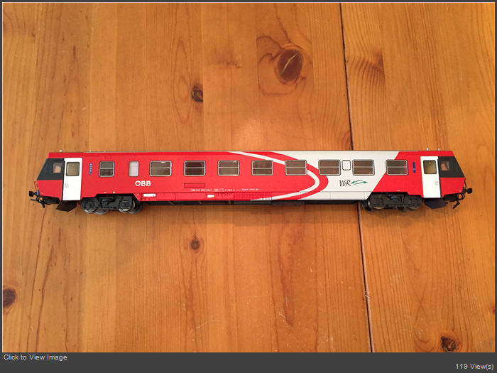

This review is for the HO scale Rivarossi HR2374 ÖBB Class 5047 diesel railcar in gray / red livery with running number 5047 090-5, named Manfred.

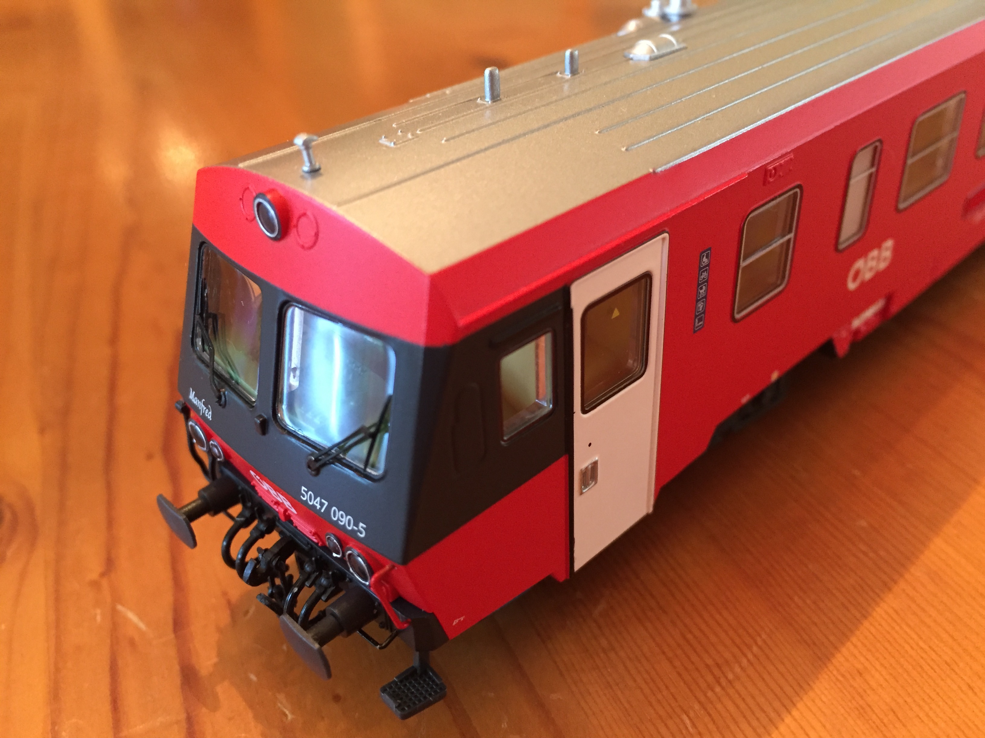

Roof detail is minimal but present - some light weathering would make the details pop. Painting is, as with most modern locomotives, excellent with no overspray. Color demarcations and lettering are crisp and readable.

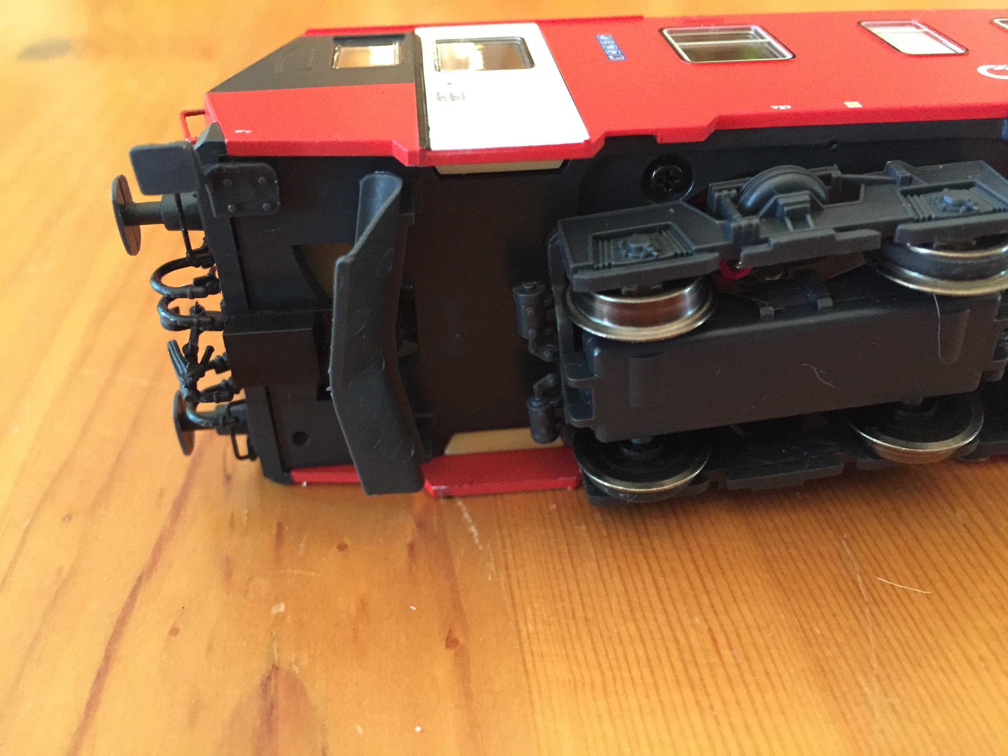

Underbody detailing is present but minimal. Trucks have minimal detail but are mostly hidden. The cab ends are well detailed including windshield wipers and non-functional buffers. I'll let the pics speak for themselves.

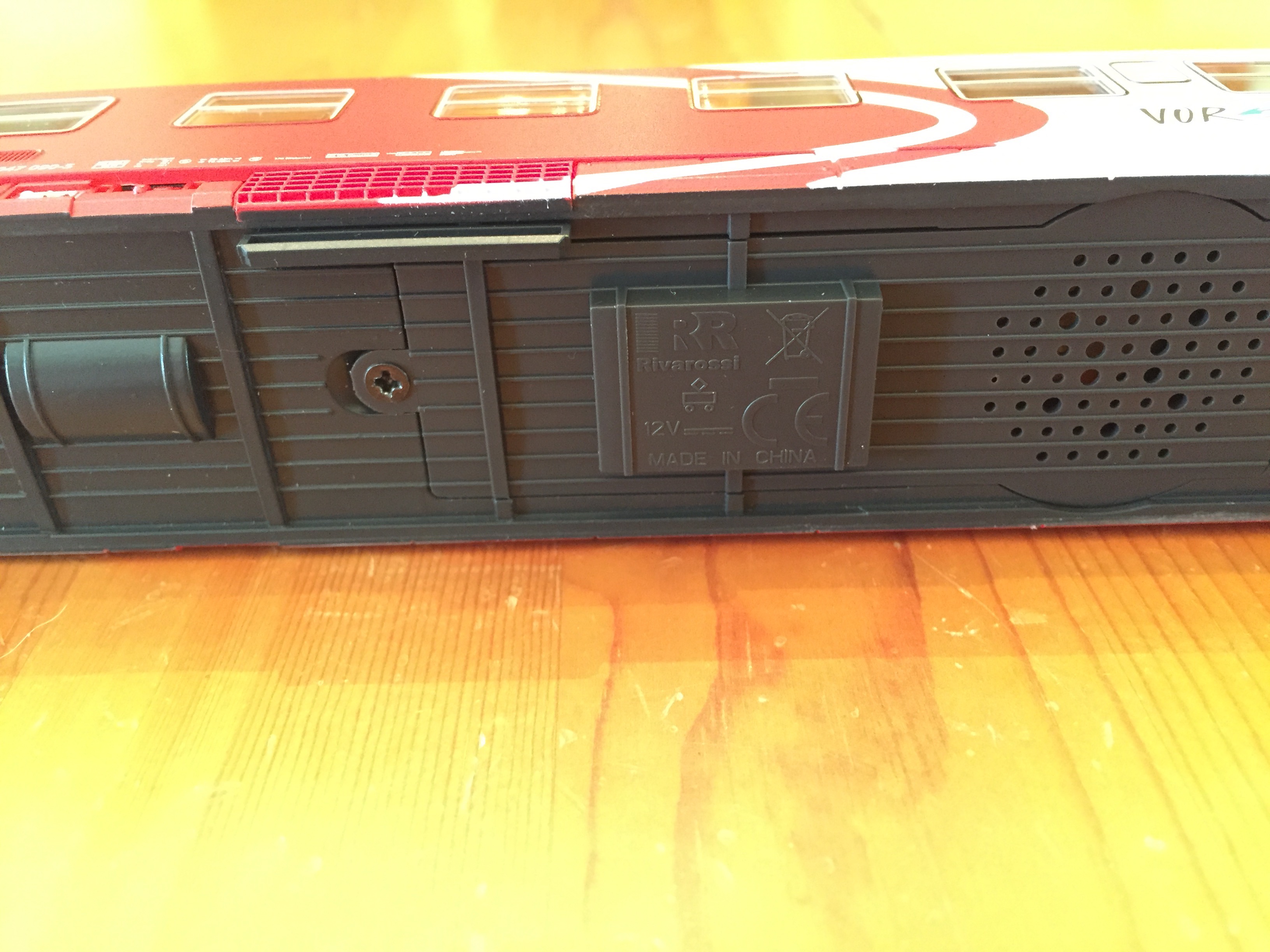

The 5047 is digital ready with a 21-pin (MTC) interface. The decoder and speaker are easily accessible through a hatch on the bottom of the railcar. I installed an ESU LokPilot decoder, and the railcar runs well if a bit stiffly. I need to give it some more time for break-in, and I have not yet tuned the decoder’s motor parameters. Both should smooth out the stop/start a bit – I’ll update the review later once I’ve had time to accomplish this.

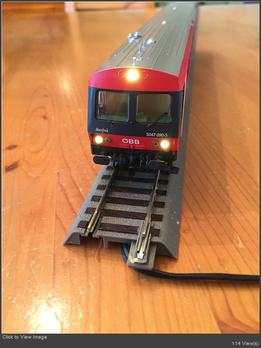

The railcar has the standard 3xwhite front /2xred rear lights with the front lights on F0 and the red lights separate on F2.
