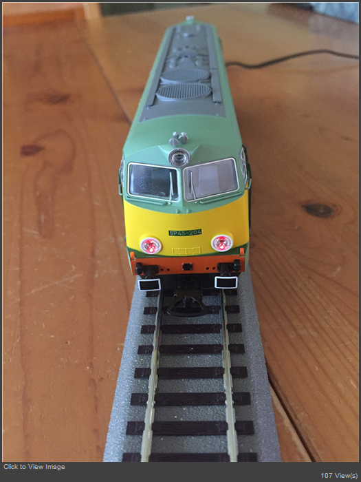

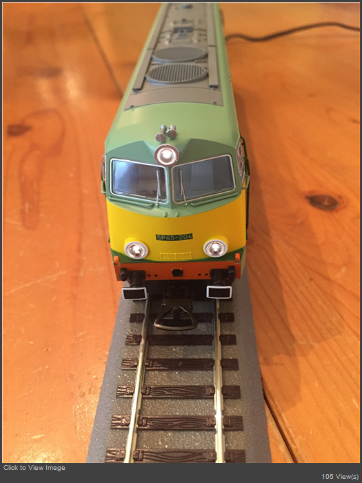

This review is for the Piko 96300 SP45 PKP diesel locomotive. This locomotive is in the Piko Expert Locomotive line and took 3rd place for the 2017 Das Goldene Gleis award.
UP CLOSE:

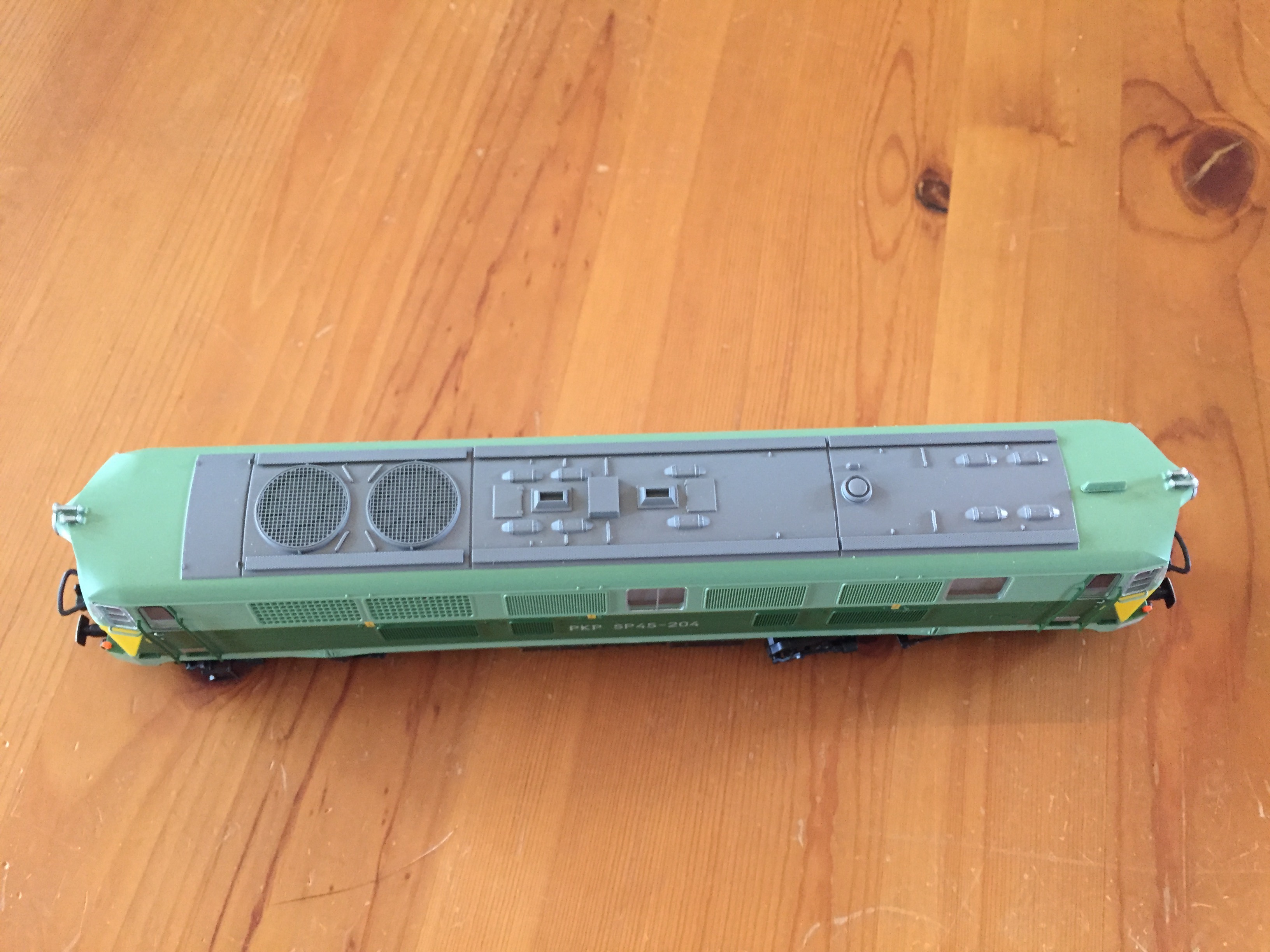

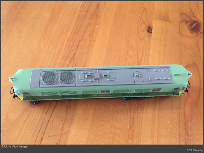

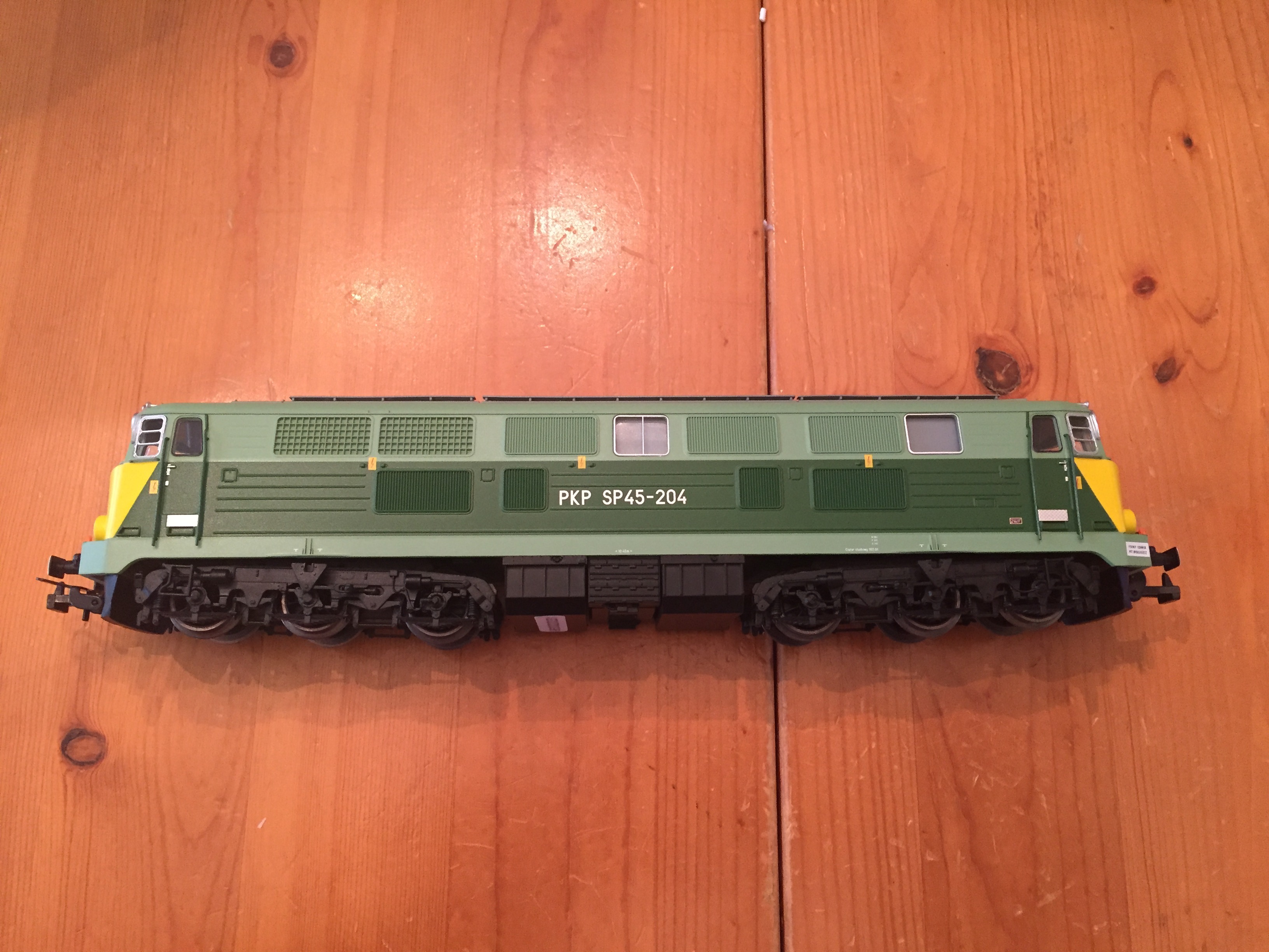

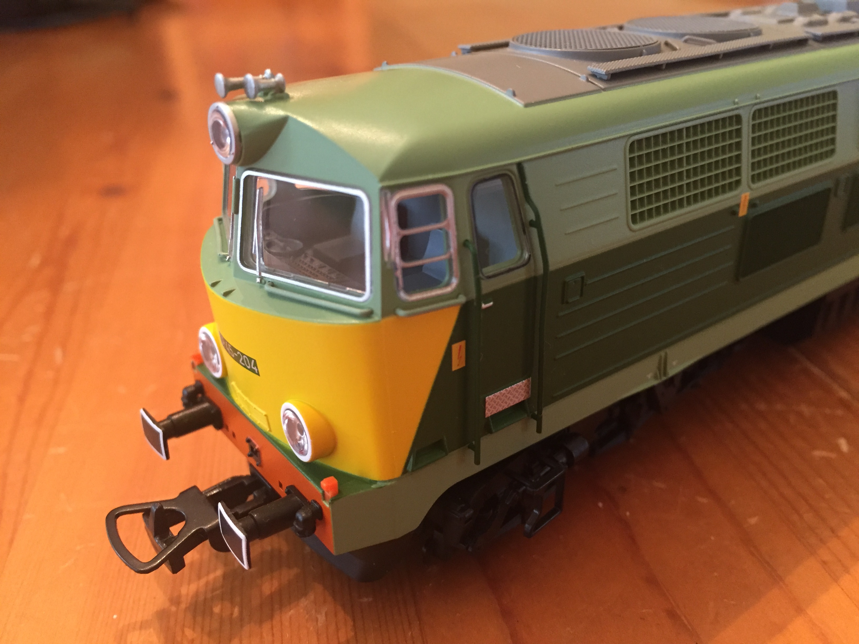

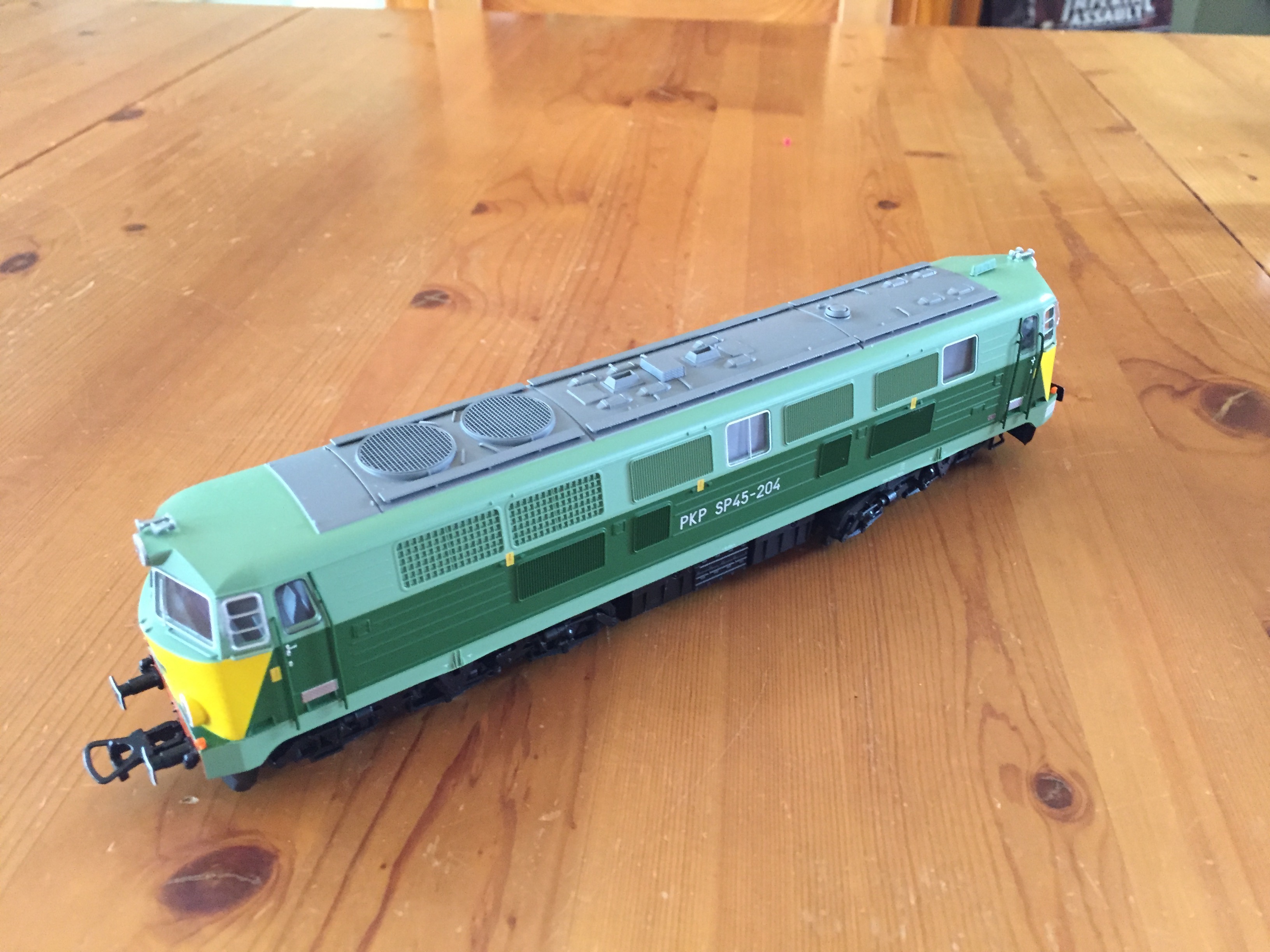

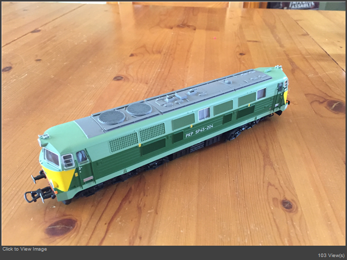

Pike produced the SP45 in multiple paint schemes - the 96300 item is two toned green with yellow bibs on each end. The roof is light gray with two large fans visible beneath grating. The remainder of the roof detail is crisp including two exhaust stacks, grab irons, a blade antenna, and horns on both ends. I love the look of the sides with the multiple panels and grates - this loco will be fun to weather! Lettering is simple but crisp. Overall the paint job os great - color separations are clean, and numerous small markings are present.

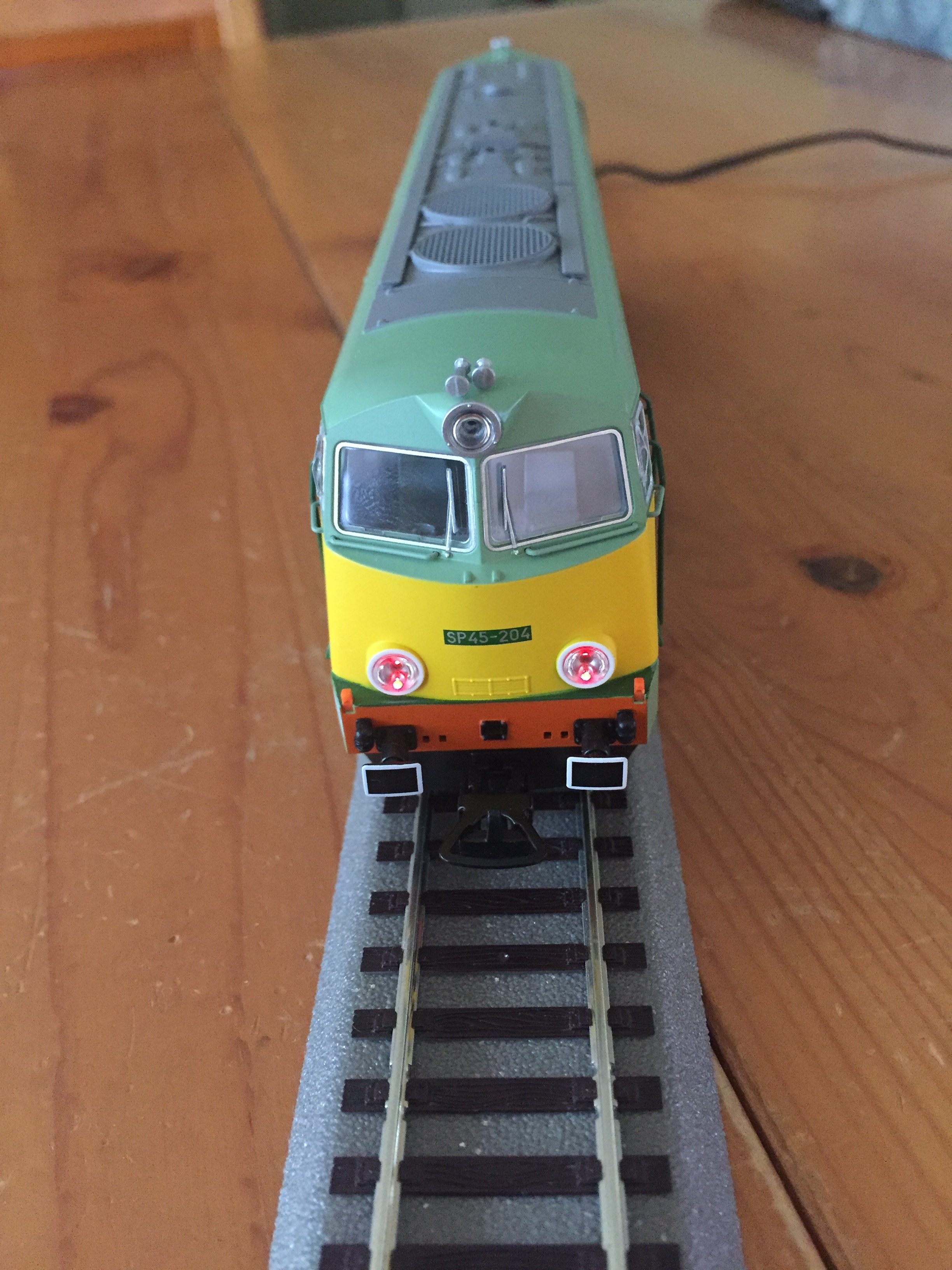

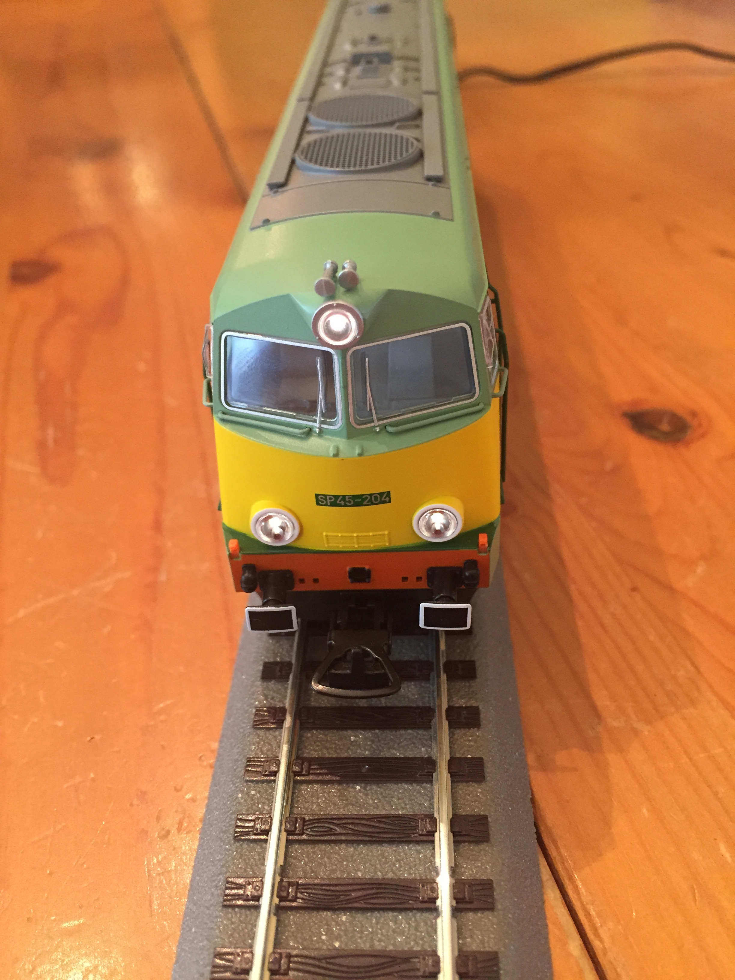

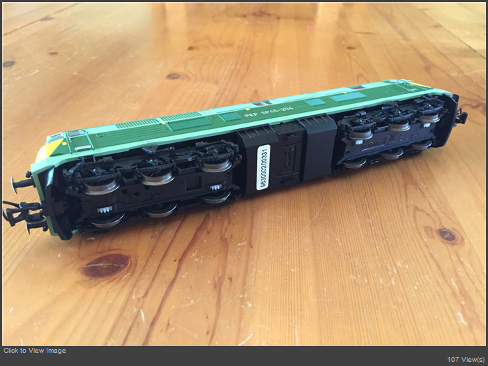

Buffers are non-functional, and the standard display case air hoses are included. The cab interiors are included - I need to install a driver since there is directional cab lighting (see below). The details on the ends include the head lights (see below) and windshield wipers. The trucks are fairly well detailed, and the only other underbody details are the large fuel tanks.
DIGITAL:
The locomotive includes a PluX22 decoder socket with analog plug. The body shell detaches with minimal fuss. I removed the plug and installed an ESU LokPilot 4.0 decoder. I had to fiddle with the decoder settings a bit since I could not locate the function mapping for this locomotive. It does have the standard 3xwhite front / 2xred rear lighting setup on the light key. AUX3 and AUX4 decoder outputs control the cab lighting, and I assigned these to a separate function key (Aux3 fwd, Aux4 reverse) so I could turn cab lights on independent of the headlights. The locomotive runs very well after a touch up of lubrication and a 20 minute break in.

The SP45 is digital ready and so far only appears available in the 2-rail version reviewed here. I have converted an SP45 to 3-rail (for my dad)by adding a pickup shoe and re-routing the pickup wires. His has sound and looks and runs great!
