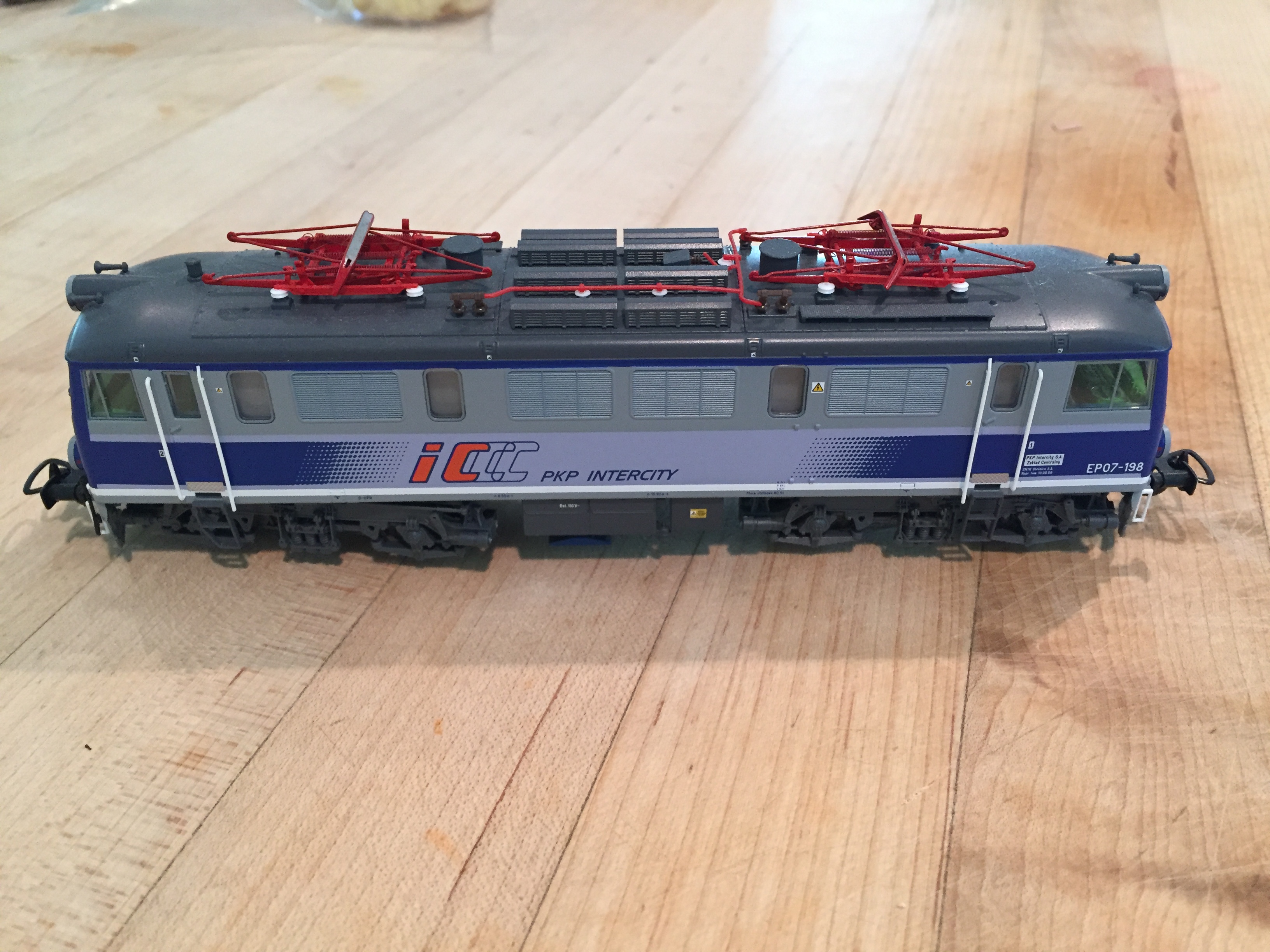

Piko PKP EP07 electric loco - being converted

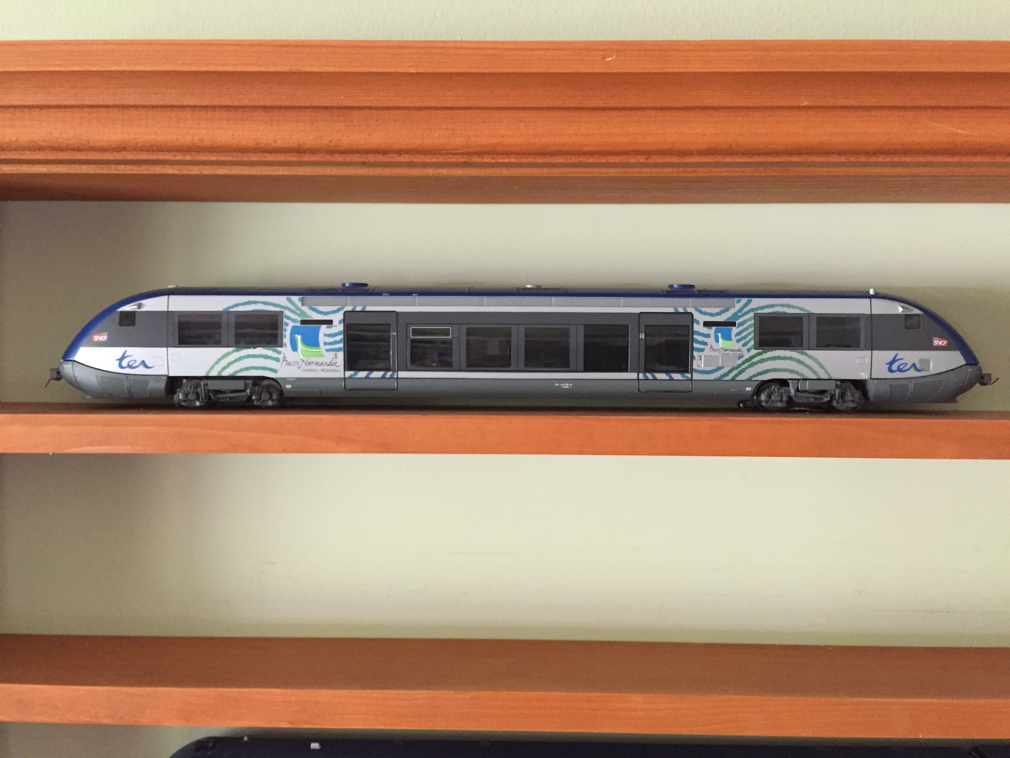

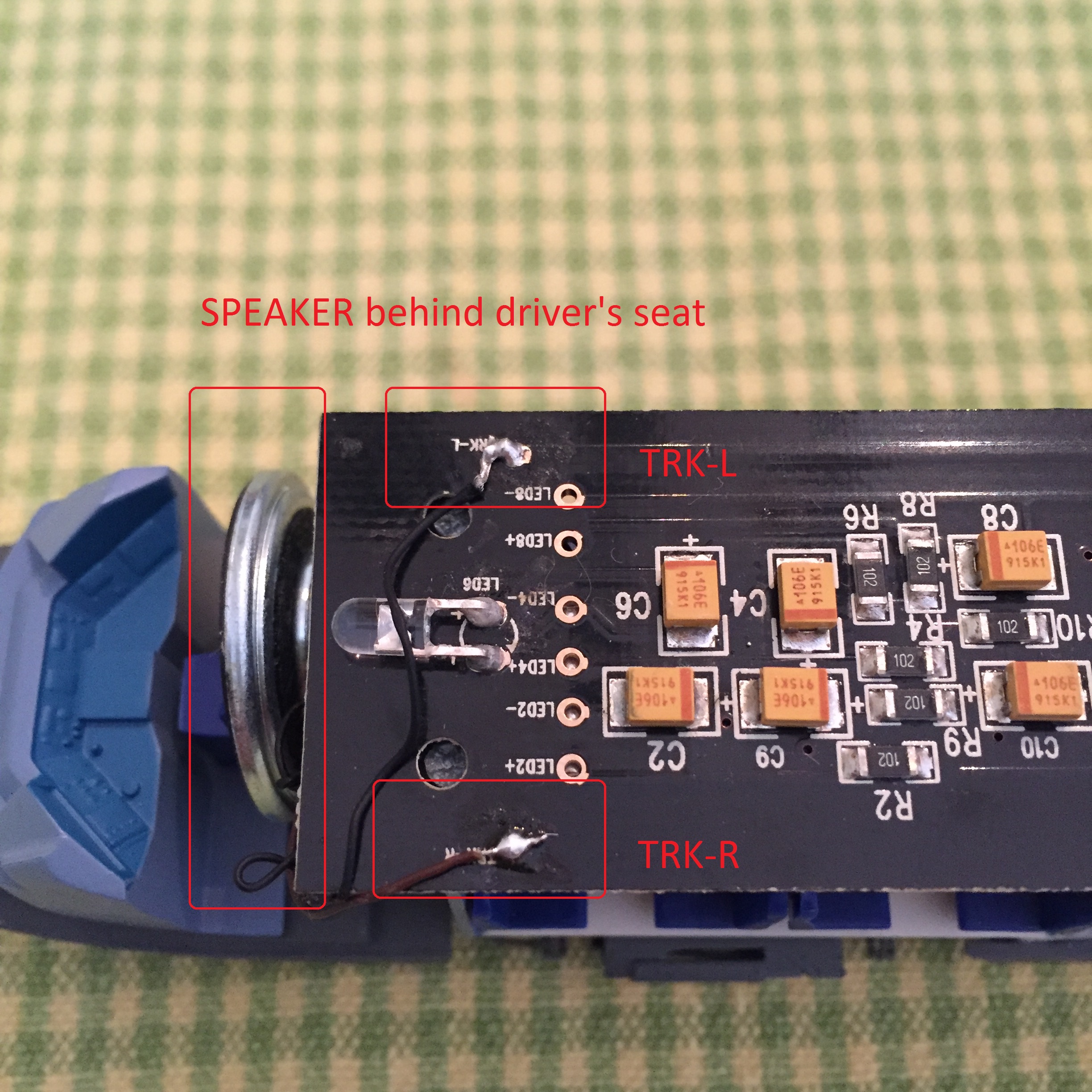

Jouef X73500 Diesel Railcar conversion
I have 3 of these great looking railcars, and the conversion from 2 rail to 3 rail is very simple. Here's a pic of a short Marklin slider mounted on the rear bogey. I removed the insulator section from the slider to give it a bit more vertical movement. I've had good results with both CA and epoxy in attaching the slider. As with all sliders, ensure the slider is centered and straight (aligned with the long axis of the loco). Misalignment can easily cause power dropouts. Also ensure the slider does not bump the wheels or body - vertical movement should be unhindered. I keep a box of various sliders to see which is the best fit for the application.
Remove the two screws holding the PCB in place, and put them in a safe place. Using a hobby knife, slice the plastic nubs holding the other end of the PCB horizontally to free the PCB. The PCB will come free – you may have to unwind the black wires a bit to get some slack.
The right wheels are connected to the PCB at the points marked TRK-R. Unsolder these connections, and solder the wires to the respective left wheel connection points (TRK=L). Now run the pickup shoe connection wire up through the hole in the bogey and solder to the (now unconnected) rear right wheel PCB connection (TRK-R).
I also had to trim one of the seats to allow the decoder to sit horizontal. In this railcar, I installed a sound decoder with the speaker tucked in behind the driver's seat.
Reattach the PCB with the two screws removed at the beginning. Before reattaching the body shell, test the unit on your programming track to verify operation and assign an address. Note: if using a LokSound decoder, you will need to assign AUX1 to an available function key to access the interior lighting. Don’t forget to write any changes to the decoder!
Now is also the time to add any scale size passengers prior to reinstalling the body shell. Your X73500 railcar is now ready for 3 rail operation!

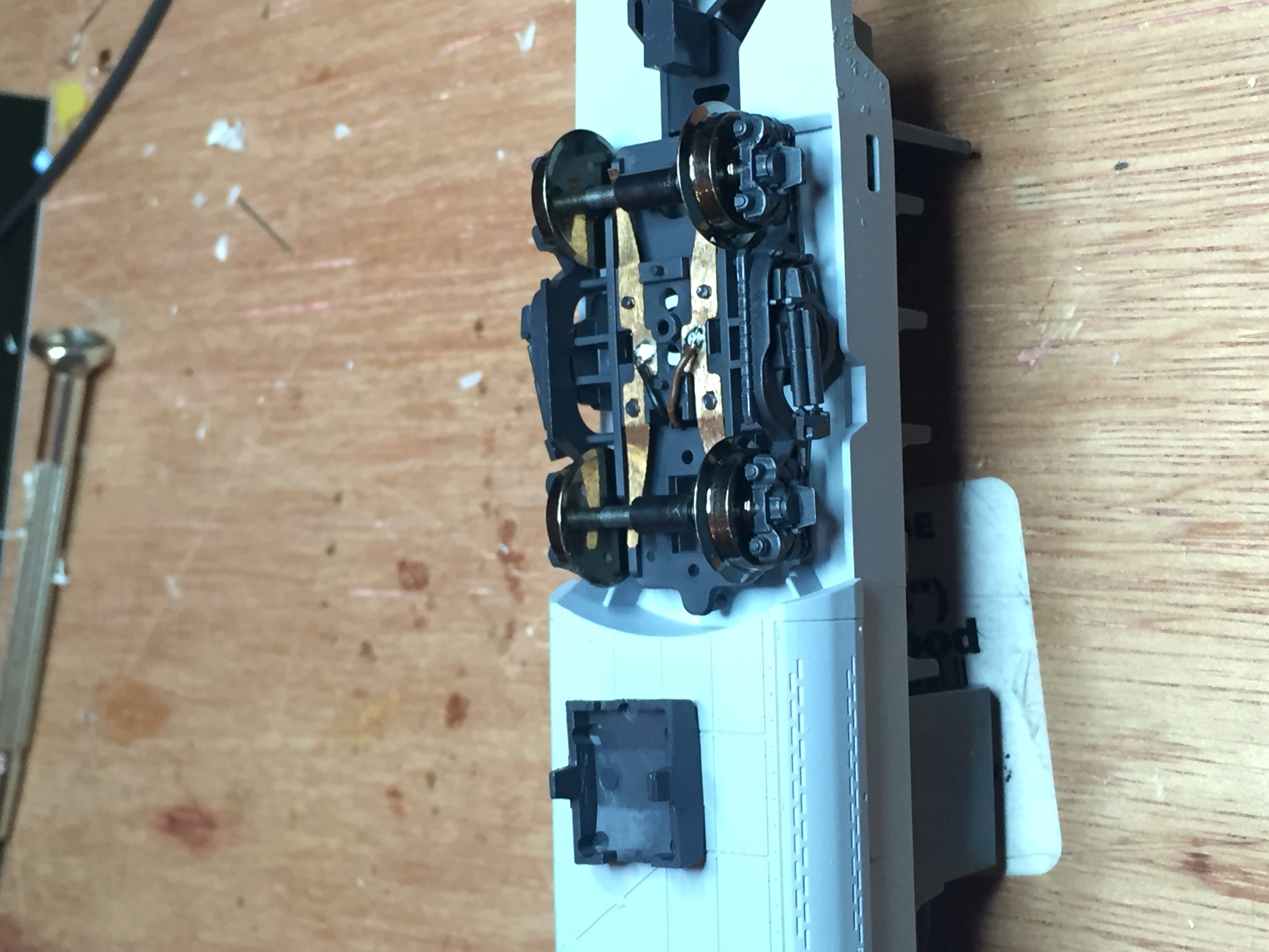

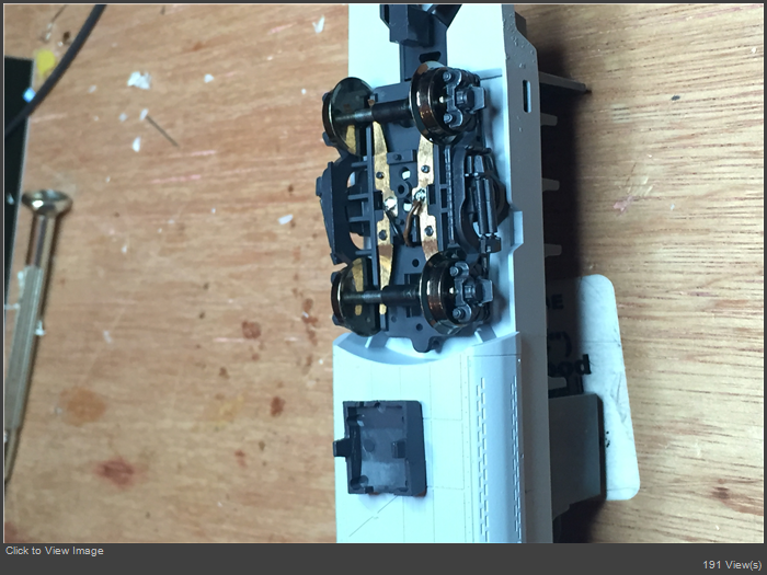

First, remove the body shell by carefully spreading the sides at the frame line. Set the shell aside in a safe place while you work on the frame.
Flip over the frame and remove the center cover on the bogey underneath the cab. It pops out with a little pressure on on side where the wires come out. De-solder the wires to the contact strips (keep the brown wire in place), and remove the brass wheel pickup strips. Fit the Roco slider onto the bogey - you will see the central screw hole and two protruding posts that fit into the slider (makes alignment a breeze!). Screw down the slider and solder the brown pickup wire to the slider.

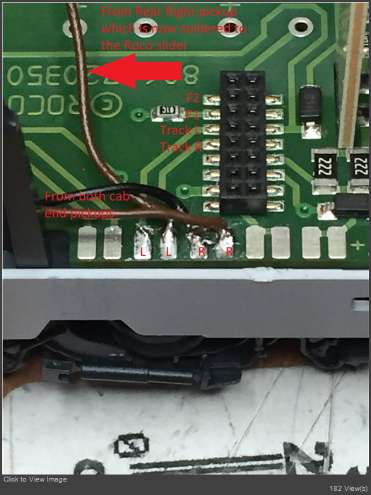

Flip over the frame and let's look at the PCB and soldering pads. We're going to do the following:
  • De-solder the black wire attached to the removed brass contact
  • De-solder the brown wire going to the front truck and solder to the black wire pad you just freed up
  • Use your multimeter to verify the wheel/wire and slider/wire connections are not shorted
  • Note: Fine pointed tweezers and the magnifier REALLY help with this
When in doubt, always refer back to the decoder pinouts. Here is the PluX16 pinout which shows where Track L and R should connect. Note - the connector is inverted in the photo below. If you're wondering, yes, I did cross up my Lefts and Rights here. Normally I wire the slider to track Right. Not a problem since direction can be adjusted in the decoder programming.
At this point, we're almost done! You have both front wheel pickups providing Left track power and the slider providing Right track power. You can check your connections by using the above PluX pinout diagram.

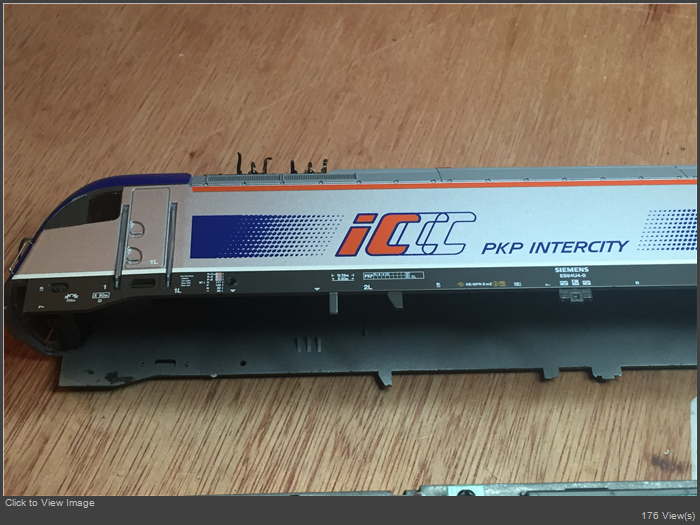

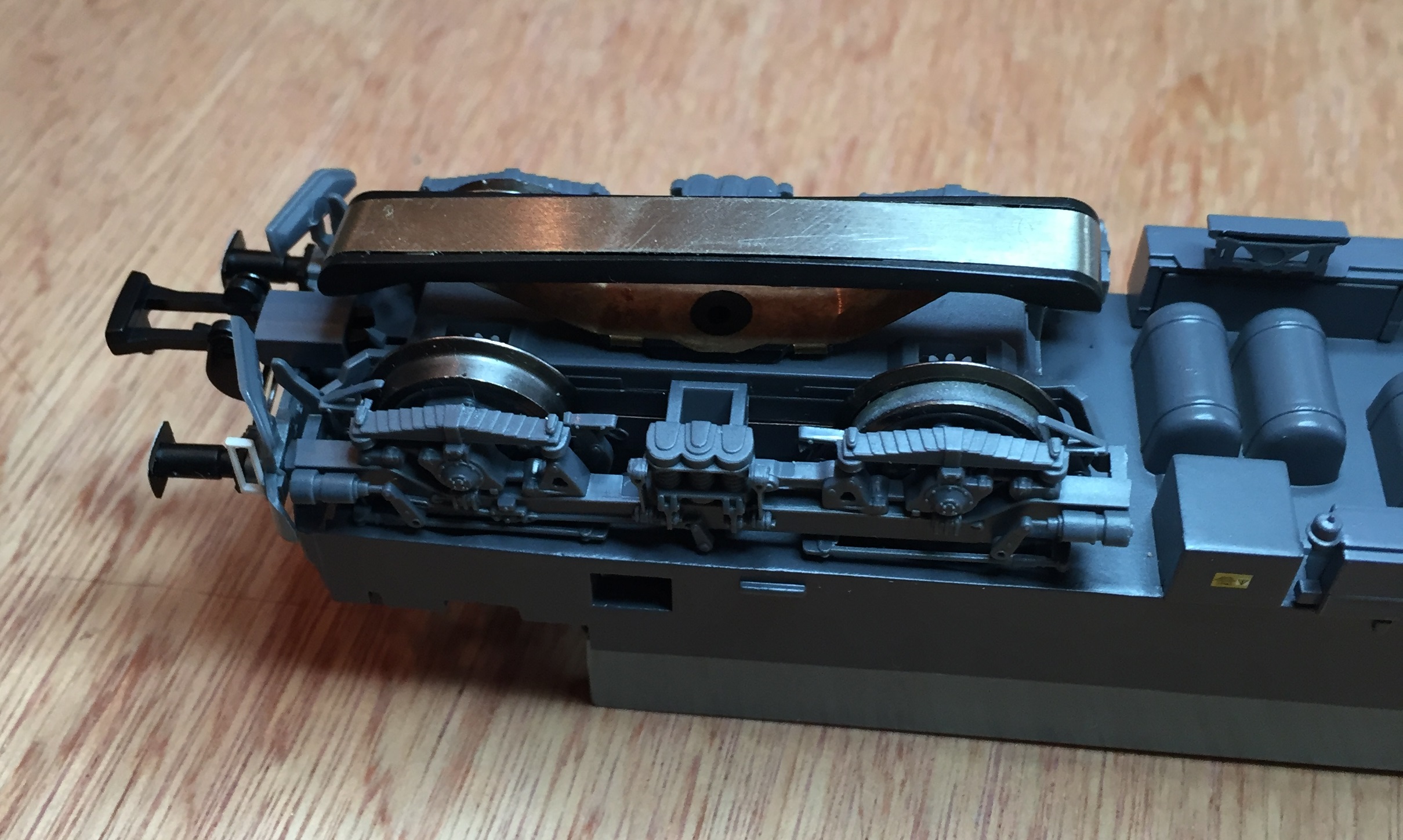

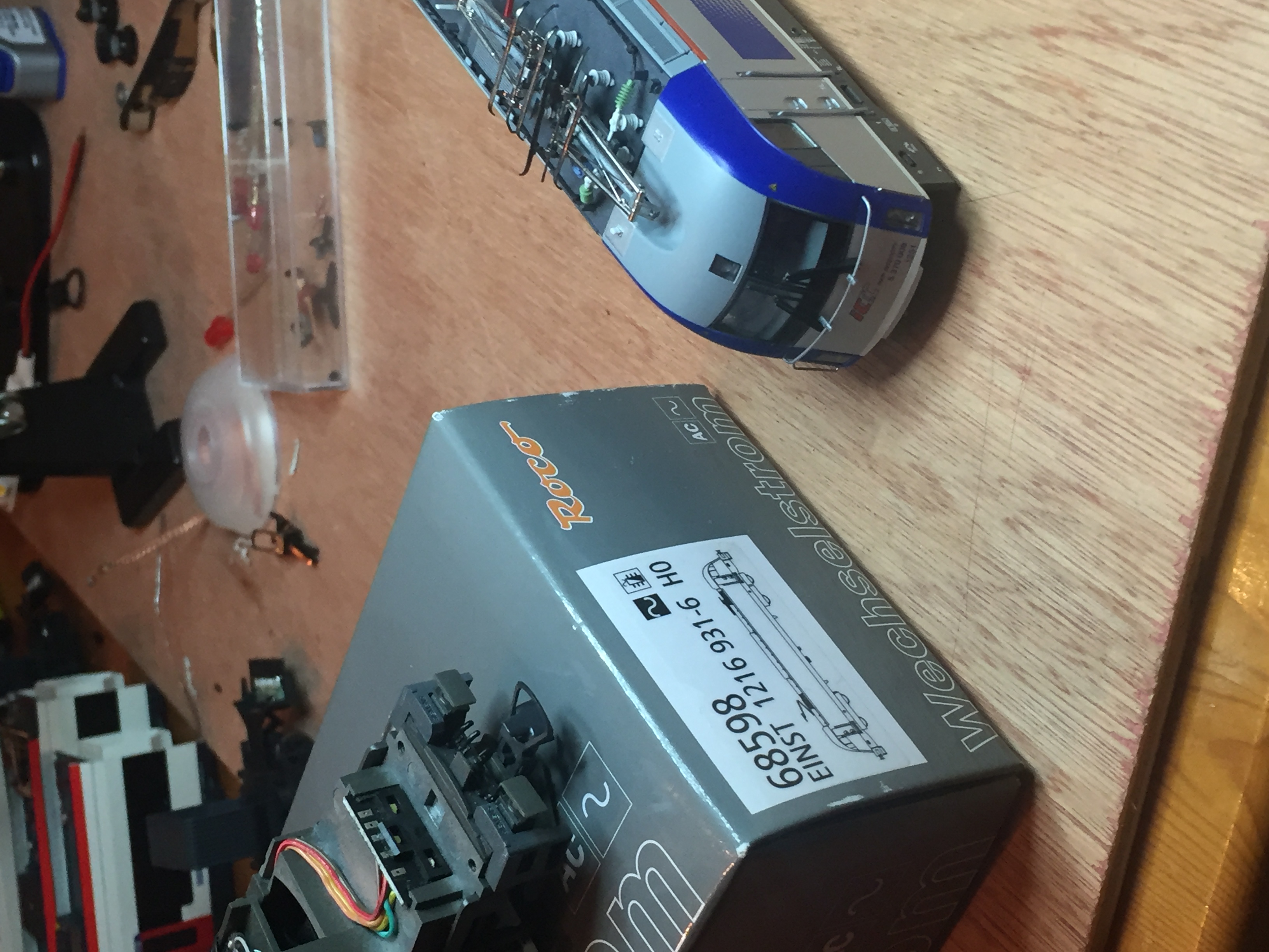

OK - this conversion is a bit of a cheat, but it does get the job done!
I really liked the Acme Berlin-Warszawa Express passenger coaches, so I picked up a set. Naturally, needed a loco to pull the set. Good news: Roco makes a PKP EU44 in the Husarz (Hussar) paint scheme (Roco #62599). Bad news: I can't find the 62599 loco anywhere I look. Good news: my dealers tell me it may get another run, but no promises. Bad news: I look for decals to make one, but no EU44 decals anywhere. Good news: I stumble across someone selling the body shell on ebay (a bit pricey). SOLD!
In looking at the body shell, I noticed that all the fine printing is on the body and not on the frame. I then get the idea to buy a 3 rail Roco Rh 1216 and put my PKP body shell on it.
The PKP shell fit perfectly to the 68598 chassis! I tossed the 68598 shell into the spares bin for future repairs/conversions. I also have two Piko 3 rail Taurus locos that have been stripped and ready for paint - I may try my hand at one of the PKP football schemes.
All that is left is to install the LokSound decoder and speaker.
Cheater? Maybe, but I now have one smooth running 3 rail modern PKP EU44 to pull my BWE cars. I may repeat this conversion with the new Roco 73492 loco since it will also only be issued in 2 rail. I've also ordered the AC gear box plate and slider to see if I can use those for a less expensive conversion.

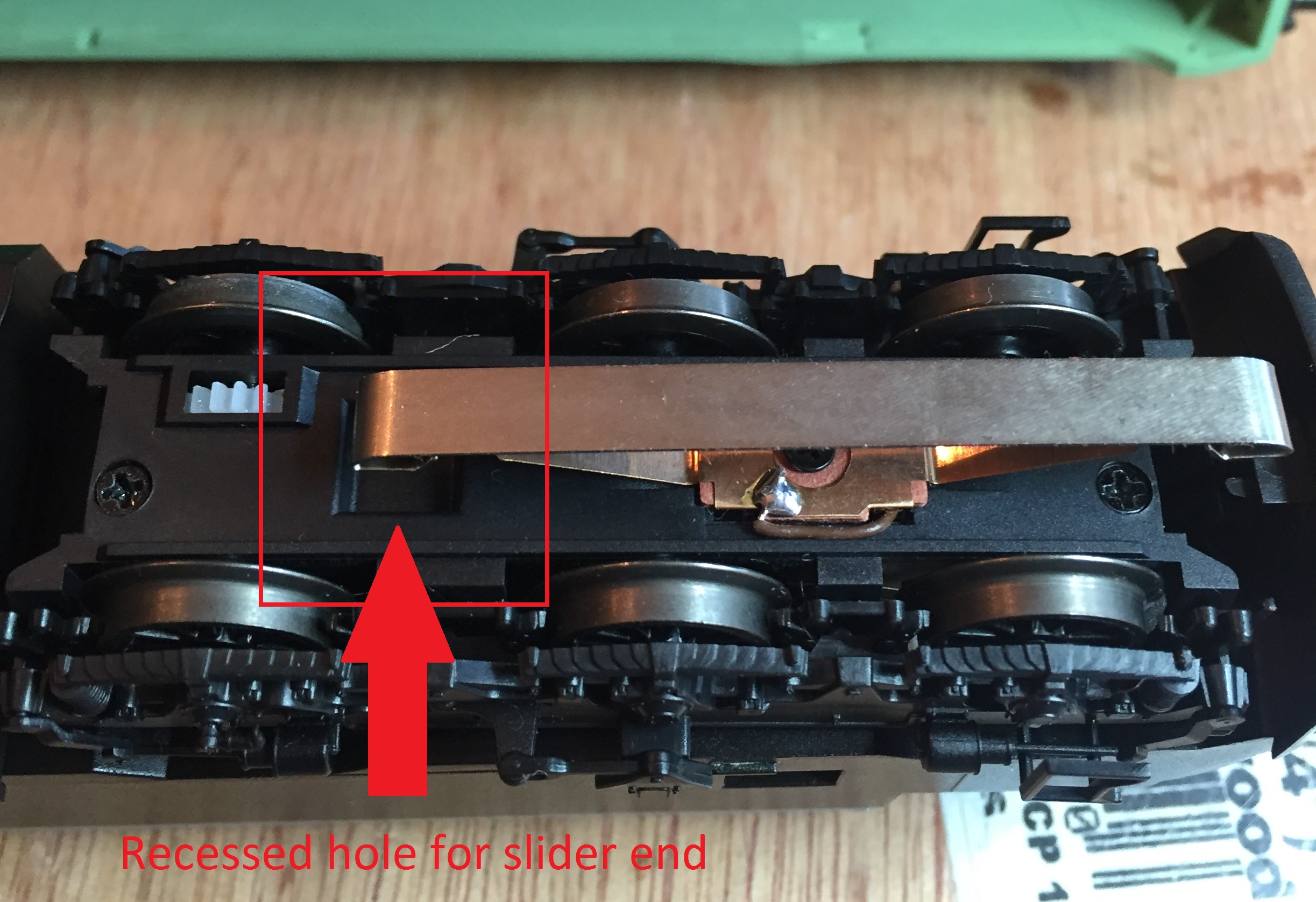

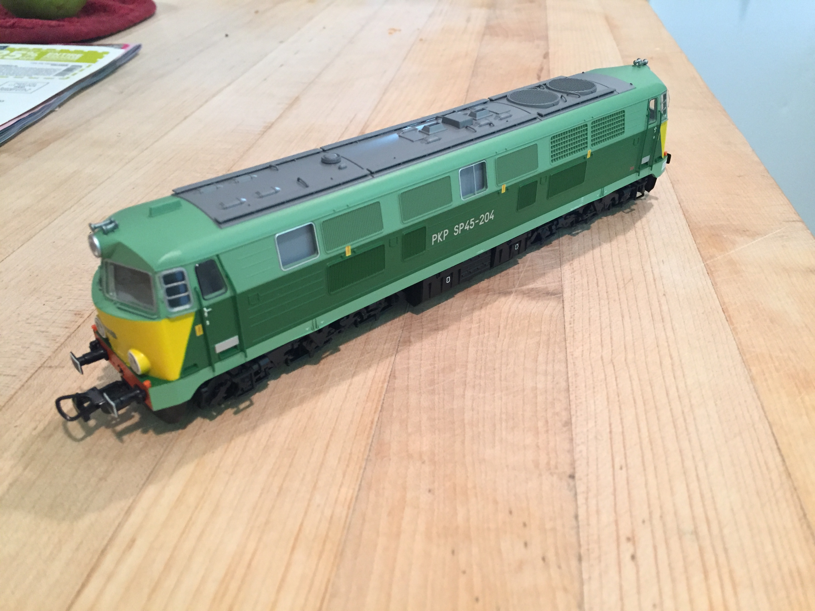

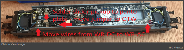

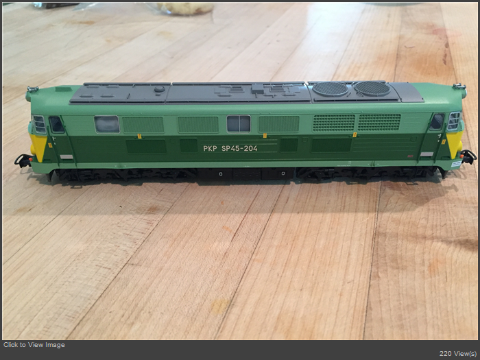

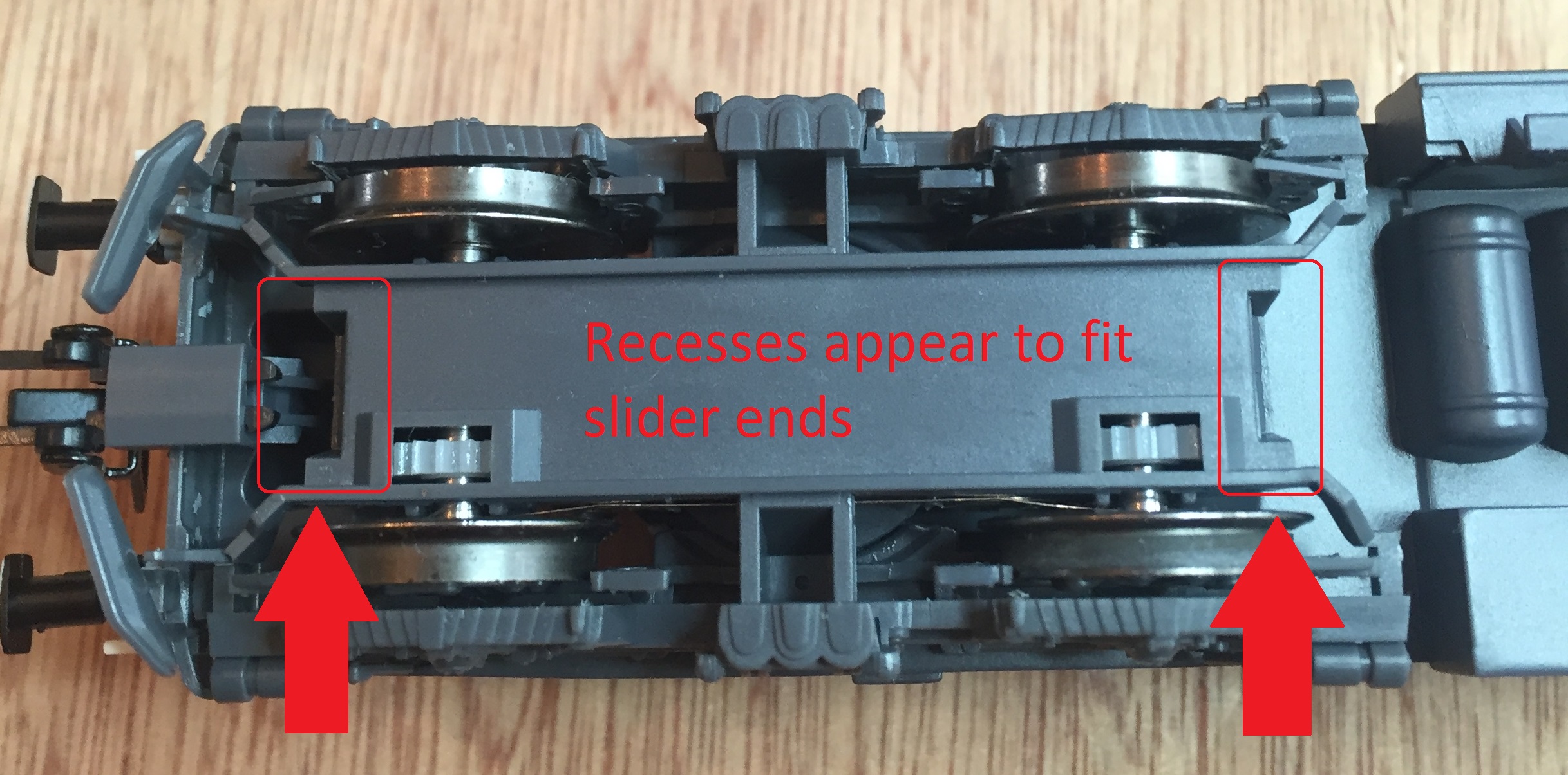

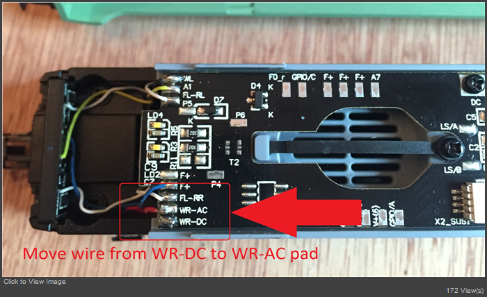

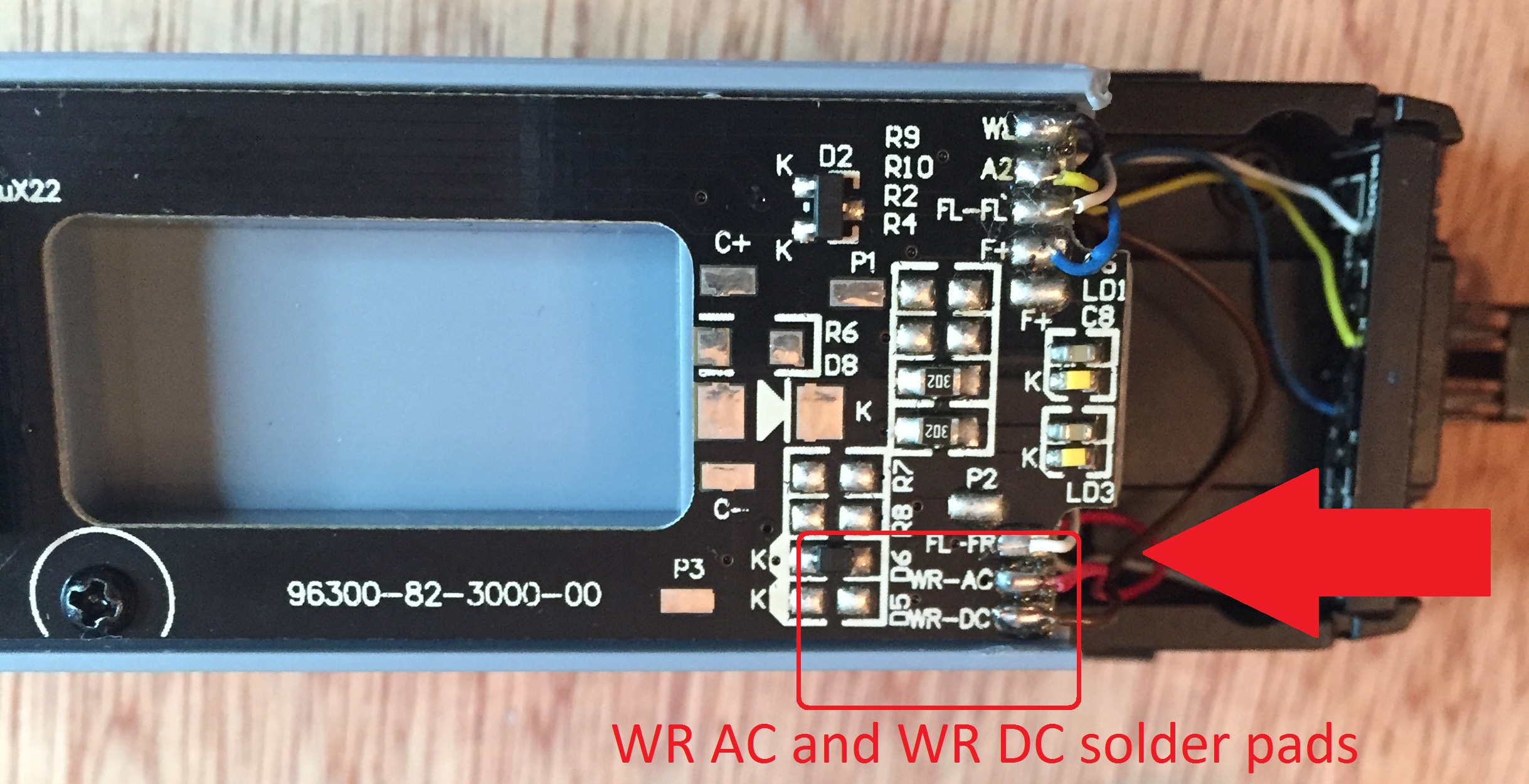

The Piko 96300 PKP SP-45 loco looked like a perfect fit for my dad's home layout. He's been wanting a colorful diesel loco to go with his other rolling stock (Class 03 and 216 from a starter set and a Class 212).
Conversion of this loco was very interesting since it has several features which indicate the loco and/or parts are intended for both AC and DC versions.
Remove the body shell and set aside. Flip the loco over and note which bogey has a recess for the end of a slider. I did a test fit then used CA to install a Brawa 2225 slider. I fished the slider wire up through holes in the bogey and frame to the edge of the PCB.
Next I moved the right wheel wire connections from the WR-DC to WR-AC pads. The multimeter showed that the WR-AC pads were connected to the WL pads. Perfect!
I then connected the slider wire to the WR-DC pad on the matching end of the PCB. I installed a decoder, and the loco was running perfectly!
I did see that there was a selector screw and DC and AC pads, but the loco worked (in digital operation) with the screw in either position. I didn't take time to track down what the selector did, but I'm guessing there is analog AC circuitry on the board.
I'm currently waiting on the Piko sound decoder with speaker. This is a great looking (and hopefully great sounding) loco.

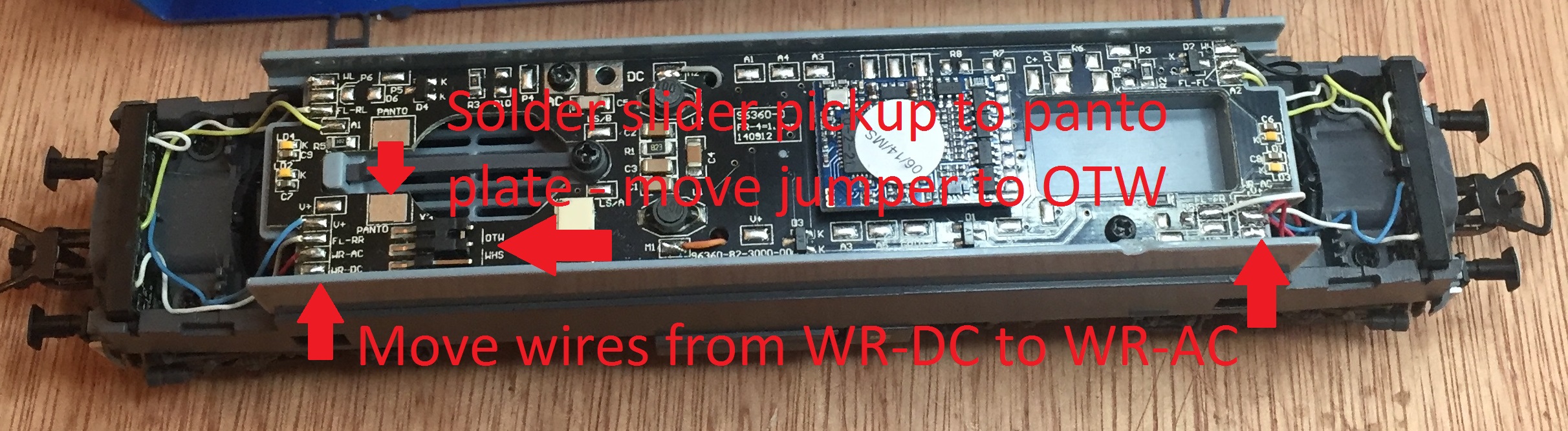

Here's a quick update on several of my remaining conversions:

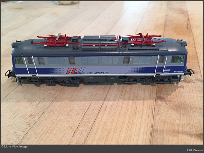

Jouef X72500 railcars - this is a two piece set which is connected by a 6 pin electrical connector. I didn't see any electrical pickups on the wheelsets on the trailing unit, however the trailing trucks have a lot of room for slider installation. That's a good thing because the driving car trucks have very little clearance under the gearboxes on the trucks. I'll know more about the installation specifics once I open up the units and trace the wiring. More to follow.

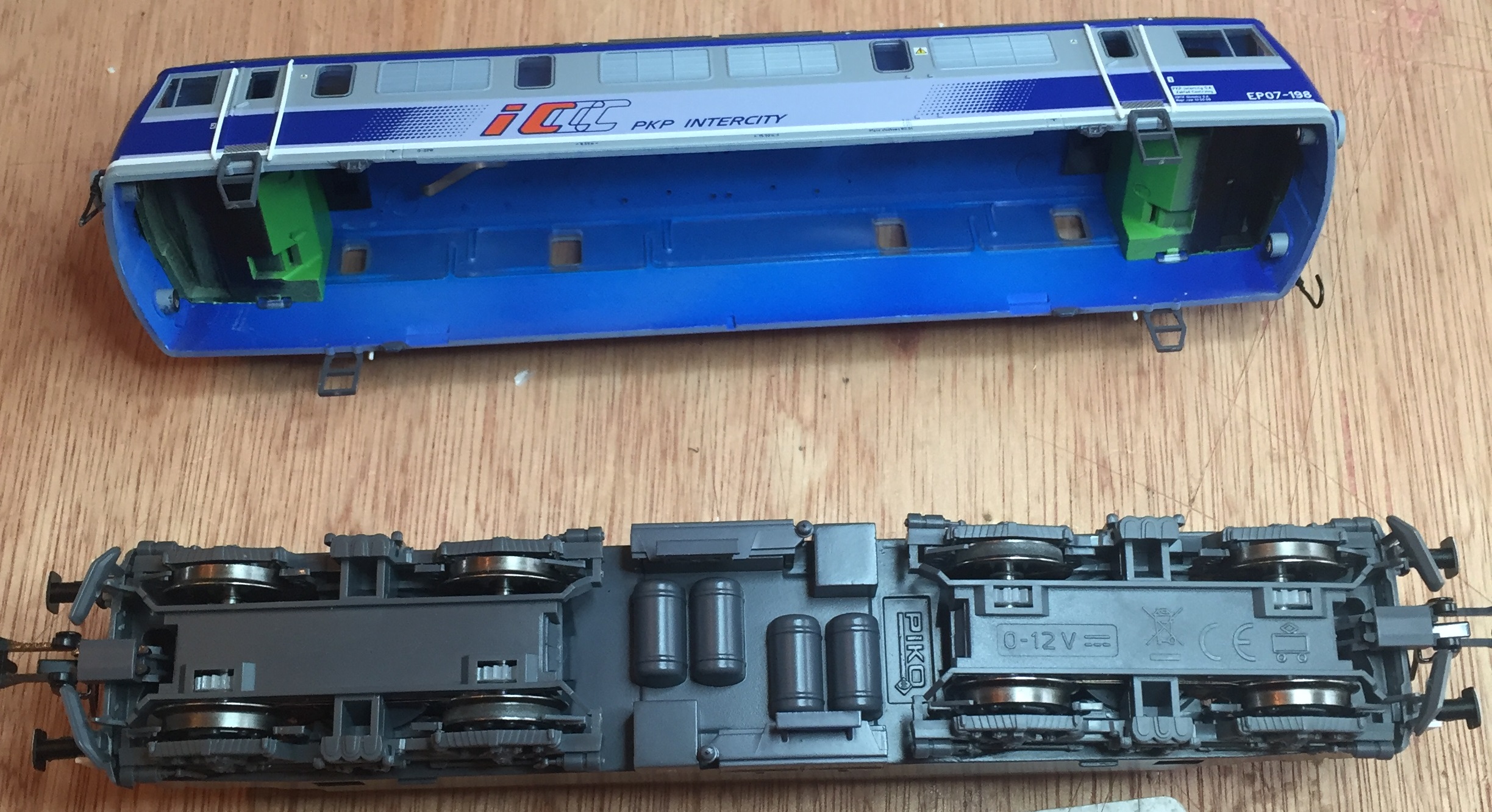

Piko PKP EP07 electric loco - the approach for this loco is similar to the SP45 in that I'll utilize the connection pads on the PCB. THe EP07 has pantographs, so I plan to connect the slider pickup wire to the pantograph connection point on the PCB. This will require moving the pantograph selection jumper. I don't think I'll need to do anything else.
Liliput L33999 SBB FLIRT - I used this as my nightmare scenario in my first post. Looks like I will also be able to leverage the pantograph connections in the FLIRT by connecting the slider to the intermediate truck and connecting the pickup wire to the pantograph bus wire. Again, the pantograph selection switch will need to be set. I was really overthinking this conversion.
Once my pics finish uploading from my phone, I'll get them uploaded to my albums and into the respective conversion page.
Please let me know if you have any questions or see a mistake in my write-up - I'll edit to make sure each one is correct.
Should this say "AC" rather than "DC"?
You make it look so easy, I do envy you. BigGrin
Offline gwolski
#16 Posted : 02 June 2016 15:00:08(UTC)
gwolski
Joined: 17/12/2001(UTC)
Posts: 171
Location: Central Virginia
The WR-DC pad is where the original right wheel pickup was connected. The right wheel pickup is disconnected and moved to the WR-AC pad (which is not connected). WR-AC connects the right hand wheels to the left hand wheels (standard 3 rail pickup for the wheels).
The slider effectively replaces the right wheel pickup - hence, the slider wire gets connected to the original right wheel pad which is WR-DC (on the slider end of the loco). The other WR-DC pad should remain unconnected.
I found it much easier to understand (and implement) when I decided to ditch analog altogether and think in terms of digital - 2 vs 3 rail. Honestly, the hardest part is fitting a slider.

Next up is my Piko 96365 PKP EP07-198 electric locomotive. I really like this loco and have some Acme PKP passenger coaches for it to pull. I've been very pleased with Piko's Expert line locomotives, and this is no exception.
This model was only offered in 2 rail. In fact, the only 3 rail Piko PKP loco I've seen is the EU45-205 (#57860). PKP recently ordered 15 of the Vectron E-locos from Siemens, and Piko does offer the Vectron in 3 rail, but not in PKP. I did contact them and request that they produce it in the new PKP EU46 livery. We'll see what happens. Just found out that Marklin is also offering the Class 193 Vectron e-loco (#36190 and #36193). I'm guessing I won't see it in PKP livery either, but then it's just a paint job conversion!
Back to conversion -> no surprise - the loco does not have any slider mounting provisions. If you look closely at the truck, there does appear to be a slight cutout on each end which will work in my favor for fitting a slider.
After pulling my slider collection out and test fitting, it does appear that this longer Roco slider will fit. The ends fit into the slots mentioned earlier, and there appears to be enough clearance above the protruding gears to be able to mount the slider.
Wiring Changes
Similar to the SP45 conversion, move the WR-DC wires to the WR-AC pads. You could then solder the slider pickup wire to the WR-DC pad. I'm using the Panto plate instead, so the pickup wire goes there, and the jumper is set to OTW. Either method should work well as long as the jumper is set correctly.
UPDATE: runs great on the test track! Next step is to run it through various turnouts to see how the slider performs.
Next up - time to tackle the Liliput L133999 SBB FLIRT set. ThumpUp

I am finding this thread to be really useful thanks. I switched from 2 rail to 3 rail mid 90's and have a reasonable collection of Roco and HAG electric locos that I want to convert.
I am not following the - "move wires from WR-DC to WR-AC bit though. Why not just take a wire from one side (lets say RH hand side) off its pickup and solder it to the slider? I only run digital via Ecos - so can run 3 rail on DCC and given all the locos started out life as DC - why is there a need to touch the PCB end of things? I would really appreciate an understanding of this bit please.
Greg
Greg
Great point - both approaches are equally valid. I chose to document the approach I prefer for a couple of reasons. First, I normally find it much easier to move the wire at the PCB end than to move at the slider or pickup end (can be rather cramped working around the wheels). Second, I feel that attaching the RH side pickup to the LH side pickups gives better contact reliability. Otherwise the RH pickups are unused unless you attach another feed wire.
Whichever method you choose, do yourself a favor and document the conversion. Most conversions, if done neatly, can be easily reversed to restore the loco to it's original condition.
Does this help?
Gene Wolski
#30 Posted : 11 June 2016 17:56:44(UTC)
Posts: 15,434
It's better to use all wheels for ground contact. You need an internal connection of both sides of wheels to make contact tracks work (used in level crossings). And to make the loco work on contact tracks.

Got it thanks. I was going to run another wire between both sides - didn't realise there were points on the PCB that were clear of what is what. (of course there is you think about it!!)
