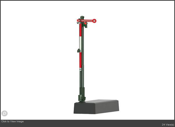

Thanks for the clear explanations Jabez. It seems like 7039 is no longer available from Marklin. Would Viessmann 4530 be a good substitute for 7039? Since it has similar features and wiring arrangement as the 7039. Thanks.

I looked up the Viessmann 4530 and it seems to be the appropriate substitute for the obsolete Marklin 7039.

A footnote on the Viesmann 4530 The Viesmann 4500 does the same job and is a bit less expensive. It is listed as 'discontinued' in the Viesmann catalog but is still available from many dealers. If you find one you can probably save a few bucks.

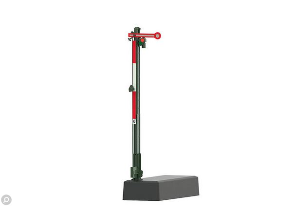

There are plenty of 7039 signals available from the likes of ebay, for about $20 to $25 USD.
The Marklin replacement for the 7039 signal is 70391.
