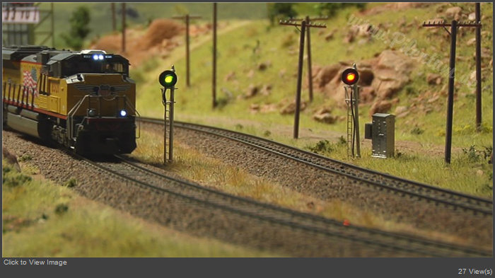

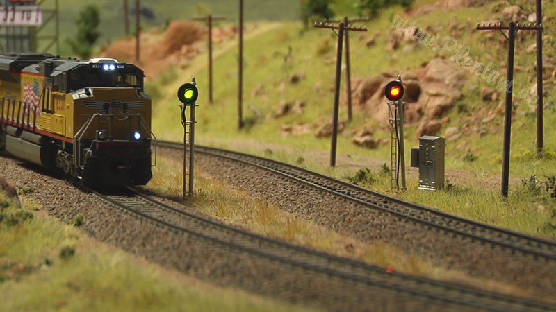

Forum member Baggio once had a compact layout with separate ovals for 2- and 3-rail operation. Forum member 5HorizonsRR is preparing a compact ayout with Maerklin C track on the lower and BEMO narrow gauge on the upper level. And there is a large modular dual-track US-themed layout named "Sherman Hill" on public display in Germany with one track for 2- and the other for 3-rail operations - see image.

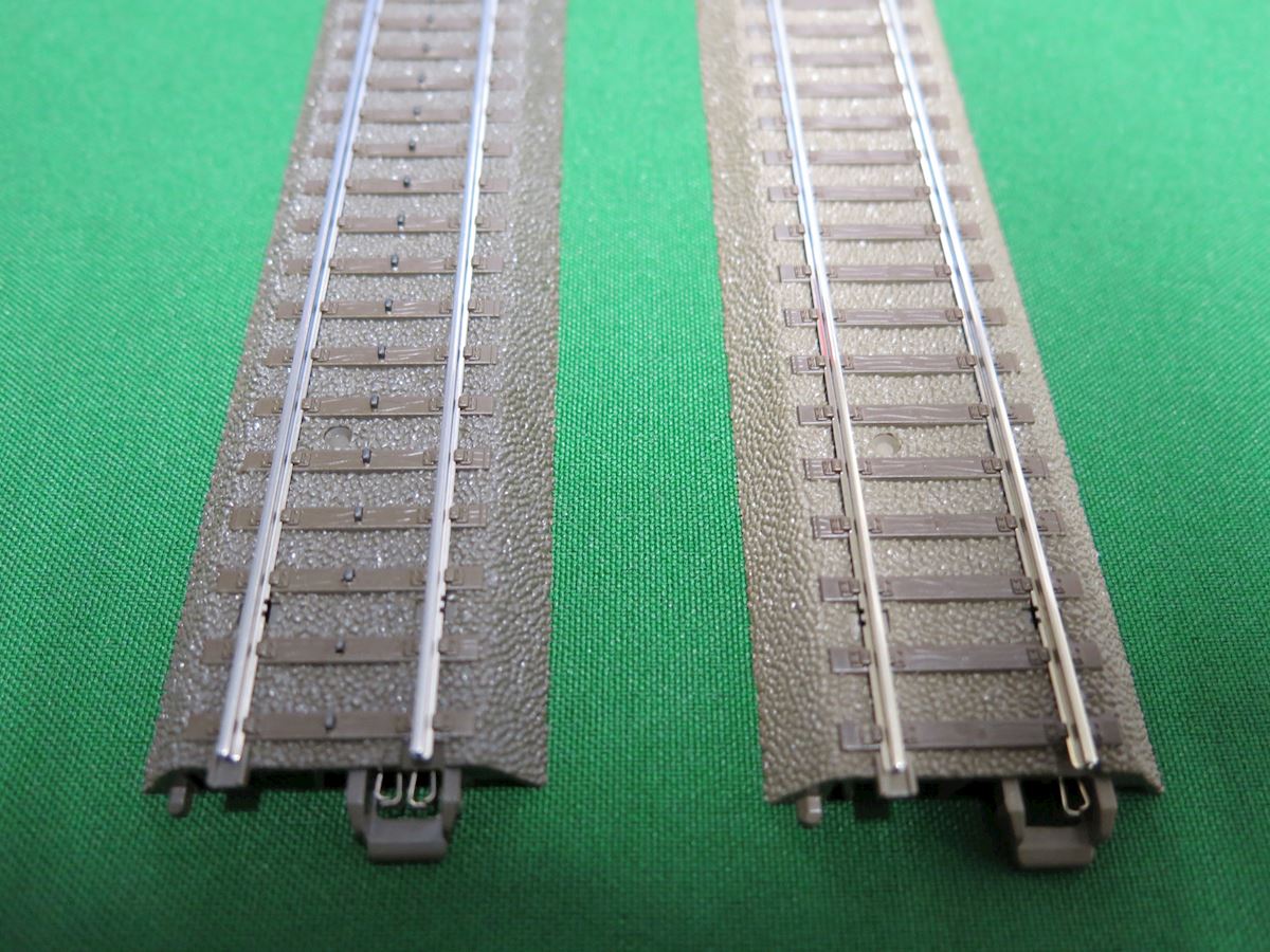

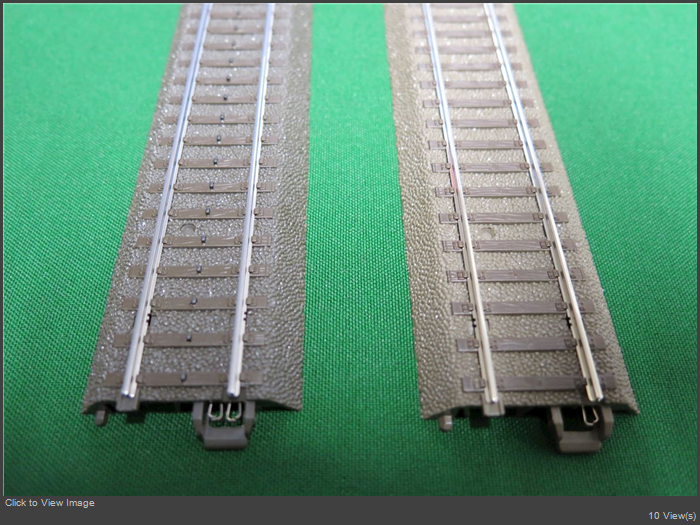

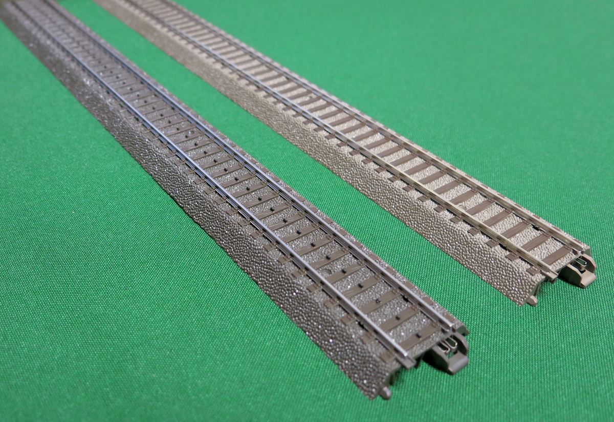

I was using HO Kato Unitrack for my DC/DCC trains and when I got a Marklin set with the C track - I found it to be better in many ways so decided to get the Trix C track as I thought it would be identical except for the center studs and rail code. But to my surprise it's also different in color as it's a much lighter brown and I actually really like the dark brown of the Marklin C track. Even the rail color is different. I know it's just aesthetics's and I'm really more into the durability of the track themselves so the color is not a deal breaker. The C track is perfect for the type model railroading that I do - temporary setups.

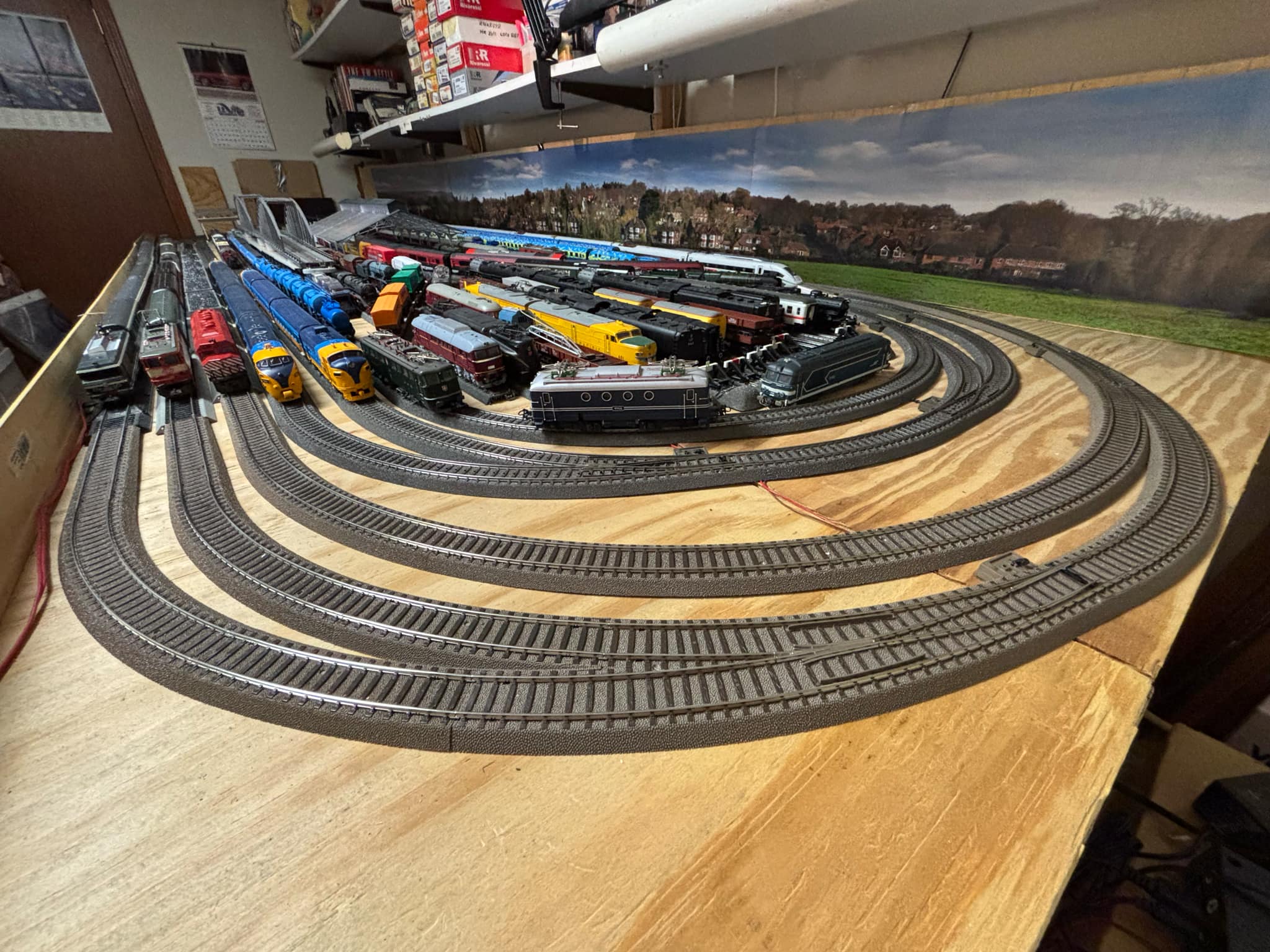

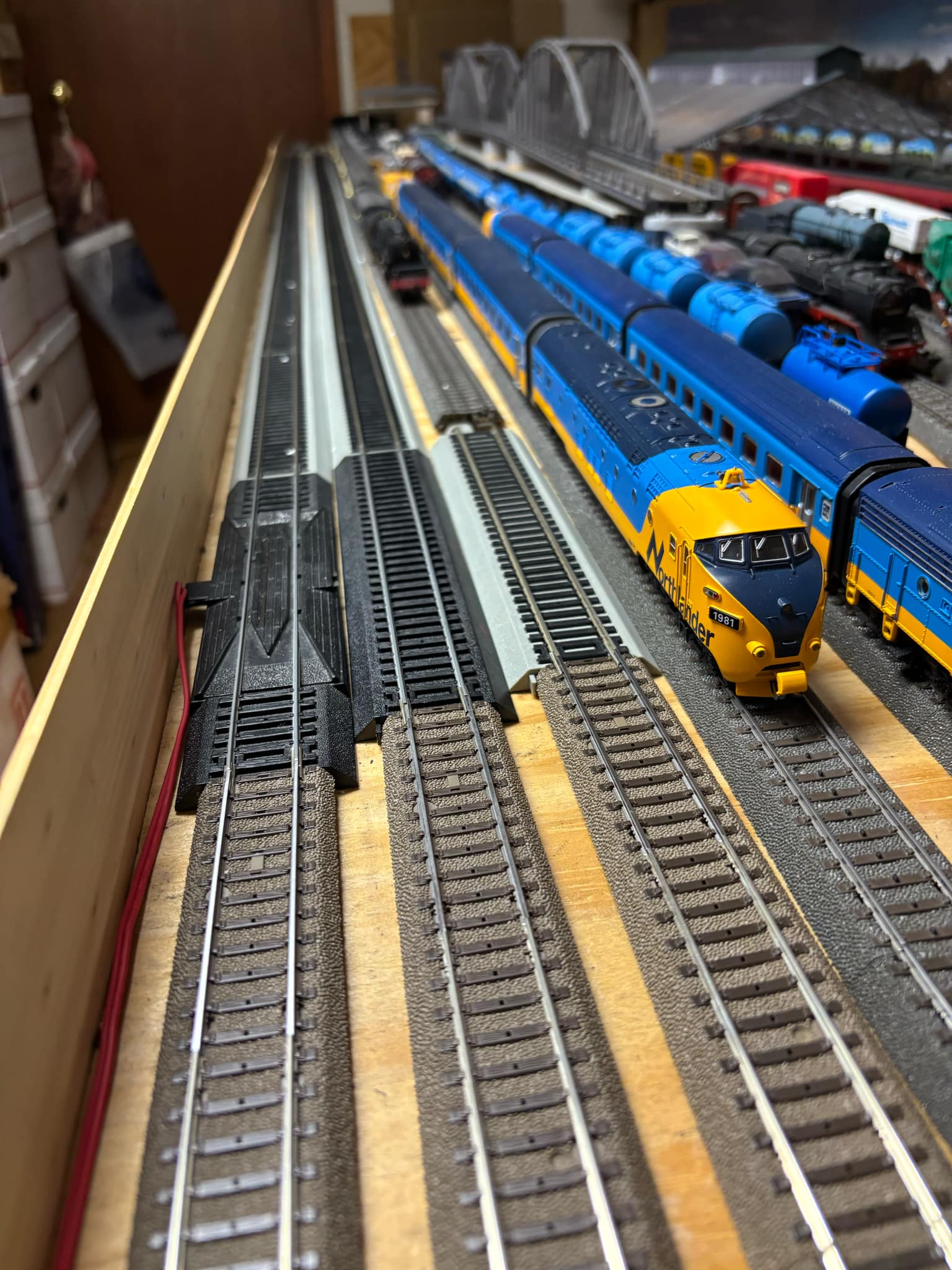

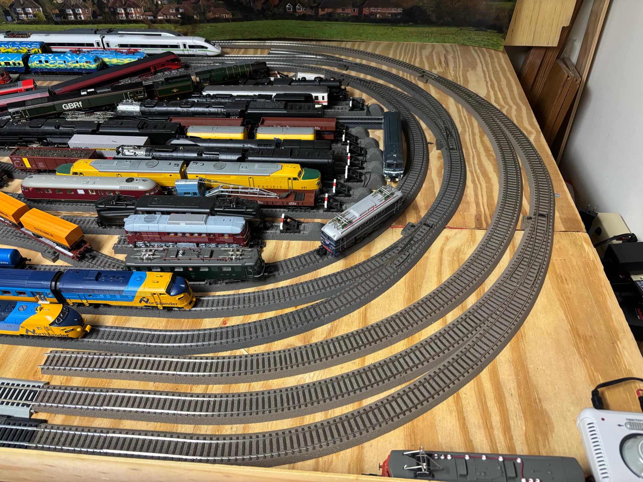

I've been playing around with this concept for a while and designed a few layouts with SCARM that would fit onto my 4 x 1.17 m table (most of them are either 2 or 3 levels and/or diagonal stations with separate tracks). For the time being, I have an outside DC oval with 3 Trix C-Track (turnouts & curves)/Bachmann EZ-Track (straights) sidings and the inside ovals and yard are all Marklin C-track I can run both analog and digital. If interested, please check out my videos on my YouTube channel at: Tom's Maerklin Train Layout
Here are also a few pictures:
