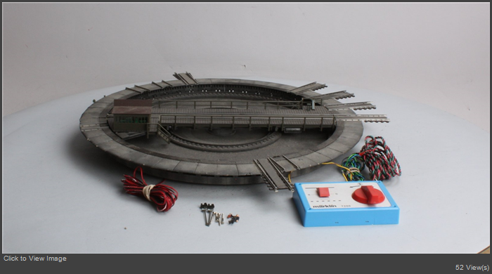

I was lucky enough to find a new marklin turntable 7286 stuck in the back of a shop.
What do I need to make it work with my CS2, from reading
on this group I think I will need :-
Turntable 7286
Retrofit kit 7687
ext kit 3 spoke 7287
K to C track conversions 24922
I have read all the instructions about putting it all together, including the set up on the CS2 (a bit bazaar). How do i actually control it from the
CS2, is there a specific screen ? is it part of the layout screen ?Confused
If people could take a look and add explanations and if need be items to my shopping list I would be most grateful
