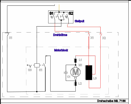

I have found the connection needed:

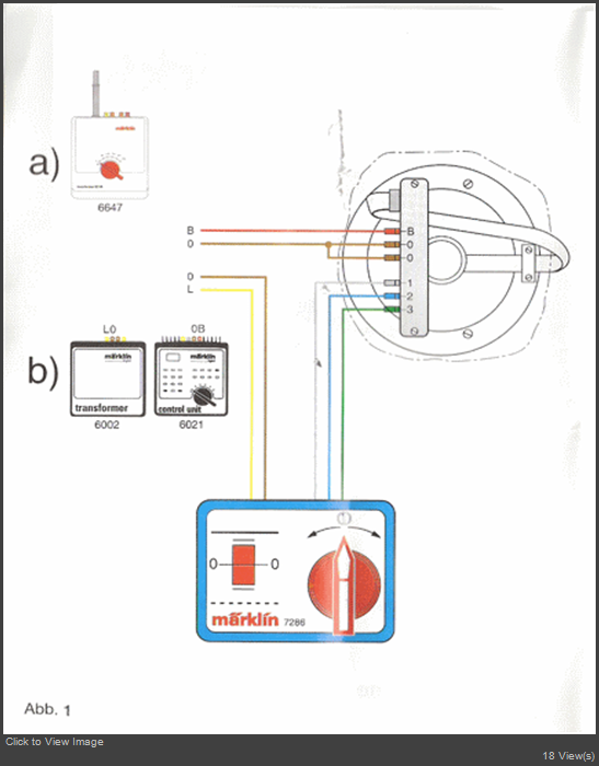

On the old TT: see the attachment 1 (thanks to www.railroad24.de, 23er Manni)Connection 7186.png

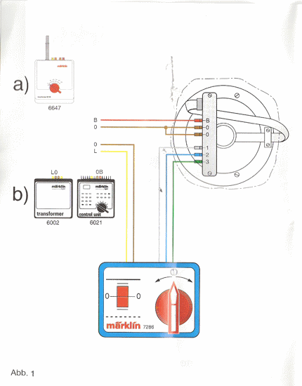

On the new TT: see attachment 2 (thanks to www.railroad24.de , Peter1956)
Connection 7286.png Points 2 and 3 to the Delta decoder motor outputs and the 1 to drive the unlatch solenoid.
A Diode may be needed to install in series with each of the motor outputs of the Delta decoder
I hope this helps (personally I have used a DS2010 decoder to drive the 7286 TT)
Again thanks to the authors of posts from which the schémas are coming from.
