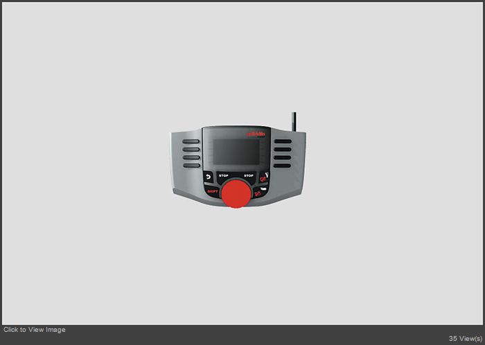

My statement was in reference to the previous statement made by Danlake: "Having a big button for emergency stop is really handy if you have kids!"
Clearly, Danlake was referring to the big RED button(s) on his controller.
What I said is that while the MS2 does have a big red button, it does NOT cut off the power to the track and does NOT stop the trains. The red button reverses the direction of the train only and if you use it as a panic button you run the risk of breaking the loco since you are reversing the loco while it is travelling, perhaps at a good speed.
On the MS2, to stop the train you need to find the BLACK little STOP buttons around the BIG red button. Cursing
I believe that the original intention of the designers of the MS2 was to use the red button as a STOP button but then changed their minds for whatever reason.
Here is a picture of the MS2:

I think the emergency stop button is very valuable. On numerous occasions I have let friends and kids run the trains without me necessarily being in the room all the time. All I have to tell them is that if something goes wrong or you hear strange noises (derailments) just press the big buttonBigGrin

The ECoS has a STOP button and a GO button, the CS2/3/MS2 have a button that toggles between STOP and GO.
With more than one person driving trains it is good to have a STOP button, not a toggle button.
Pressing the STOP button while a long fast train is on a curve can easily lead to derailments (cars flipping over). The STOP button should be the last resort in case of emergency.
I prefer the small dedicated STOP button of the ECoS over the bigger toggle button.

To me, a BIG RED button signals STOP. This means that in an emergency that is where I am naturally reaching for, both because of the size of the button and the colour.
The description of the MS2 says "A red lighted Stop button is included on the Mobile Station." This is misleading at a minimum.
Yes, the little stop button turns red when the power is out but otherwise is is not red, it's black. The red button is not the "stop" button.
I have often thought of finding a switch with big red button that actually stops the trains. If I find it, I will buy it in a flash.
Hi, I wouldn't have chipped in if I had realized that it was just the size and shape of the stop button that was in question, I thought you were implying that there was no stop button at all.Blushing
Is it correct that using the red reverse button when the loco is in motion may damage the loco?
I find it handy to bring the loco to an immediate stop while shunting thus letting the uncoupled wagon sail away on its own. The loco is only traveling at very low speed in this case.
I have no absolute technical info on point, but it stands to reason that if the loco is travelling in one direction and you suddenly make it go the other way, it cannot be good for the loco.
The slower the speed at that point the less the potential damage; even so, if you keep on doing it, eventually the loco may get damaged. Besides, it takes very little effort to bring it to a stop before you reverse the loco if it is already going slowly.
My usual 2 cents' worth. BigGrin

The initial "big button for emergency stops" comment was for the CS3 where that button is the black bar button at the bottom edge.
A button that reverses loco direction at speed without first doing a braking maneuver to stop then accelerate, would is be a bad implementation.

When the red reverse button is pressed on the MS2 the loco just stops. It does not shoot off in the other direction. You have to turn that control button again to start it moving in the new reverse direction, no doubt after a short interval and just as slowly as you want. Since there is no sudden change of direction, only a sudden stop, I can't see how that would be harmful. But what do I know.

When the red reverse button is pressed on the MS2 the loco just stops.It does not shoot off in the other direction.You have to turn that control button again to start it moving in the new reverse direction, no doubt after a short interval and just as slowly as you want.Since there is no sudden change of direction, only a sudden stop, I can't see how that would be harmful.But what do I know.
You are absolutely right, Jabez! ThumpUp
After reading your post, I went to my layout and tested the MS2. Sure enough, the big red button stopped the loco cold and the reverse lights went on, but the loco did not move one mm.
The dramatic effect of the loco stopping cold was more obvious in one loco than another, but neither moved at all backward or forward.
It is odd that the manuals of both the Trix and the black MS2 do NOT refer to the red button as a "stop" button but instead as the "Locomotive control knob Reversing direction".
In addition, when two locos were running ONLY the loco that was being controlled by the MS2 at the time stopped when the red button was pressed, the other continued on its merry way. Clearly then, the power to the layout was not cut out.
So, thank you, Jabez, for pointing this out to us; good to know. BigGrin
(As an aside, it is still questionable whether stopping the loco cold with the red button does/not damage the loco. This is much like slamming on the breaks when you drive your car, not a great way to drive for the car (to say nothing of the passengers). Other than in a panic stop for THAT LOCO ONLY, I still think it is better to gradually have the loco stop by turning the knob down all the way.)
The braking distance is shorter when you press the reversing button than when you press the STOP button - at least if the loco has load regulation.
Therefore I assume the decoder applies power to the motor when you reverse to stop it faster.
Is it harmful? I don't know. I don't wanna try it too often.
And typically the loco will just stop, but the exact behaviour depends on the controller and on the decoder. Sometimes the loco will reverse and go off in the other direction with the same speed.
